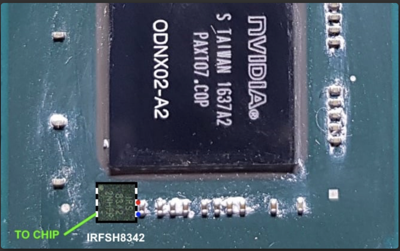

* What pin/pins can I disconnect to use the switch lite in the meantime while I wait for a few more supplies?
My girl is complaining about her animal crossing town :D. Trying to solder these tiny Mosfet's while trying to hold them with tweezers is killing me. I have everything wired but getting CPU error.
* Will this Mosfet (IRF8714TRPBF) work as a replacement? Someone mentioned a similar one.
I have a great soldering station but my flux and solder aren't working for this application.
* What are recommendations for those?
Currently, using Sn60/Pb40 Solder and MG Chemicals 8361 No Clean Flux
Thanks

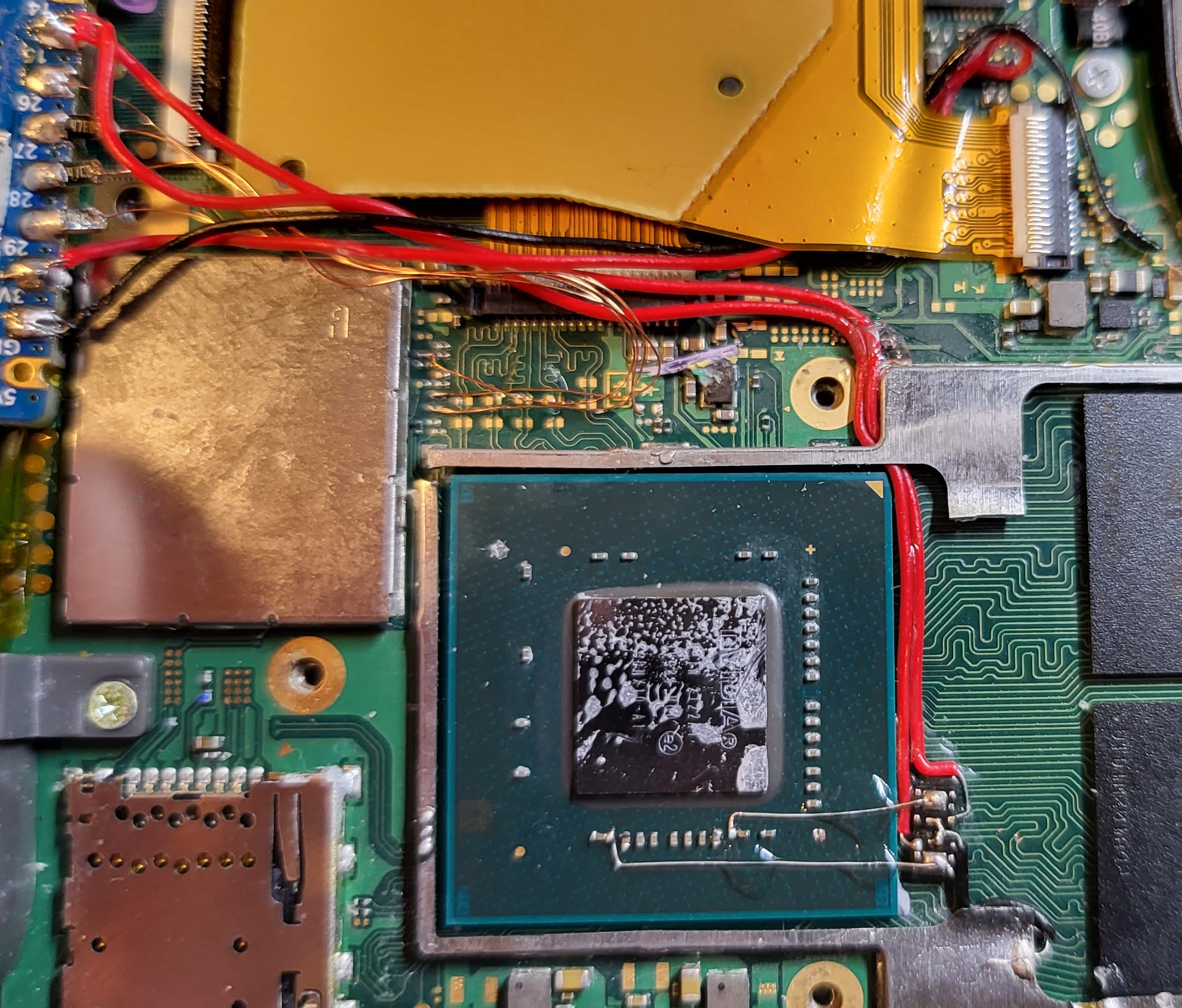

Thank you all, I finally got it working. I had UV resin delivered with better solder today. I could not get this Switch Lite to work with one Mosfet. Furthermore, I added a second and finally no CPU error. I actually removed all my old wires and redid connections with coil wire. Thanks again for all the help.
Which mosfet you installed last, suppose its the right side. Wonder if you can try to remove the left side and see if it still work. Because in my Lite only one mosfet on the left is enough, although the mosfet (source&drain) is like 1/2 cm below the capacitor.
Whether the issue is about source/drain distance or about two signal from multiple mosfets is needed, or it just every console is specific and we dont know what the variable here.
The left/Bottom was the first one I had hooked up. I tried that one to both caps and still didn't work. Literally in the last 3–4 days I tried everything including left side of cap like pic in OP, but this lite would not boot with one.

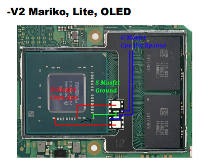

First of congrats. Question though, how come you opted to ground your source away from the APU ground point? And second, am I correct in saying, you have to combine the MOSFETs together by solder bridging them together at the source points!? (It was my only source of confusion with doubling up MOSFETs and would be a big help to clarify this for me.)
Reactions: Type_O_Dev
You can ground them wherever you want but closer to APU is better (shorter wires, less interference and all)
Also you can combine the mosfets in all points source-to-source, drain-to-drain and gate-to-gate, its just that this setup (as seen in photo) is better from the logistics part because using only one wire to connects both drain terminals and both capacitors would be a real challange. So you bridge source (it also keeps mosfets together) then run separate wires drain-to-cap.
Right. Then run a single wire from, the now bridged sources, to the ground point. And two wires from the gate points to CPU (at the pico). Got it.
