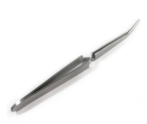

Try a cross tweezers.
I use this an it hold the mosfet verry good in place:
https://aliexpress.com/item/32853592300.html
How are you holding them while soldering and iron. I tried tinning fet but smaller pad/pin is being a problem. This is why I'm thinking flux might be an issue.
