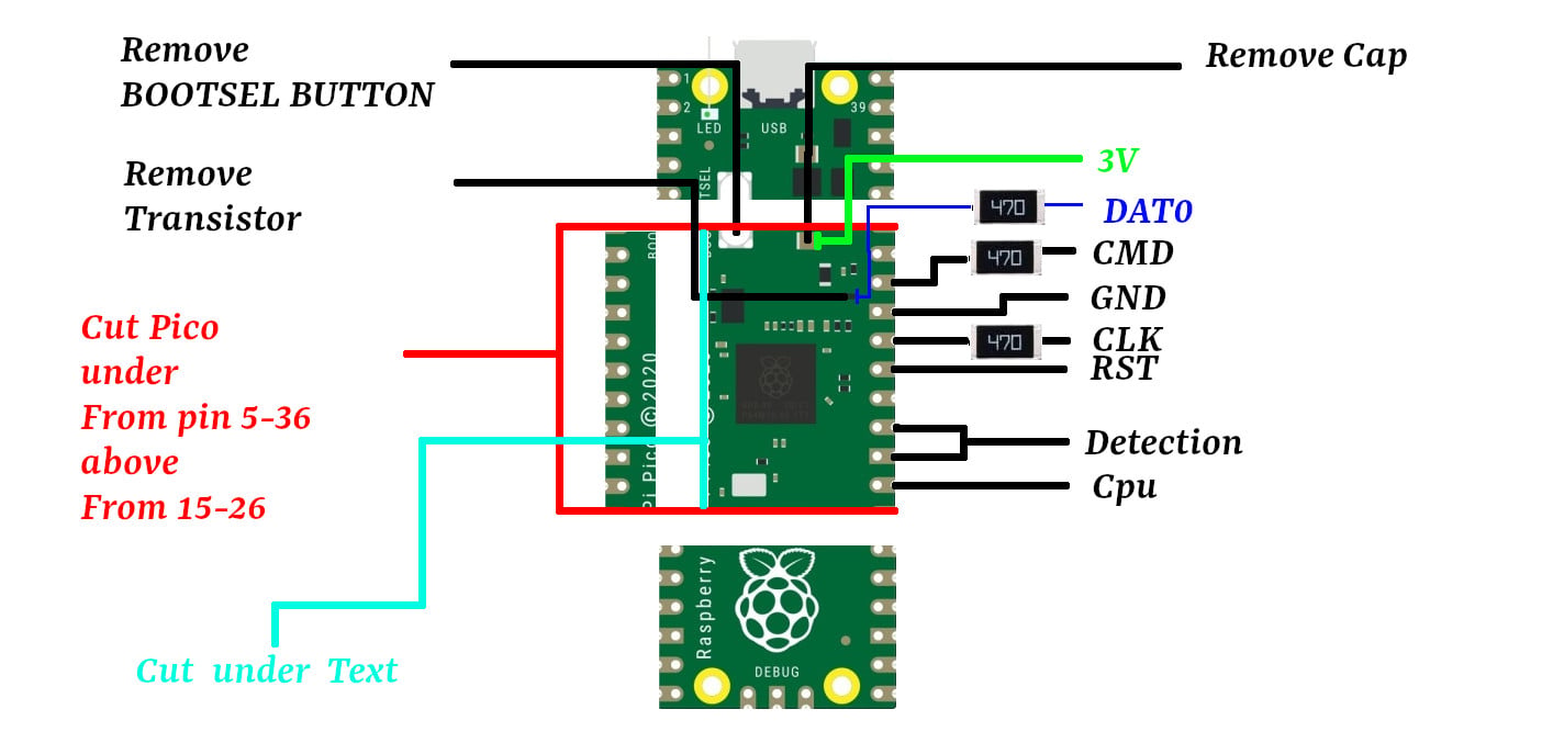

Thanks, another question. In the pi pico when I remove the transistor I need to replace with de 47 ohmz resistor or bridge the resistor points with only one side of the 47 ohmz resistor?
The 5v to 3.3v regulator on Pico RP2040 does not need to be replaced or bridged with a resistor. The motherboard itself feeds it with the necessary voltage, however, can anyone to tell us if its removal is mandatory? I did not remove this regulator.

In the guide says you need to remove a transistor and put the DAT0 cable there, The blue letters

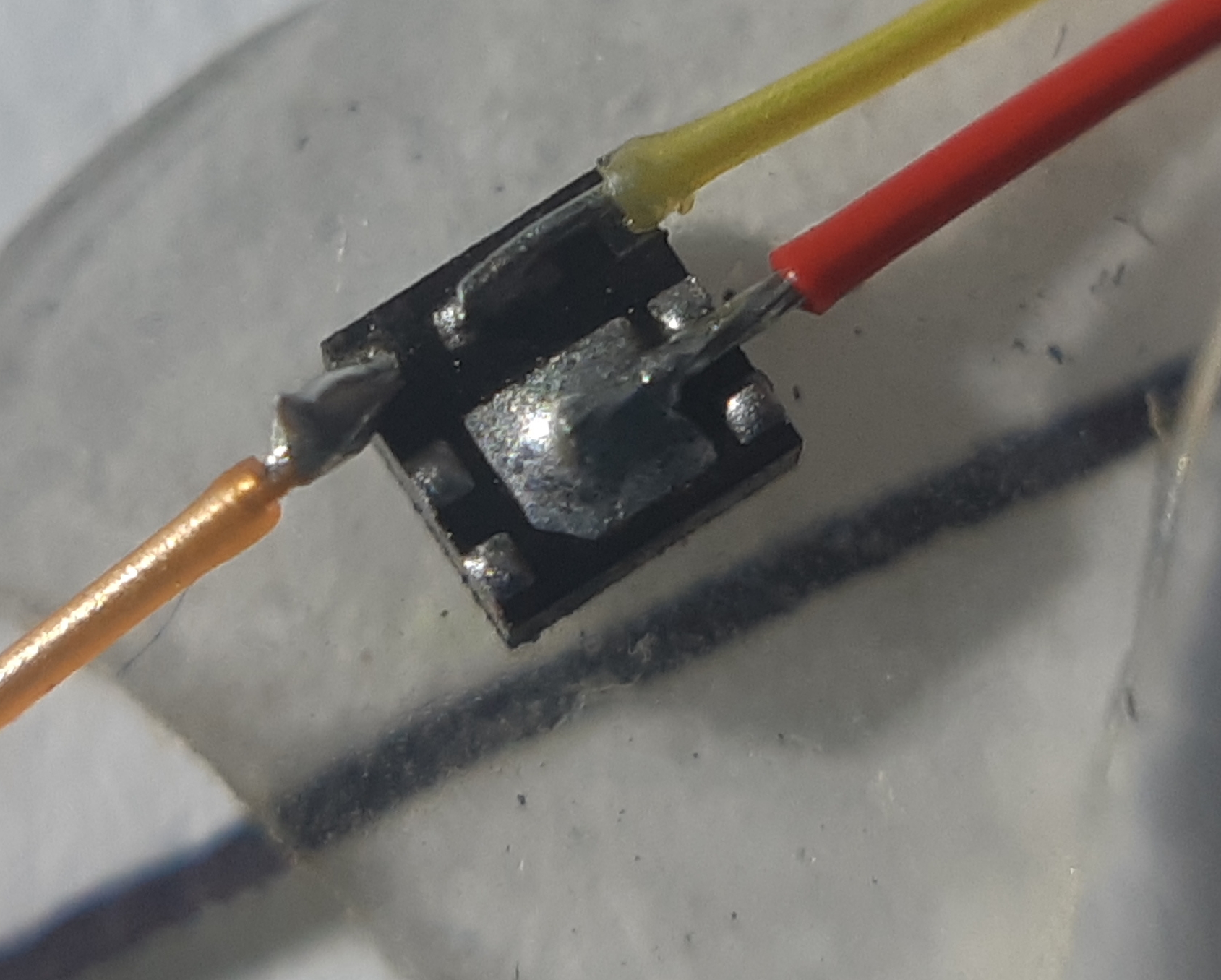

Hi.. done on the first try.. huihh, it took almost 6 hours. Using one mosfet fdmc7672 and pi pico.
i solder the mosfet on the heatsink ground.
Great job.
Just make sure that the heatpad on the shield gets good contact with apu (because of the mosfet placement) otherwise you might have problems in the future.
