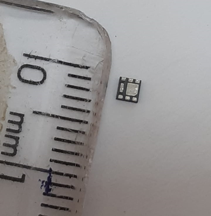

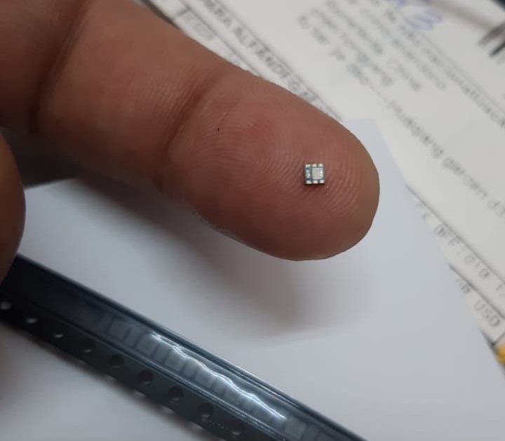

Hi everyone.
The MOSFET I got are microscopes, does it look bigger in the picture I saw, or did I buy it wrong?

Hi everyone.
Yep, those are the ones. They do seem bigger in pictures though.
If you find it difficult to solder you can try some bigger ones, SOP8 casing like IRF8714, IRFH3707, IRF8736 (confirmed working) or give it a shot with AON7506, AON7518 (not confirmed yet but the specs are similar).
They have legs on the outside so it makes everything easier.

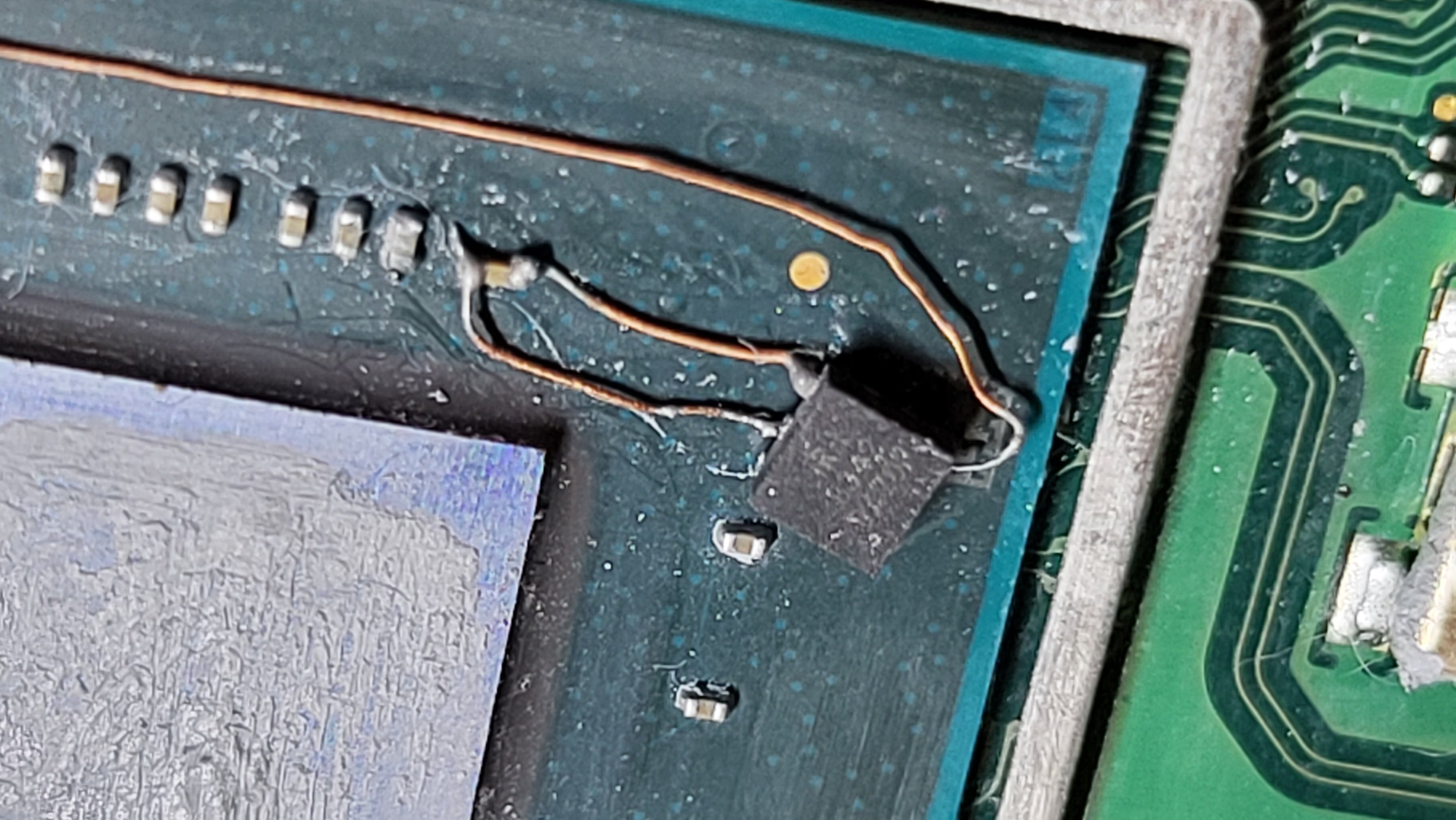

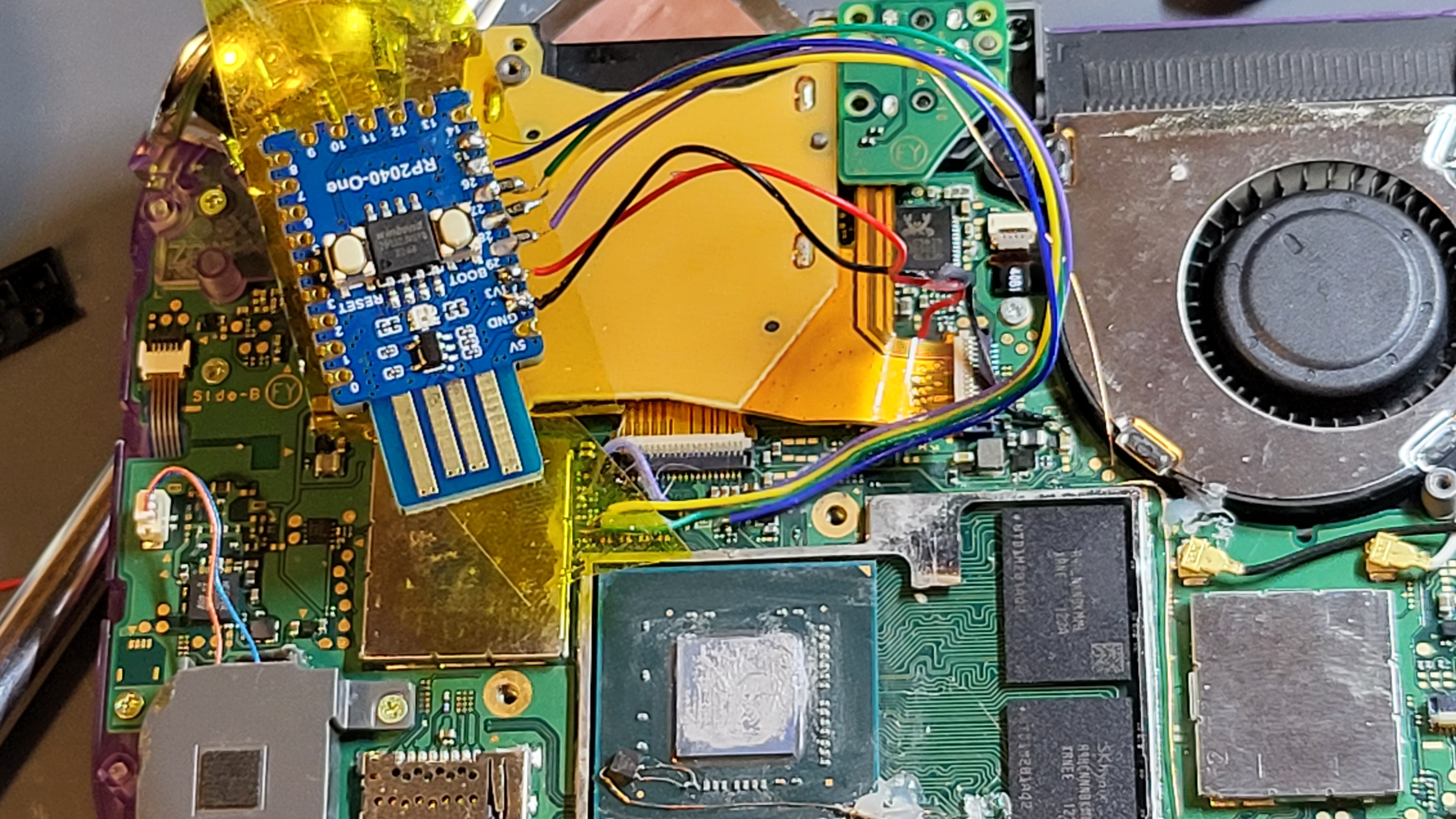

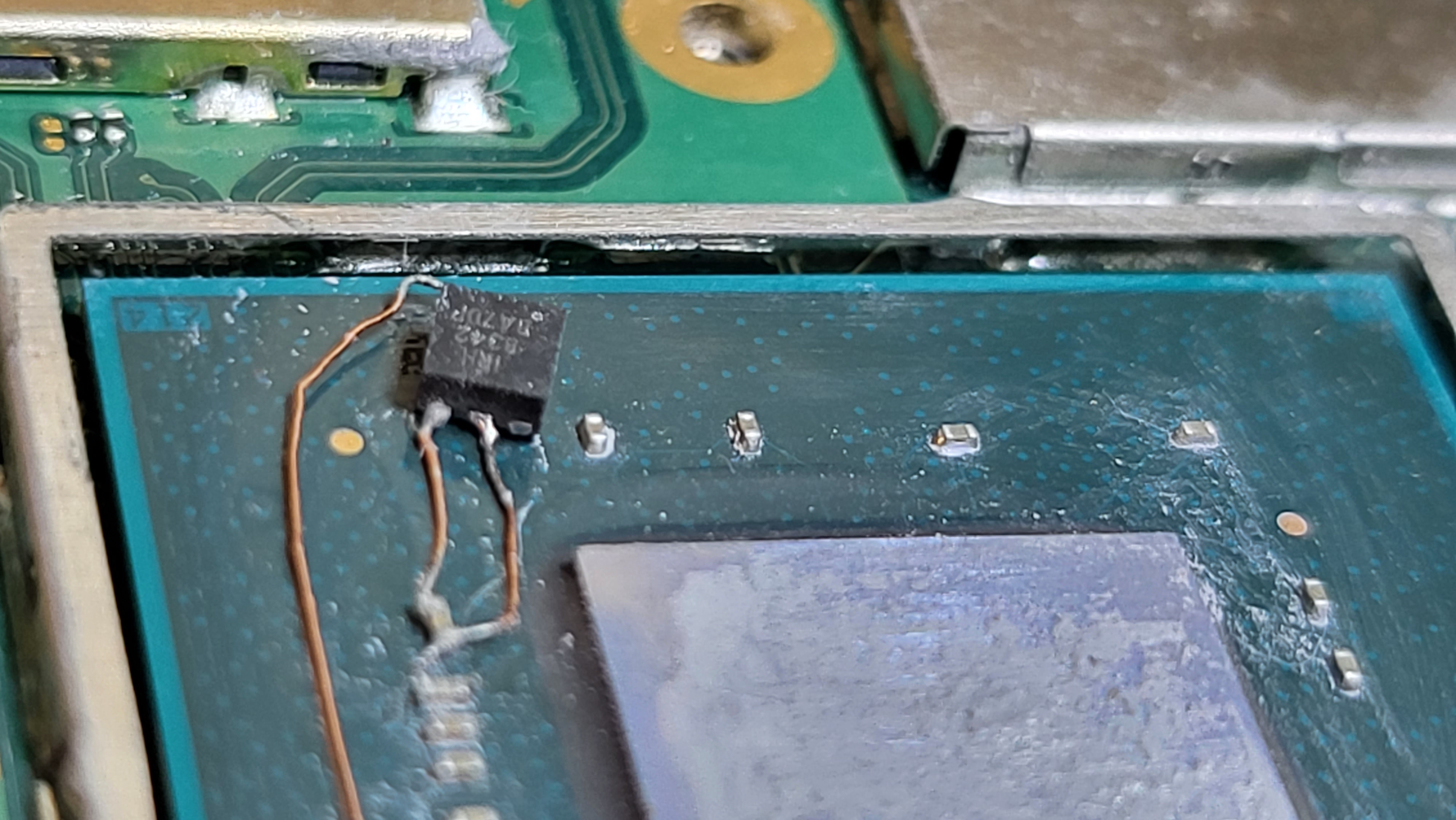

Does anyone have any ideas what I am maybe overlooking. I have Waveshare 2040-One I flashed with latest firmware 2.67. I have set “RGB mode” jumped. When I power on the Switch Lite I get a blue then cyan. I have changed mosfet twice.
I cut left speaker in half to fit full RP2040, the top half is just a chamber for acoustics. Speaker still works fine. Switch lite has terrible sound anyway.
View attachment 367691View attachment 367692View attachment 367693View attachment 367694

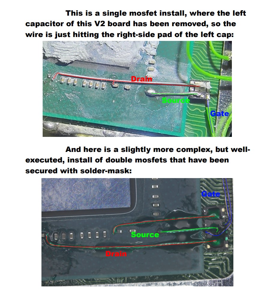

Where is your mosfet wired to? try adding a second fet and shortening the wire length
please try to follow this way, your mosfet wiring is not solid enough
you can also wait for the v2.7 where the mosfet requirements might be drastically lowered (optional, will require more wires)

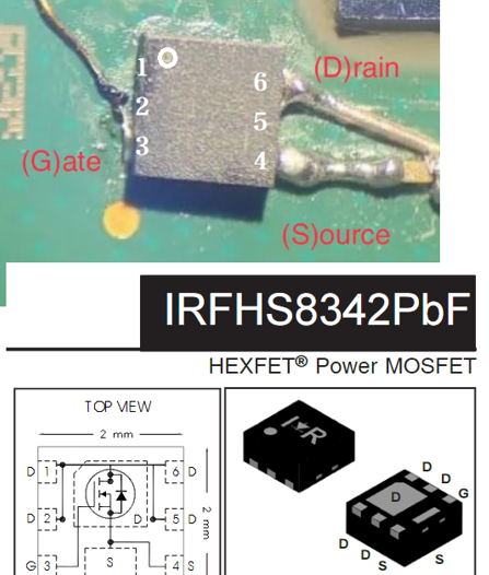

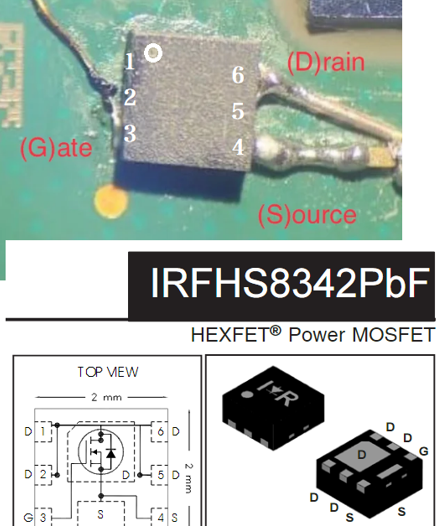

I have pin 3 to rp2040, pin 4 to left side of cap, pin 5 to right. I'm temped to try the single/double in guide. Does it matter what drain I use aren't they all connected. The single mosfet image looks like they have pin1,2,5,6 it's all soldered together
I have pin 3 to rp2040, pin 4 to left side of cap, pin 5 to right. I'm temped to try the single/double in guide. Does it matter what drain I use aren't they all connected. The single mosfet image looks like they have pin1,2,5,6 it's all soldered togetherView attachment 367703
D has 5 pins , S has 2 pins , G has 1pin
Reactions: Type_O_Dev
The more contact you get from solder points the better the chances of it working.
Shorten the wires on pico, connect both capacitor points if possible. Use 0.2-0.3 wire for mosfet if possible. You can also solder the S(ource) point to the shield.
  • Love
