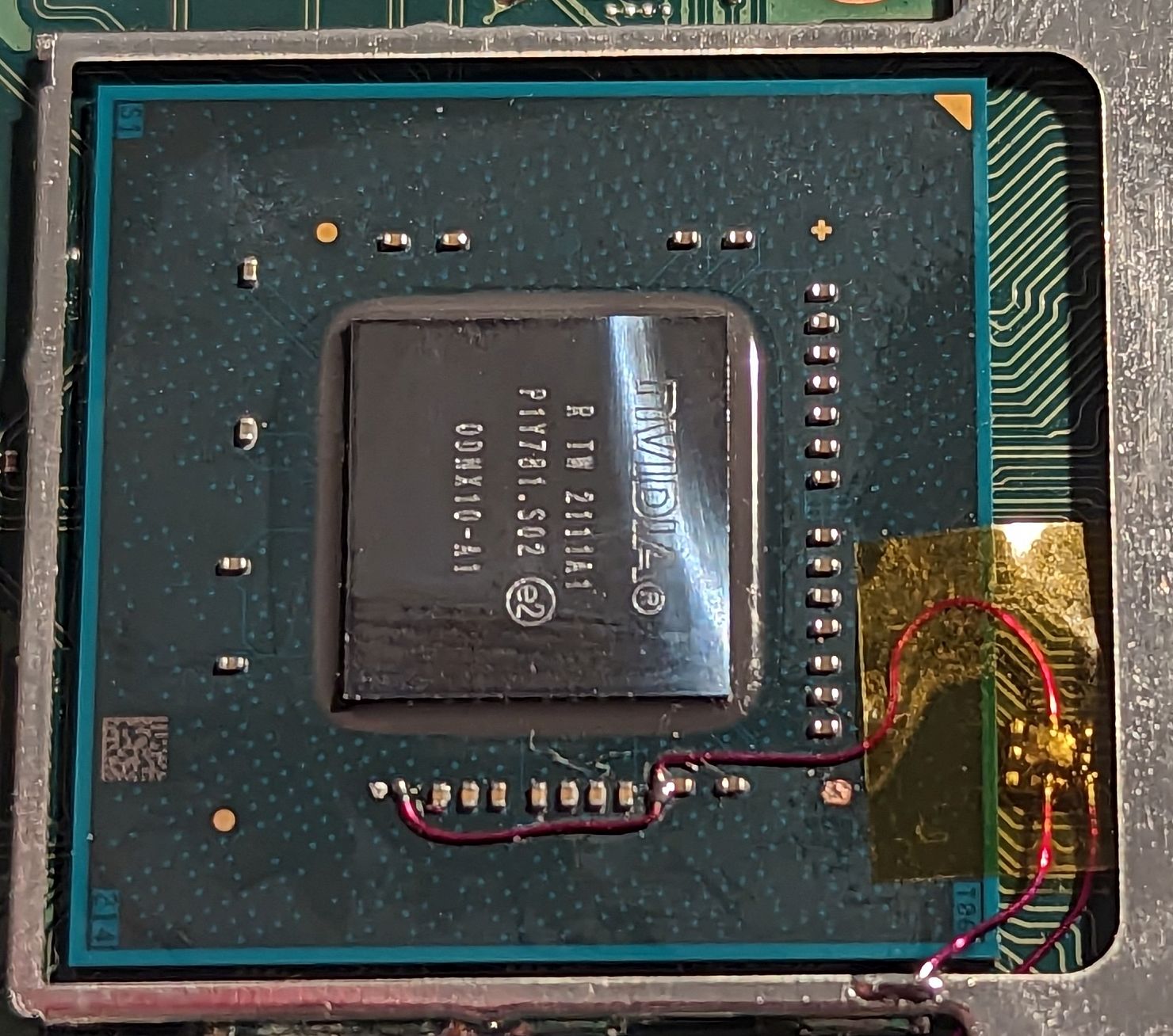

please try to follow this way, your mosfet wiring is not solid enough
you can also wait for the v2.7 where the mosfet requirements might be drastically lowered (optional, will require more wires)

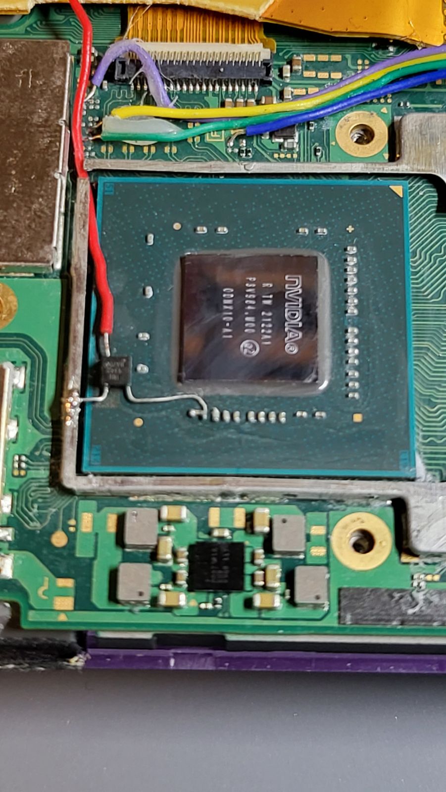

Good to hear, I tried again and still cyan. New wires and CPU wire is now only 3 inches (7.62 cm). As much as I am planning on waiting for 2.7 It bothers me to let it sit there. I've been making crap harder for myself, but that's how I learn :hateit:
I think I'll try your link 1 mosfet method.

No problem, you can use any type of wire as long as you are comfortable working with it and you make sure you don't rip any components or traces, and since you have experience soldering to SMD I don't think that will be a problem for you.
You do however need to use at least 30-32awg on mosfet and 3v3 (maybe ground aswell).
Also 30awg should be closer to 0.25-0.3mm. If yours is 0.58 it might be to thick and difficult to use in this mod.
Good luck

if u have it use it, i really recommend using it , there is a less chance of ripping off components or pads its conected to.
and its is enough to handle the power lines.
only place where u need to use atleast 0.2 if ur not using a flex cable is on the apu where u connect the apu to the mosfets.
otherwise all the way 0.1

Is it possible to use the method for only one Mosfet for the OLED? So the one where you have to remove the left capacitor.
It's always possible to use only one mosfet. If everything else is ok and still does not work then you need to add the second one.
You don't need to remove the capacitor, it's just that some people find it easier to solder directly to the pad with cap removed. In fact it is better that you don't remove the cap.
