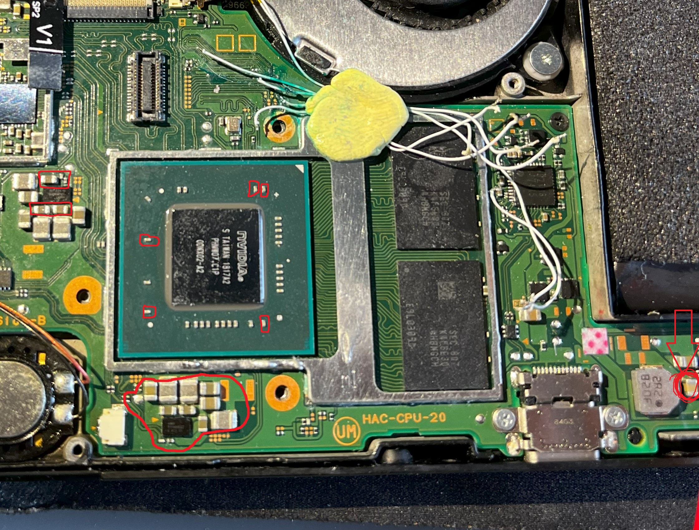

Hi! My 4th picofly, have done 1 oled and 2 lites always with flex cable with no problem
Was doing a V1, measured all diode values before turn on, all good but, forgot to attach the emmc chip, turn the switch on, the chip only showed blue light and then turned off...And now doesnt turn on anymore
Did tried many things but since then I have a lot of shorts everywhere (red in image)
The cpu is dead right?

Forgeting to connect the emmc did not cause this issue.
Most likely you only have one short somewhere but now it registers throughout the whole pcb.
Try to visualy inspect all the places you soldered and see if you can spot a bridge somewhere. If not, check to see if you can see any discolored component (capacitor or power controller).
Another option is to use a rosin atomizer (check on aliexpress) and plugin the battery for short period to spot where the short is.
The easiest way would be to send it to a phone repair shop and they should be able to find the issue in no time (having the right tools helps alot)

Did you check these areas?
It looks like there is a bridge between those 2 caps.
Also it looks like there is some solder residue on the screw hole copper plate.
Maybe the photo is not so good.

Yeah I have look carefully many times but cant find
The first image I've already measure and its not shorting, just checked second image seems cleared
Didn't know about that rosin atomizer that would definitely helps, I was thinking about buying a thermal camera and inject voltage like I seen on some videos. Guess I'm gonna try that option first
