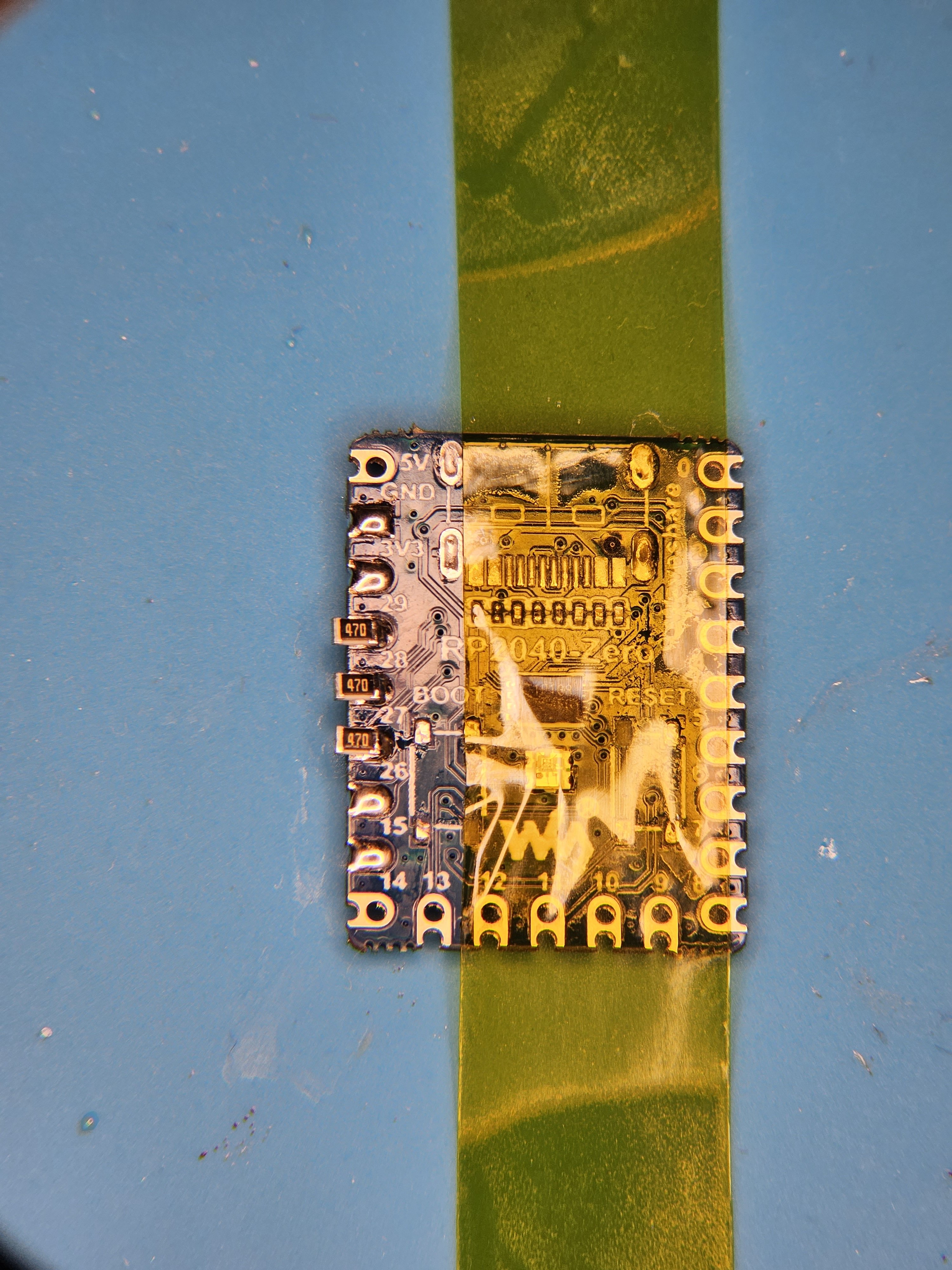

hello guys, i've install a picofly on OLED switch, it boot ok into HEKATE but when i try to create emuMMC go in EMMC INIT ERROR, if i try to start OFW it go in PURPLE SCREEN (kernel panic).
so i've removed picofly, install an HWFLY and everything gone fine... and also OFW boot normally...
what can be?
i've tried FW versione 2.61 and 2.65, same result
i've put 47 Ohm resistor (on point A,C,D)
EMMC is SK hynix
let me know if i can provide some info to make a better firmware :)
Hello guys, I did a test with 2.5 works fine, with 2.65 I get kernel panic and purple screen,
Now I’m quite sure is related to some problem with the 2.65 firmware…
