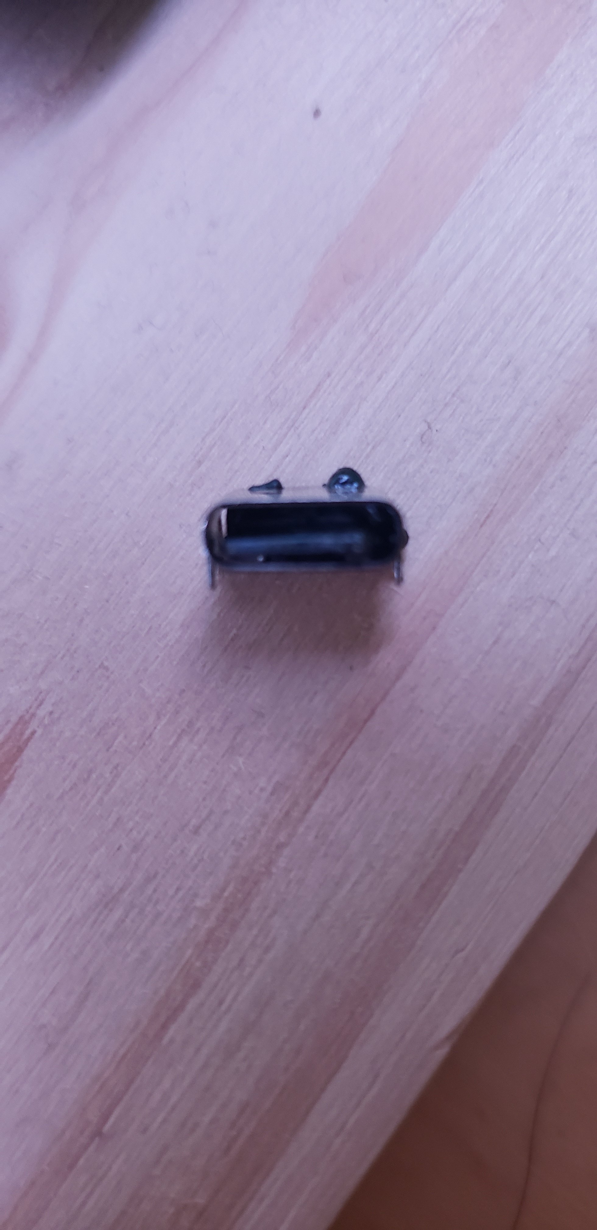

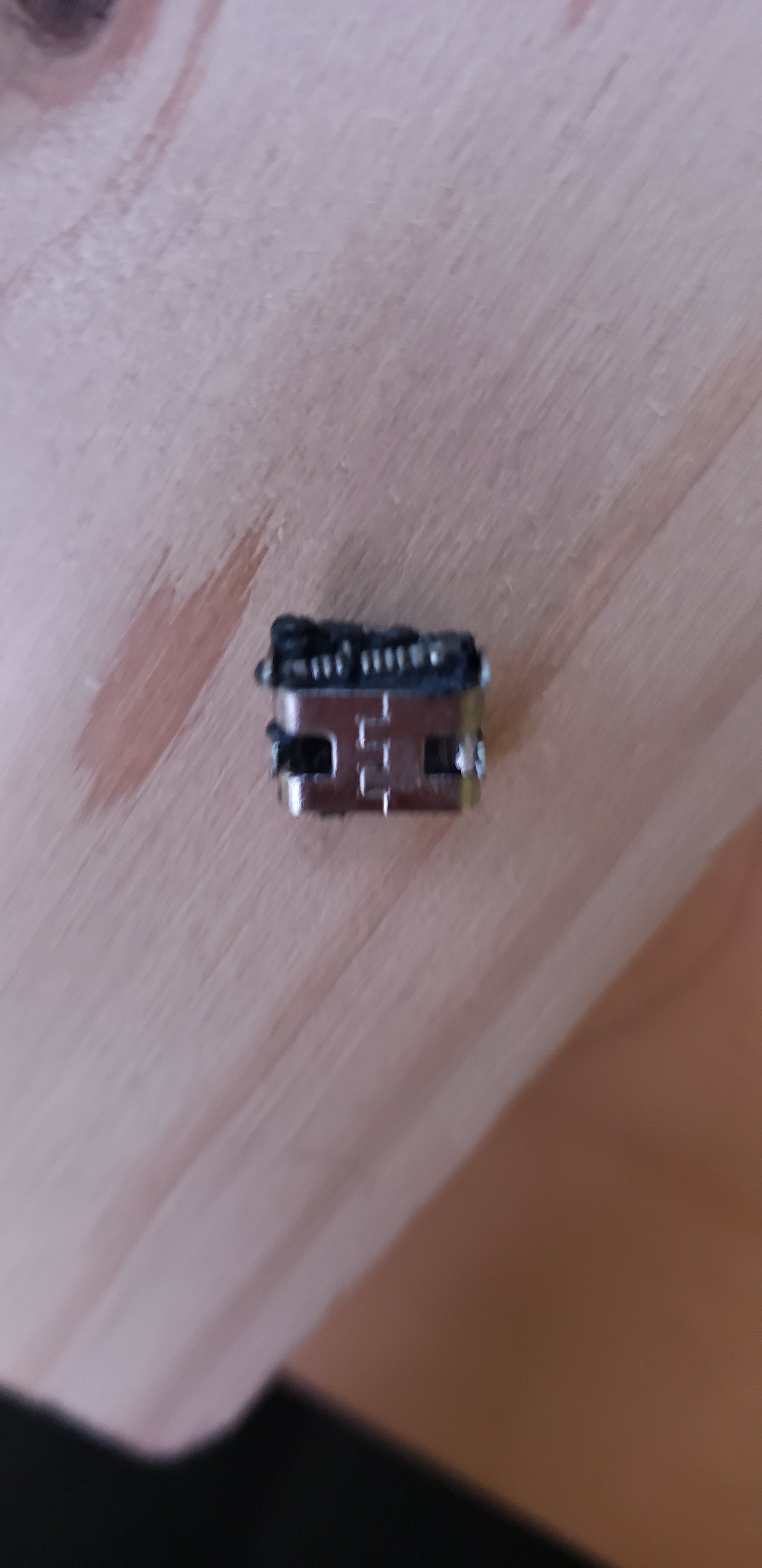

Yeah, I wanted to but..
Bro kinda melted
I should buy another one?-
I don't wanna solder all that pins at the back :'( (Is that easy?)
