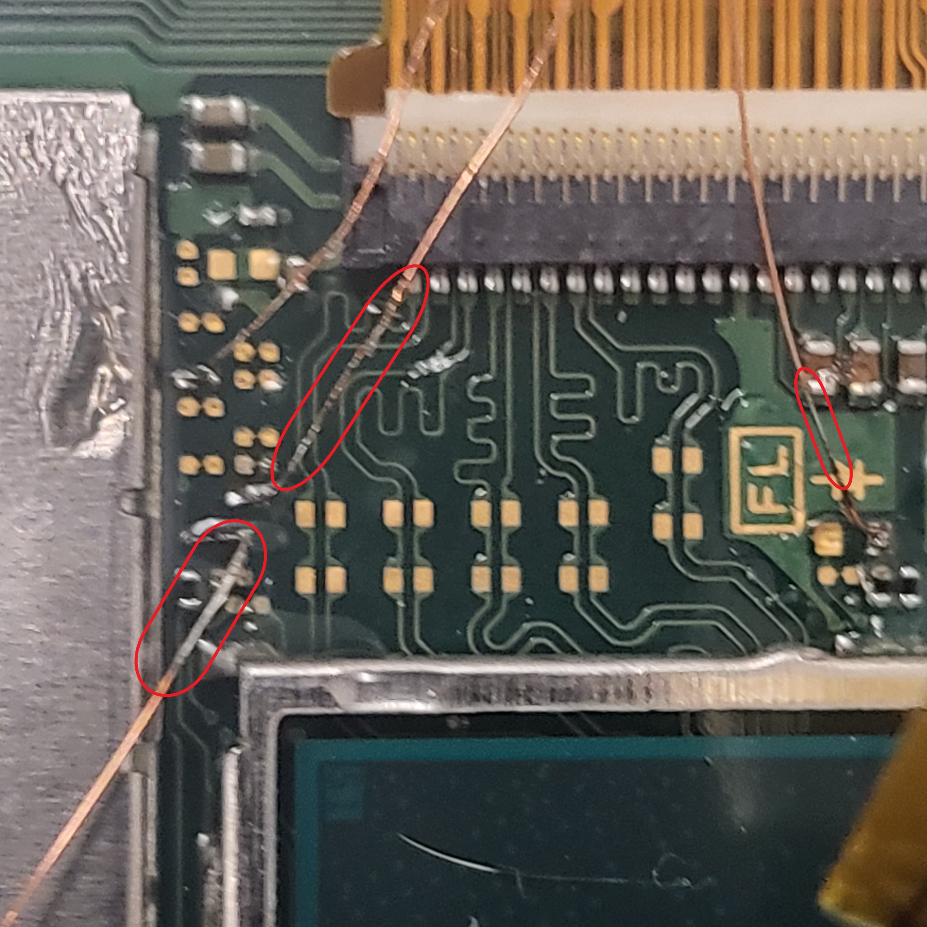

Hi bro..
Attention please.
In 2th photo, i see a short circuit on the capacitor
The first and the last were the hardest
And this one specifically
Here.
This wire is
Personal opinion, take it as advice.
Furthermore, that wire appears really too thin and above all it seems to be without protection (lacquering) near the welding points.
It is too bare and covered with tin extensively.
Reactions: A-Hacked-Soul
Hi bro..
Attention please.
Here.
This wire is

Sorry bro, The user doesn't claim it works.
It can never work if it doesn't fix this.
Oh Snap! Nicely spotted cicci, that's some serious short if the other side of the capacitor is at GND.
@A-Hacked-Soul you should only keep the last part of the wire tinned, here it looks like there's at least 1cm of the wire pre-tinned, and if that turns true, you're risking some FUBAR Switch situation...
The exact name is Cicci0, excuse me...
:rofl: give me your name, please :rofl2:
Jokes aside, that's what I pointed out to him, serious defects and risk making the console unusable.
Perhaps your intervention is more appreciated (as you are an older user), but my intent was constructive and not a criticism of the work done.
