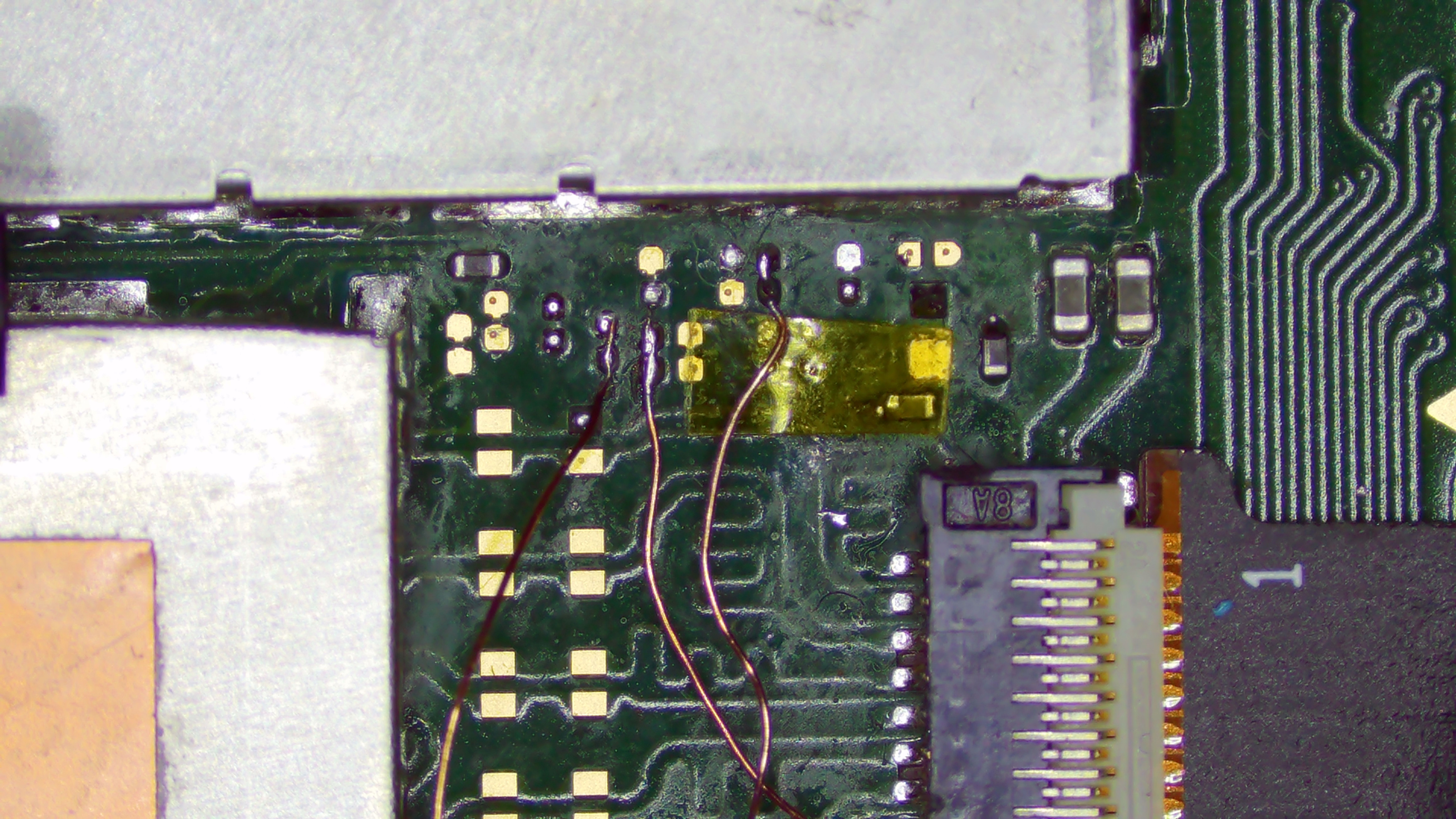

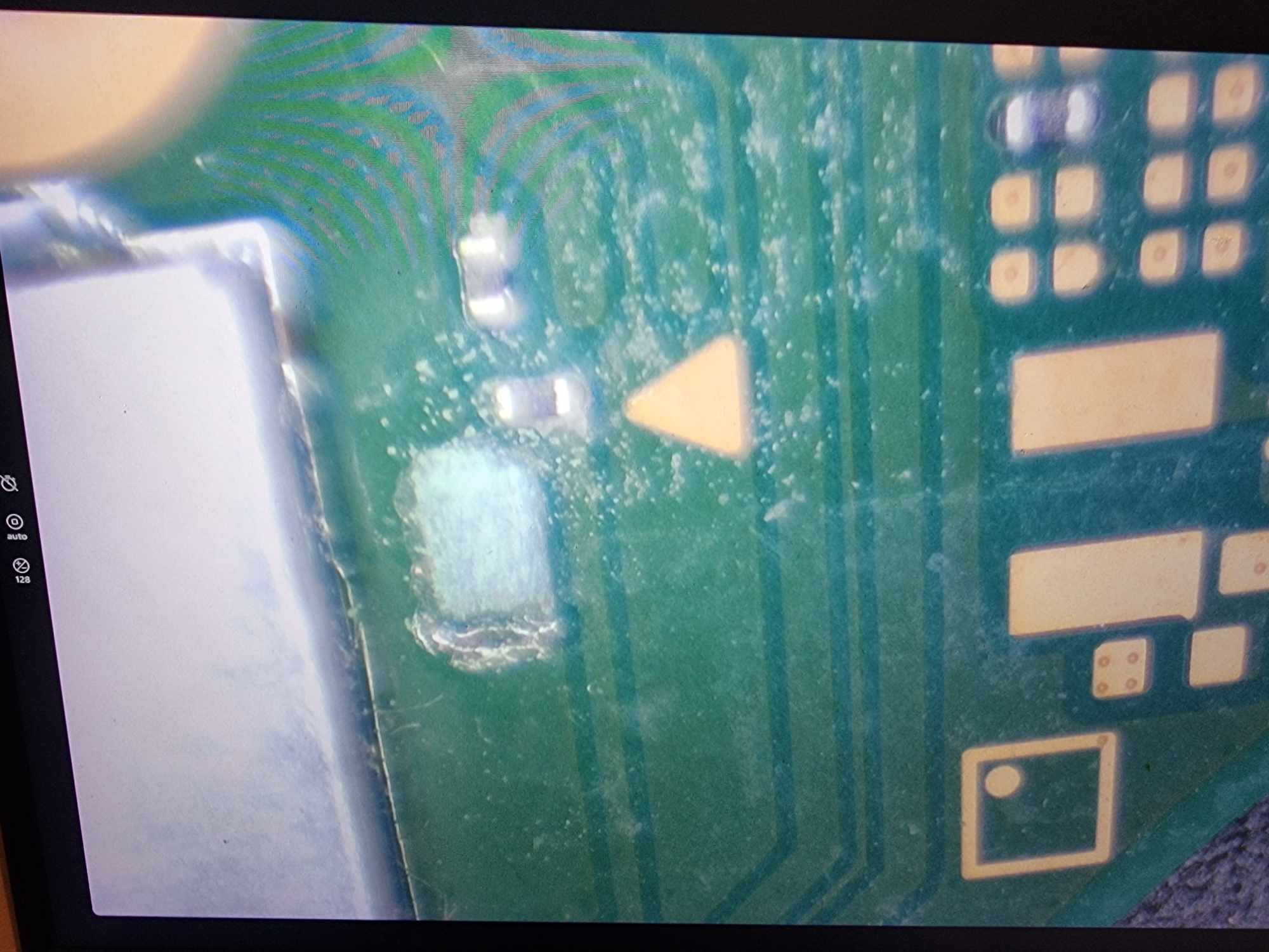

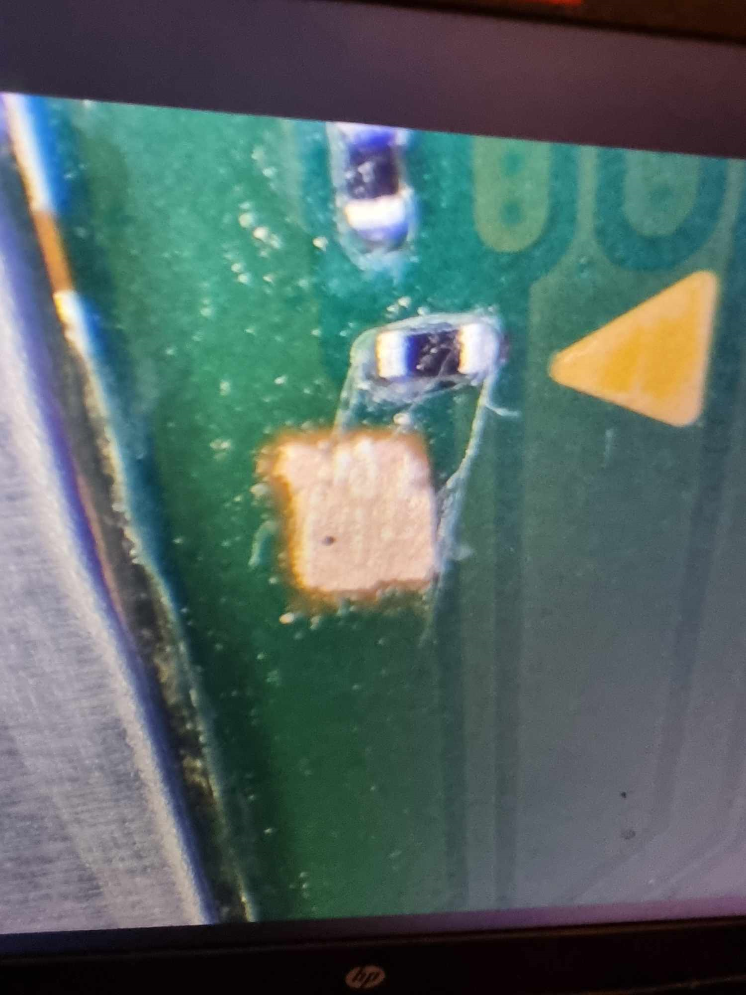

Hi all wondering if anyone else has come across this on a ns switch lite. Using picofly with 2.73 firmware. I get *=* yellow light and it boots to ofw. I have double checked all my points. I original installed with enamel wire which can be seen in the video, and then thought maybe the wire i bought was too cheap and bad so i have redone all my work with 36awg wiring but still getting the same issue. All points have diode readings. I have flashed the 2.73 firmware twice but still getting this short, long, short yellow blink. Any ideas? Thanks all!
The error i can see from the video is *== No eMMC CMD1 request (poor wiring, or dead CPU)
Check your wirings. Make sure nothing is shorted as cmd and clk points are almost nearby each other.
Thanks for the assistance, I have double checked in continuity and can't find any shorts, i have attached some pictures of my install. My console is not dead, it still boots to ofw fine
just remove cpu cover, check again。problem will be solved。
This point is not correct. Recheck again.
After i installed picofly on Switch Oled, right joy-con won't charge and detect any more and it works only wireless. What can be wrong ???
To be clear, both CMD and CLK are in the wrong positions.
It would appear that CLK is where CMD should be, and CMD is shifted one up. If the wire closest to the bottom of the board is the CLK wire, shift it down one set (to the other set of tinned pads), and then resolder CMD to where you moved CLK from.
Omg thanks so much, I can't believe I overlooked this, and the point was wrong, I'll report back once shifted over! :)
Complete and working!! Thanks a bunch, can't believe I overlooked this, feel so stupid! thanks again @lightninjay and @psycho-neon Merry Christmas to the community here!

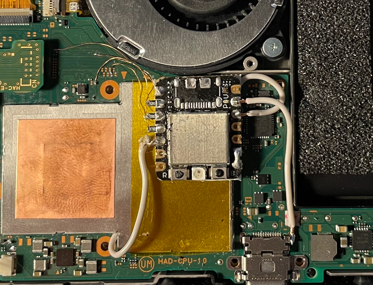

Has anybody experienced the weird problem, that the glitch only works when the Switch battery has < 40-50%? But then it's absolutely stable.
Needed to leave the Switch turned on the whole night to drain the battery lol.

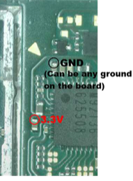

what? never had this problem. where are you taking your 3.3v from?
from the resistor as suggested:
but i took the GND from the USB Port because it was easier to manage
Main problem is that everything is assembled back together because i thought that it works fine.
Edit: Btw, same problem while charging the Switch
Is that xiao ?
I have bad experience with xiao.
Broke my phone usb when playing with uv sensor, and got difficulty when glitching switch.
