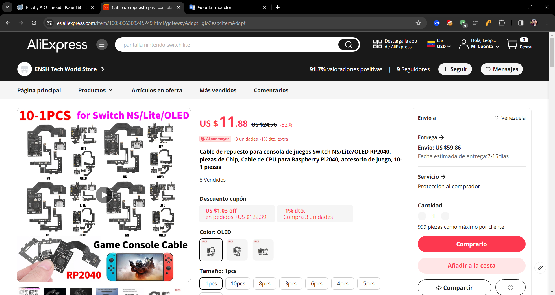

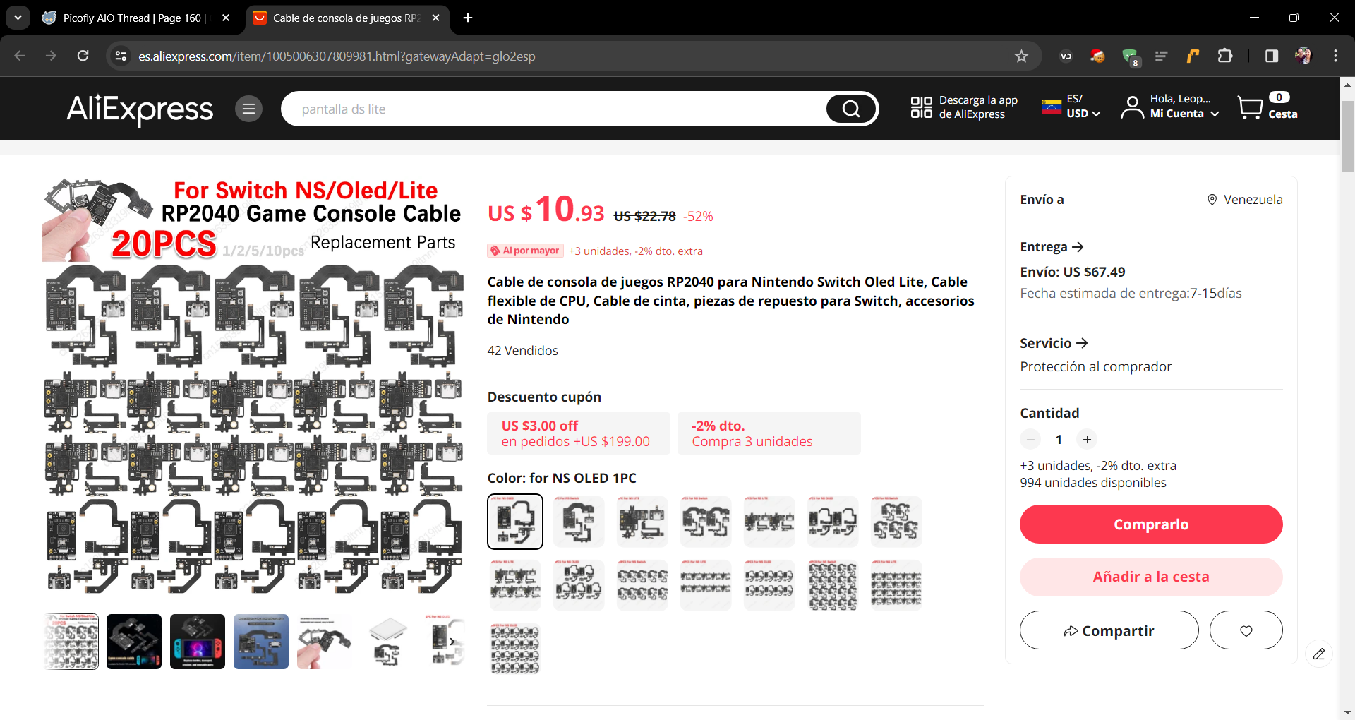

Apart from Aliexpress, is there another page? Aliexpress shipping to Venezuela is very expensive. I guess that's why the welders here charge 130-200 dollars to install the chips.
too expensive, it's better to give it to the welders
My plan was to buy everything myself, and only pay for the labor. Because I also have to repair it, change the fan and the screen of the Switch. I suppose that there is no direct shipping here either from any country, for example in Amazon USA we have to use intermediary companies that offer shipping from the USA to Venezuela and to pay for Amazon products we need cards from other countries or Digital Wallets that have a physical card.

Getting back to the topic, I check Aliexpress better. They offer direct shipping to Venezuela from China and those are the prices of Fedex and DHL, the latter being more expensive.

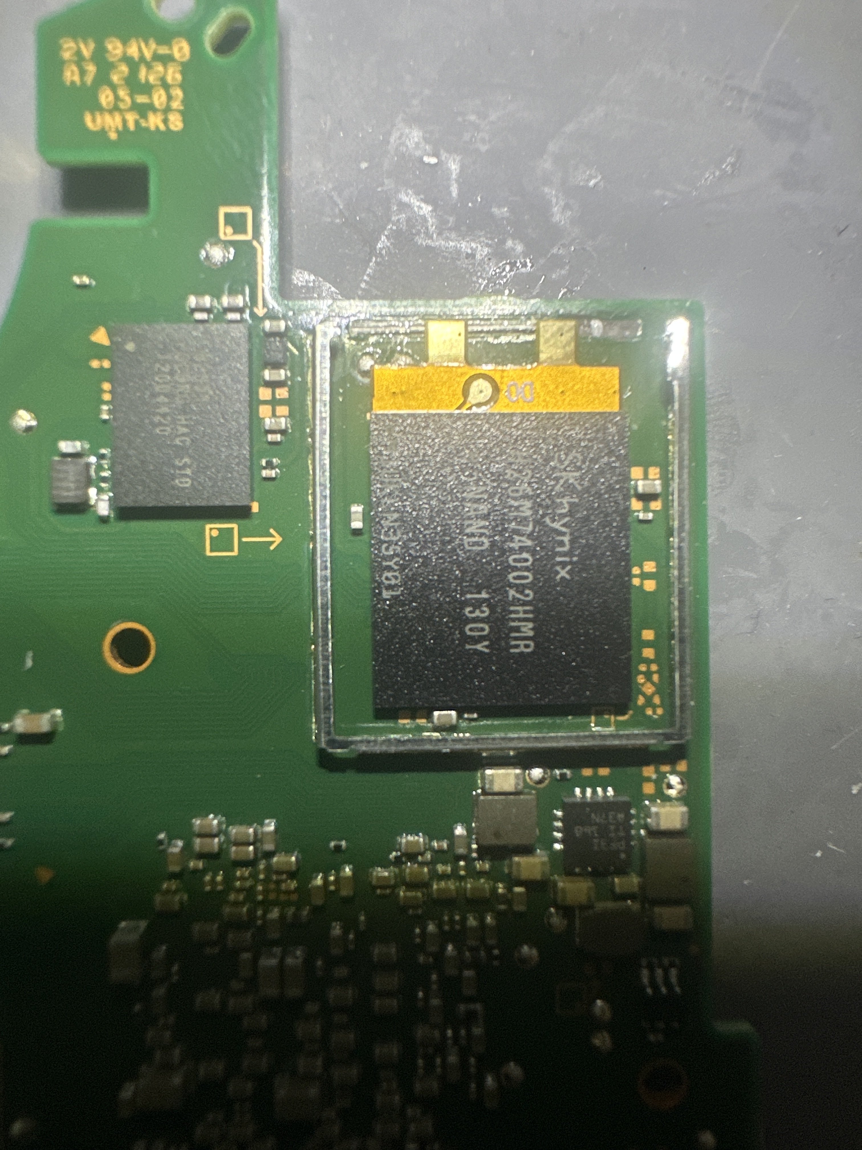

Hi, I’m installing a modchip for a customer now. The dat0 adaptor have 2 different readings randomly in diode mode. 1 is .48v one is .65v. Is this normal? It’s skhynix chip and I’m using adaptor that have new-v11 on the back

It doesn't look aligned, the white line is disappearing under the chip.
What measurement do you get with red probe on GND in diode mode?
Once properly aligned, remember to anchor it well, though these adapters may still fail in the future. If it's possible for you, perform eMMC reball with permanent connection.

Hi, thanks for replaying.
I’ve aligned it multiple times and use different adaptor, still some times give .65v but most of the time is .45v
Red probe on GND read .43 all the time
