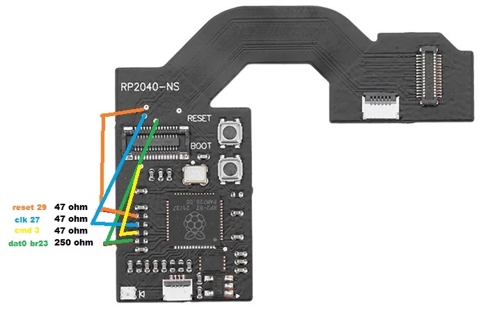

I installed the V1 rp2040 from Aliexpress and it worked until I ran a couple of games and they wouldn't start. I then rebooted the Switch with Atomosphere giving me the error 2002-3540. I decided to just boot into normal Switch mode and it's stuck at the Switch logo. I tried remove the rp2040 and reinstalled the nand with it still being stuck on logo. It goes into Hekate just fine and I've been making backups just in case I corrupted the nand somehow, but the backups are after I wasn't able to boot. According to Hekate it charges just fine, so what did I do wrong? What do I need to fix this?
**UPDATE**
I did the same thing in this video and I'm able to boot the switch with Atomosphere but not normal switch mode. I haven't tried without the rp2040 but why is this happening?

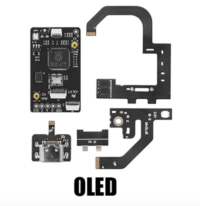

Hello considering modding my Zelda oled switch, since it's the homebrew stuff I want to use it for.
I have purchased this alieexpress mod chip and I wonder if anyone have had success with these on oled? From my understanding it's a copy of some other modchip kit?
Have found this video which seems to use the same modchip.
Also wonder which firmware for the rp2040 to use, is it 1.73 which is the most stable?
Just wondering which chip I would go for with highest rate of success =)

i used this chip many time and working ok, it came without firmware you need to add it, i use 2.75
https://github.com/rehius/usk/releases

The problem is the resistor in Dat0/cmd.you need to replace it with 100ohm.because some Chinese clone picofly use 47ohm on dat0/cmd.or you can use 47+47 on dat0 and 47+47 on cmd

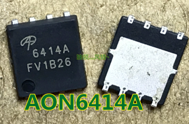

few things.
1. the chip is busted, try to check the resistor at d0/clk/cmd line.
2. the mosfet is bad, i had a bunch of IRH mosfets (50+) of them are bad. I just switch from aon6414a and never had this issue.
Can you send me some pics of this mosfet installed and a little comparison in size to a normal irfhs mosfet.
So this 47ohm resistor bricked my Switches nand? What do I need to do to repair the nand? Is this the location of the resistor?
pico-resistor-jpg.405340
If you cannot boot to ofw even if you remove the picofly means your nand is corrupt you need to restore it but if you can boot means the picofly chip is the problem.yes that's the location of the resistor.you need to remove it or add some resistor to dat0 and cmd..clk still 47ohms
I tested the resistor and I'm reading 196ohms. It's the one where the green line goes to. The other ones in that image are reading 42ohms except for the clk 27 which reads a dead short. That's the blue one. Isn't that one also suppose to be 47ohms? I'm going by the image.

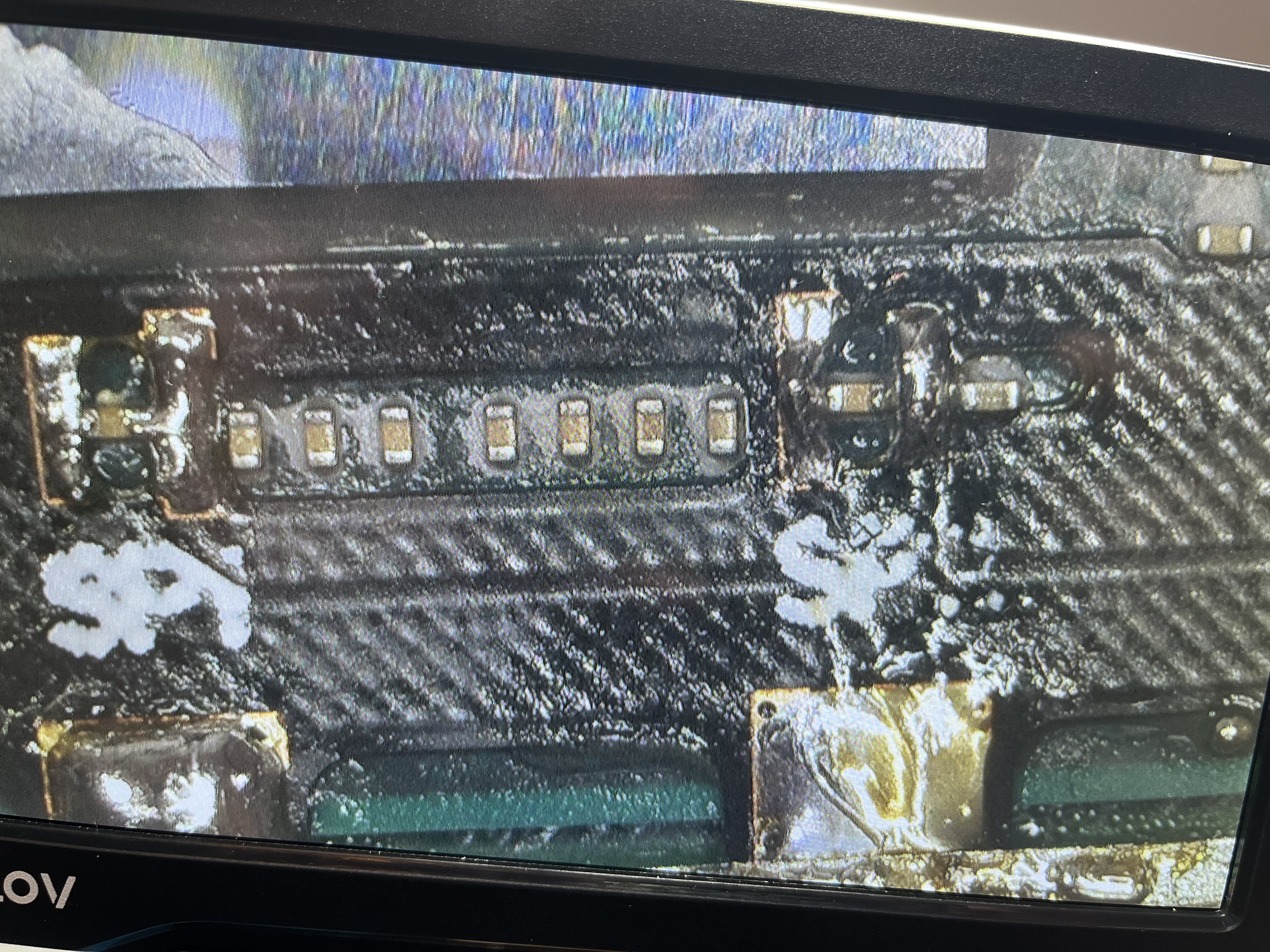

Decided to practice installing picofly on a switch lite.(My first smd soldering except from practice boards)
Wondering if this soldering looks ok but ugly on sp1 and sp2. Sp2 was real hard to get solder to stick and also not touch cap on right. Think I got to much solder on.
beep ohm readings from left 0.1 21 21 0,1(not sure what correct values are, couldn't find any info for SP1, SP2)
@Dukenukemx Please check carefully here whether there is a connection.
It's connected but I reflowed and added more solder just in case. I also replaced the clk 27 with a 47ohm resistor. Hopefully that wasn't suppose to be a 0ohm resistor.
