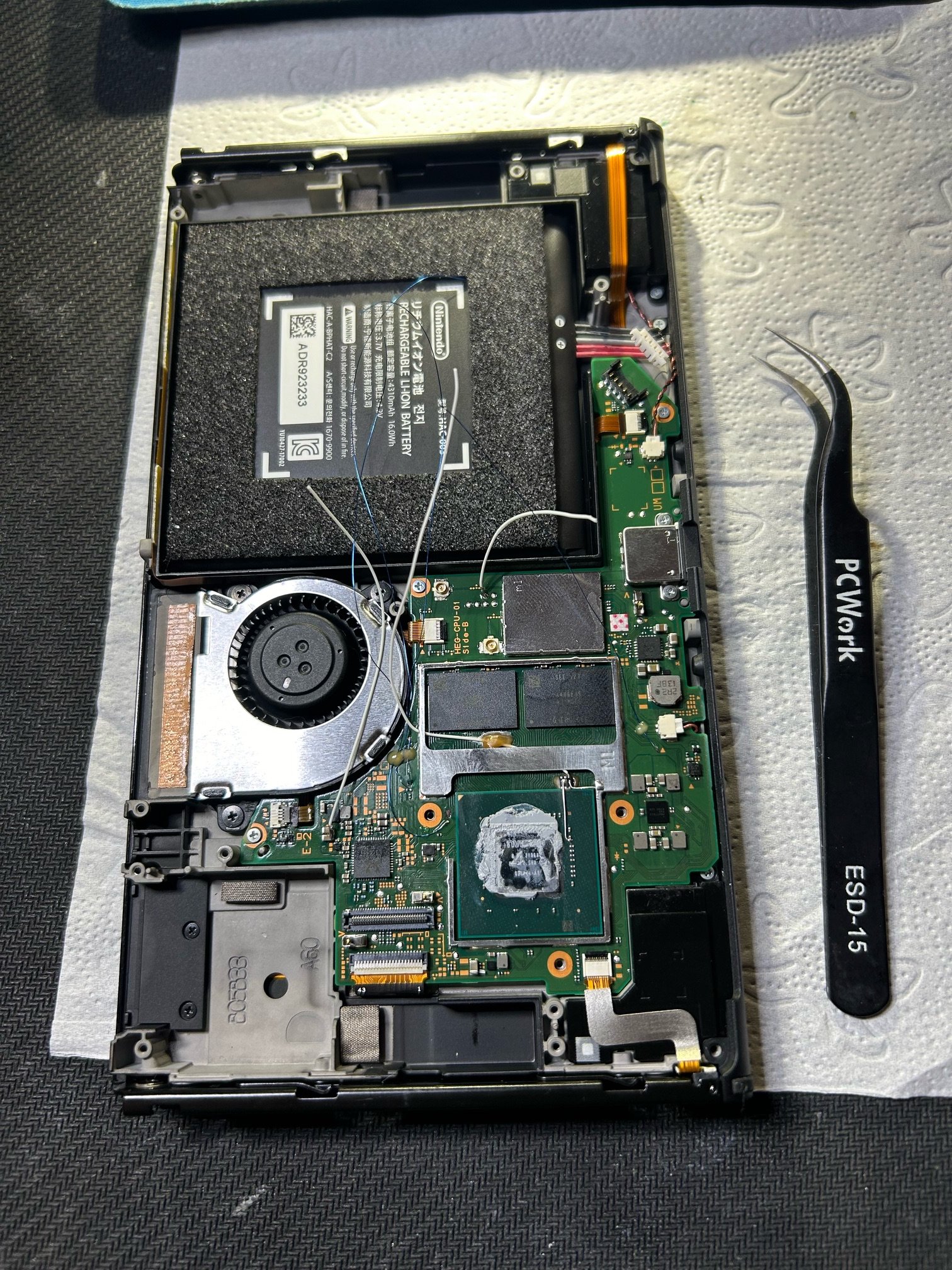

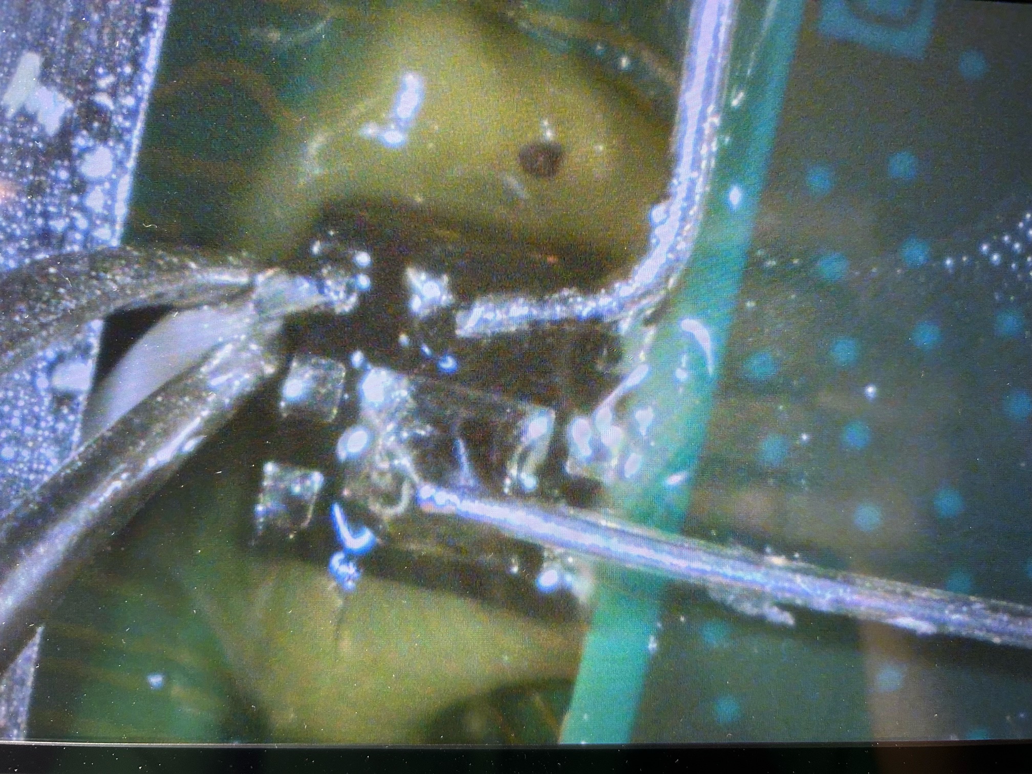

Well, I switched to the front and still ==*.
Just to add with the mosfet, make sure to use awg34 or 32 (thicker wire) for the drain.
...but I will try switching the wire to a larger gauge before complaining too much :)
All points make correct continuity, this photo was taken after I reopened so I haven't tidied the thermal paste.
few things.
1. the chip is busted, try to check the resistor at d0/clk/cmd line.
2. the mosfet is bad, i had a bunch of IRH mosfets (50+) of them are bad. I just switch from aon6414a and never had this issue.
Well, while trying to change the wires I broke the CPU cap. I guess that ends this adventure! Thanks again for all your help friends, appreciate it!
Switch works without that cap. You can also replace that cap with ones found on rp2040 board.
Don't give up, remove everything, clean everything, start over.
Seems that you need better tools or skills (or both).
Use 0.1-0.5 solder tip, use led based solder wire, good flux. Use 350°-400° temperature for short period of time (don't overheat the components or the board). For Source connection use apu shield instead of the square point on the apu itself.
Try to avoid using magnet (enameled) wire, if you don't have experience with it you might end up with cold joint or a short somewhere, use 36-40awg pfa or ptfe or silicone wire.
Good luck
Good luck
I think I'll put in an order with digikey and use the shipping time to cool my heels.
There is definitely a skill issue, but I want to learn and this particular switch was already in rough cosmetic shape so it's as good a test bed as anything.
Tools are a cobbled together set that I'm upgrading as I go, but I think I'm mostly limited by ability.
Stripping the cap was a mishandled tweezer trying to bend the wire already soldered to the cap. I thought I had it pinned with one set, but it wasn't actually pinched. Doh!

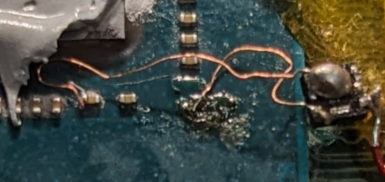

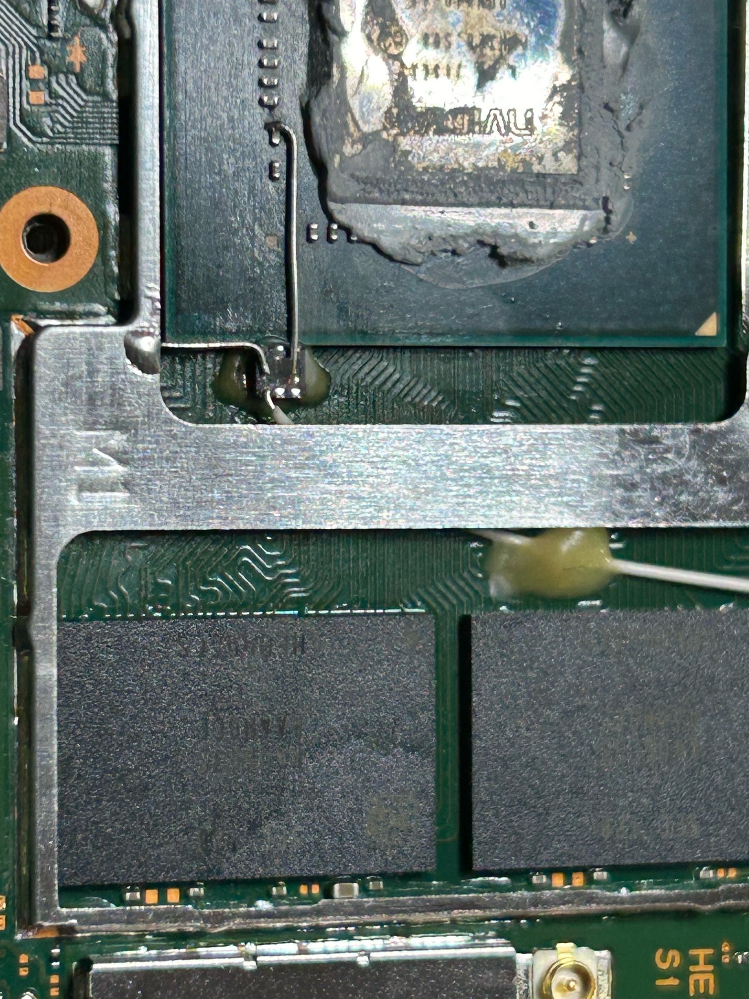

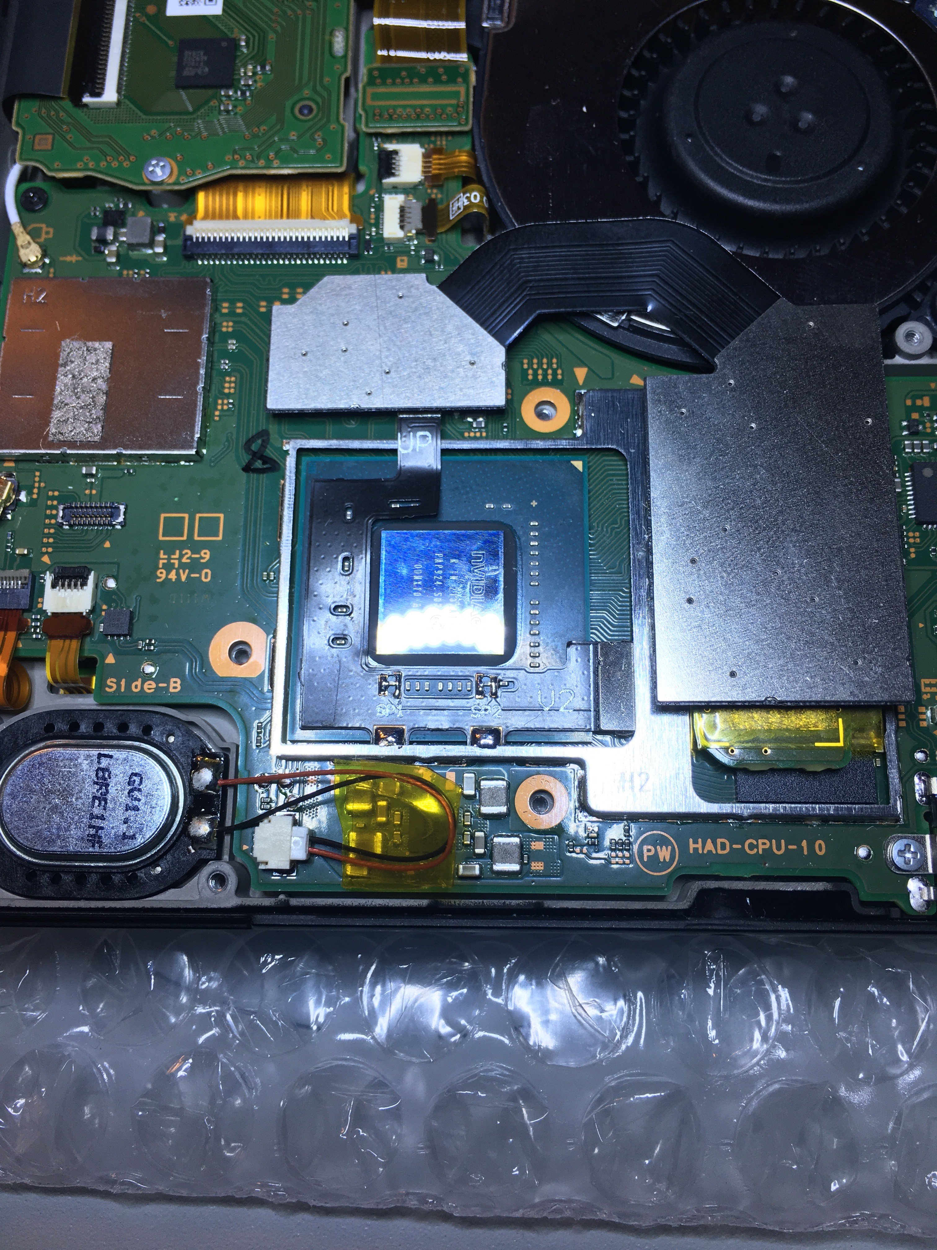

Here are some examples of the installation I did today on a customer's OLED switch.
I always follow the same basic electronics principles in a fusion of knowledge acquired in this forum on the best tips for a successful installation.Said that, lets begin :
I always start by removing the metal protection from the CPU with a needle tip and being very careful not to damage any of the components around the metal fittings. Then glue the mosfet aligned with the soldering points (Source and Drain)
I keep the wire that connects the source to the capacitor very short and always use the cpu metal shield for the grd connection (30 AWG for both). It doesn't take me more than 10 minutes to complete this part of the installation. The result is this:
Now, just isolate these connections with kapton, place thermal paste on top of the CPU core and close the metal protection shield. Now moving to the Dat0 point over kamikaze. Mark the right spot to slowly start drilling and go for it. I prefer to remove the 2 layers and then look for the under shadow of the ~Dat0 via wich you can already spot on this image. now i can be more acurate to expose the circle "head" of the via:

then, solder mask all over the grd connections, and a litle bit of flux on the copper circle.I always choose the magetic wire for CMD, CLK, DAT0 e RESET because its a very thin wire and prevents damage to any of the soldered components such as small capacitors, resistors or small pads
First, I solder all the wires to the points and only at the end do I connect them to the picofly. I always recommend that you glue the magnetic wires to the motherboard as protective anchors in order to protect these fragile connections (some people accidentally pull the wires and break the paths\components to which they were soldered). Now let's install Modchip...
I always follow this installation model and have already done dozens of installations without ever having (to date) a malfunction like a purple screen or something like that. I leave a test video with instant boot of 2 seconds using only 1 mosfet connected to 1 capacitor only.
I hope this advice helps some of you to be successful in your installations and electronics projects :)

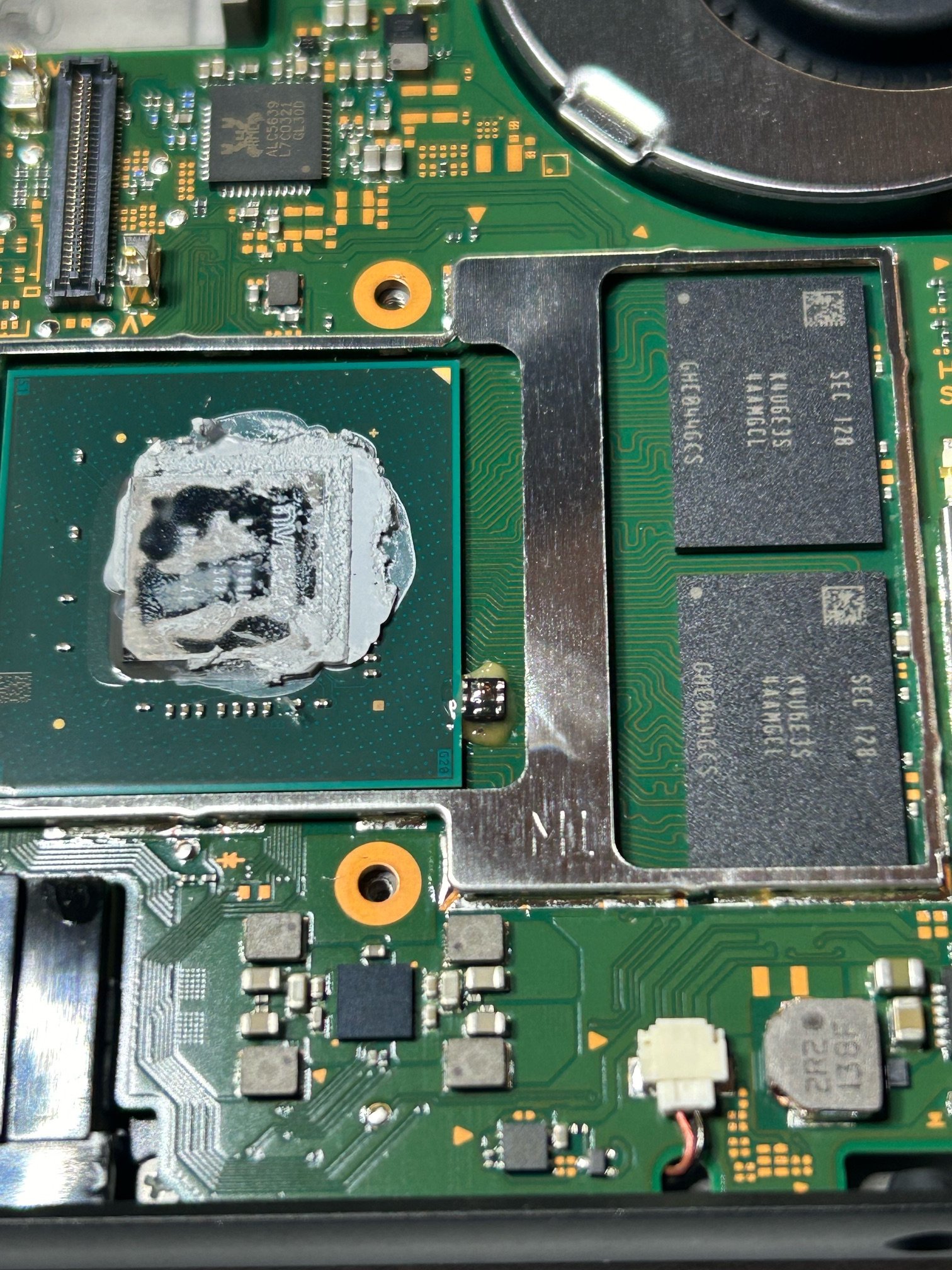

Those solder joints look fragile :( . Dont mind with the broken capacitor. I've seen several cases of people who still managed to glitch their consoles even after damaging the capacitor.

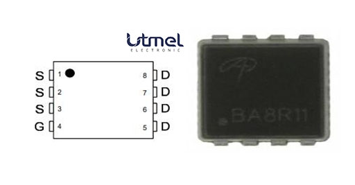

I tried to use an AON6414A mosfet and still get an error ==*. Does anyone have a photo of its setup?
THANKS
I have never installed one of these but there are several users on these forums who use this model and say it works very well. I leave the pinout here:

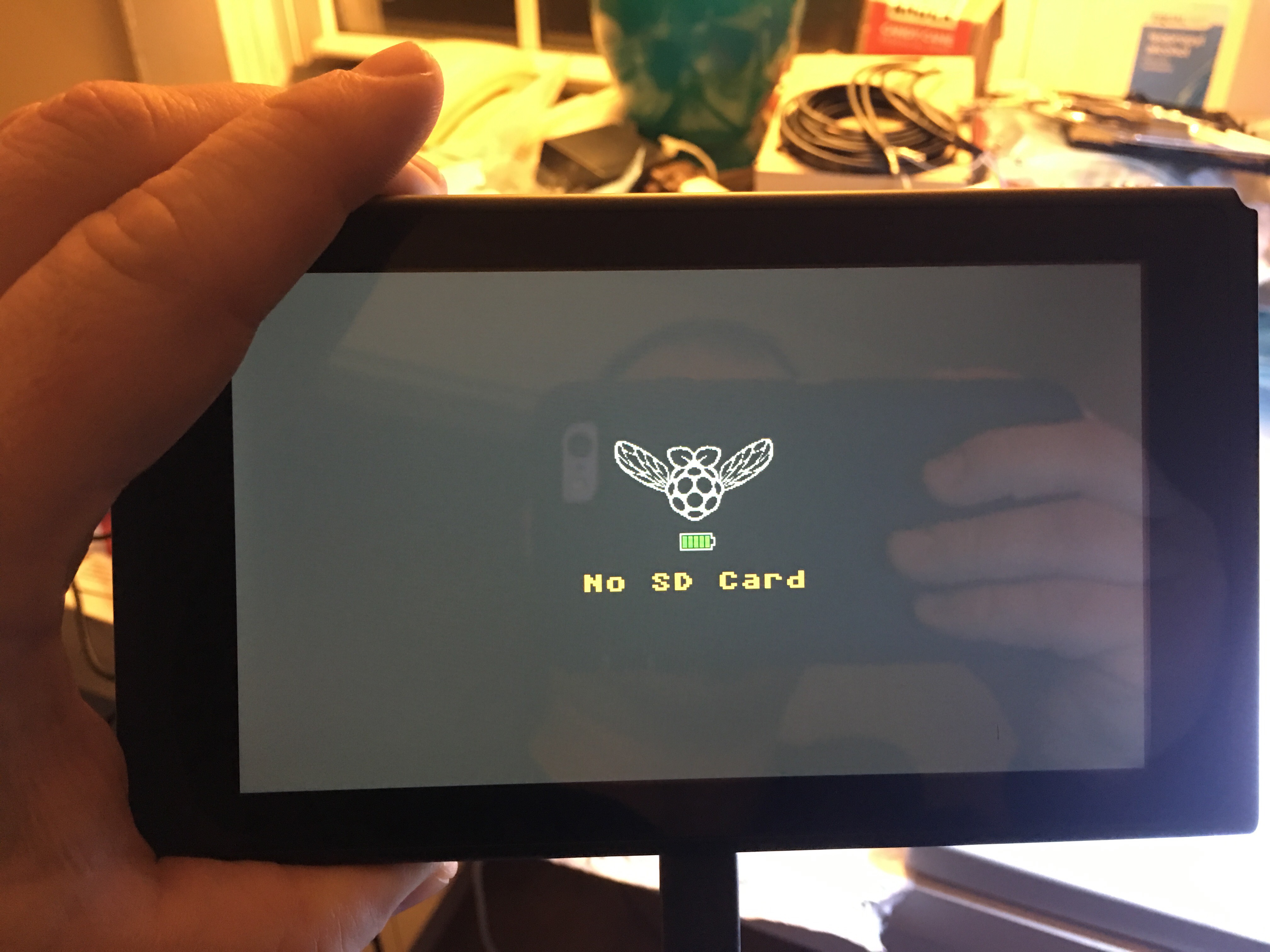

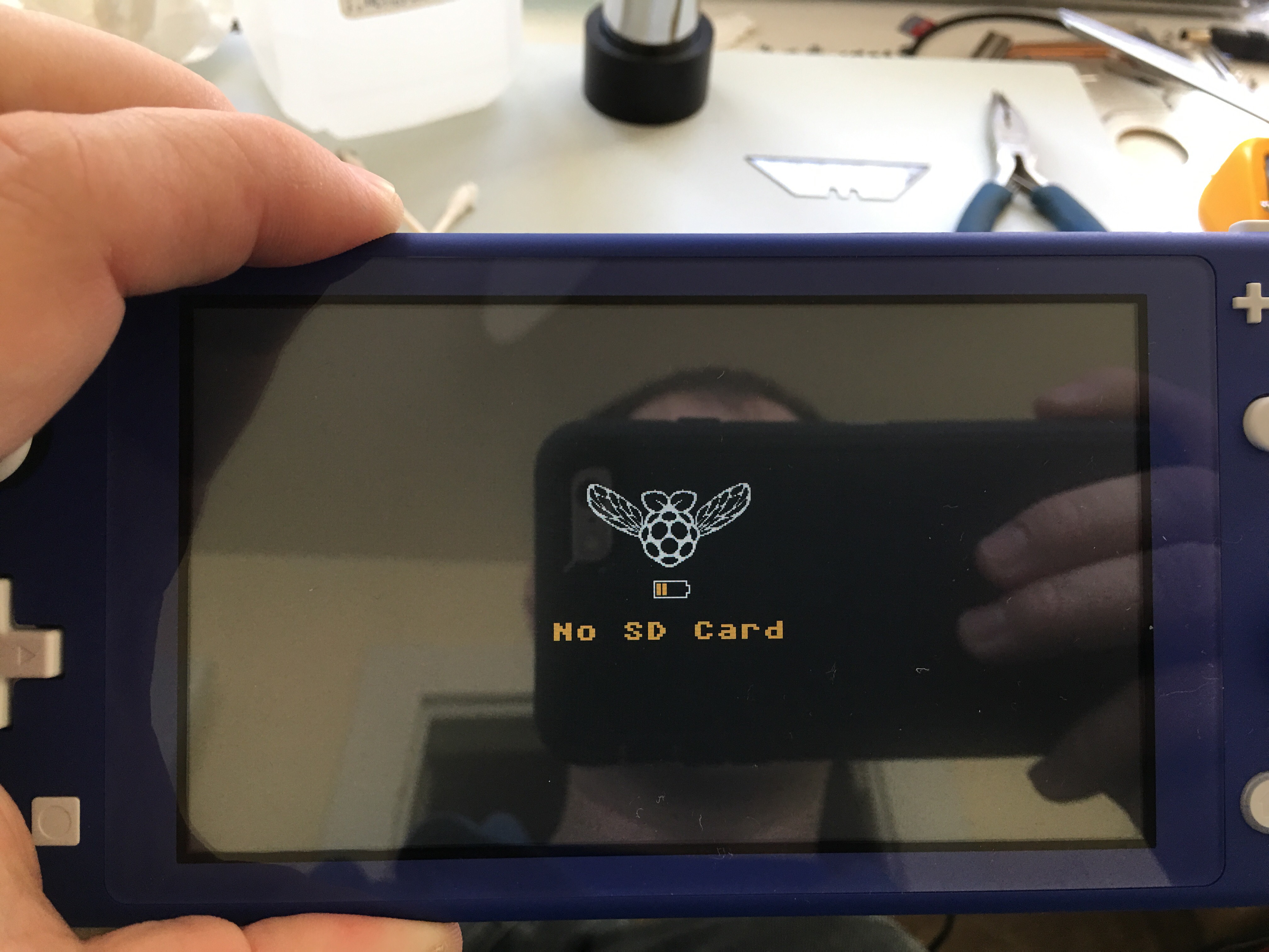

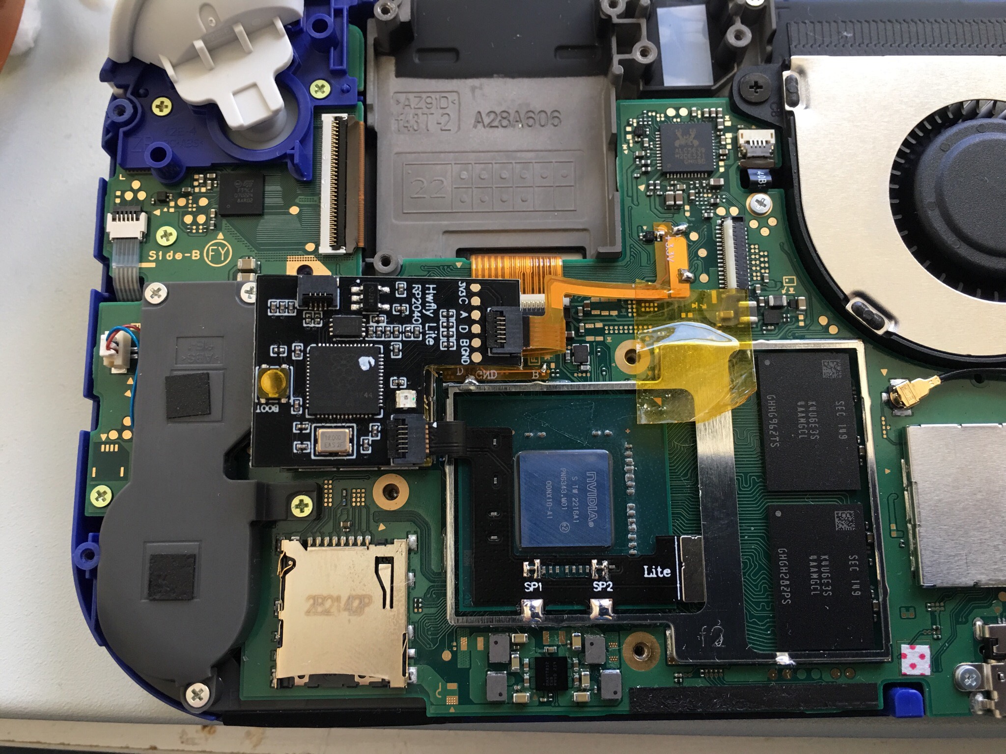

Sure!

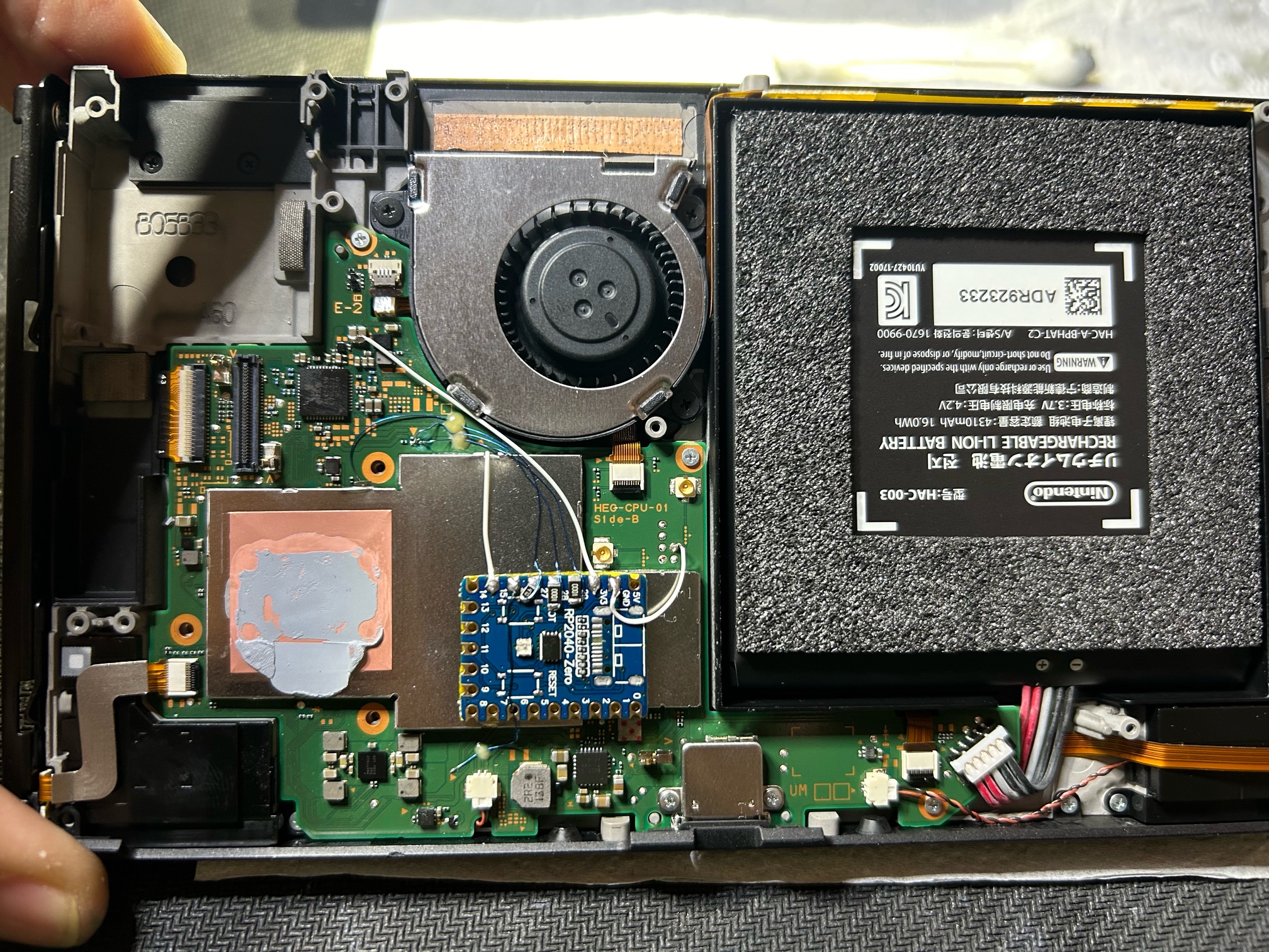

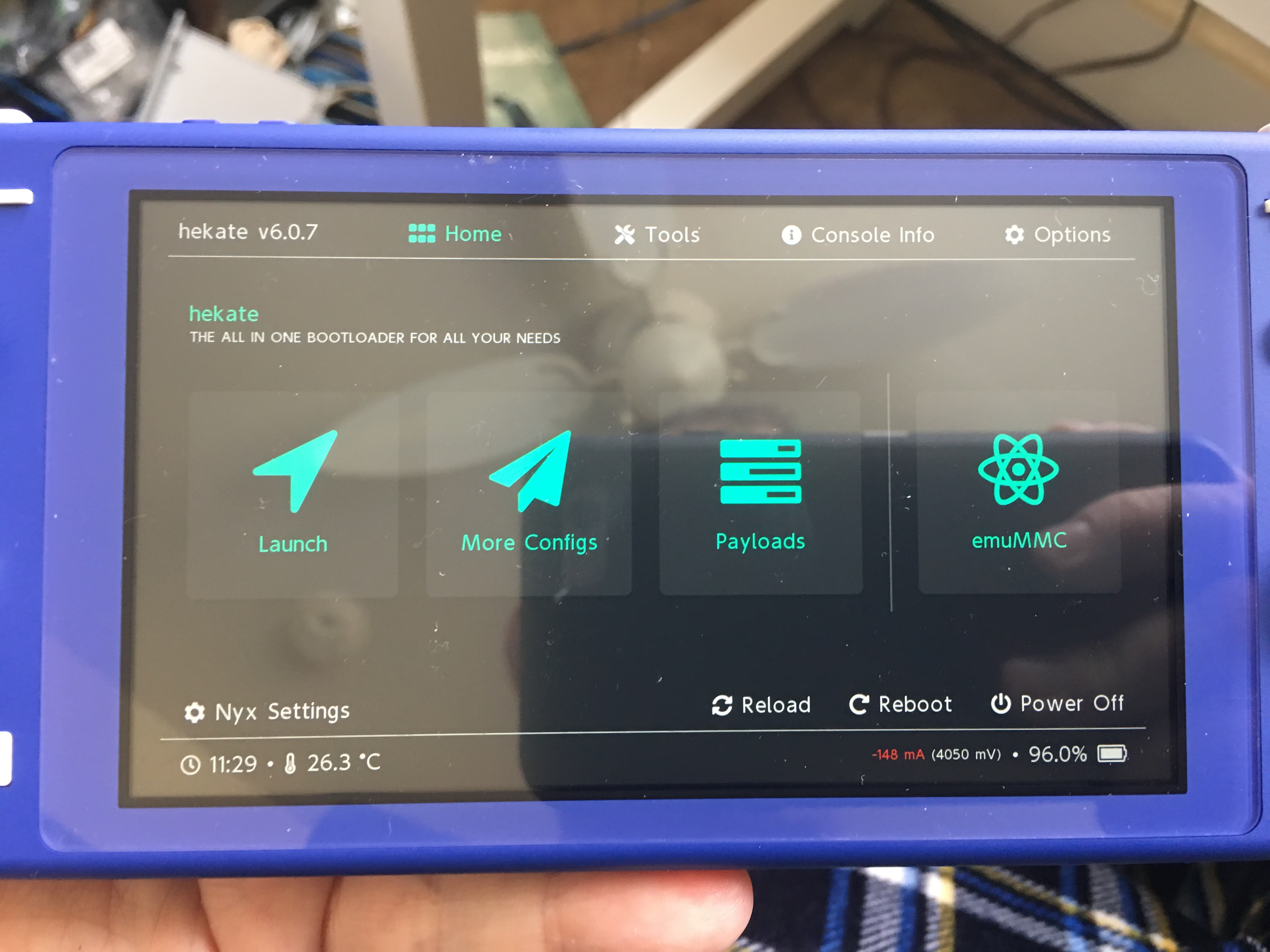

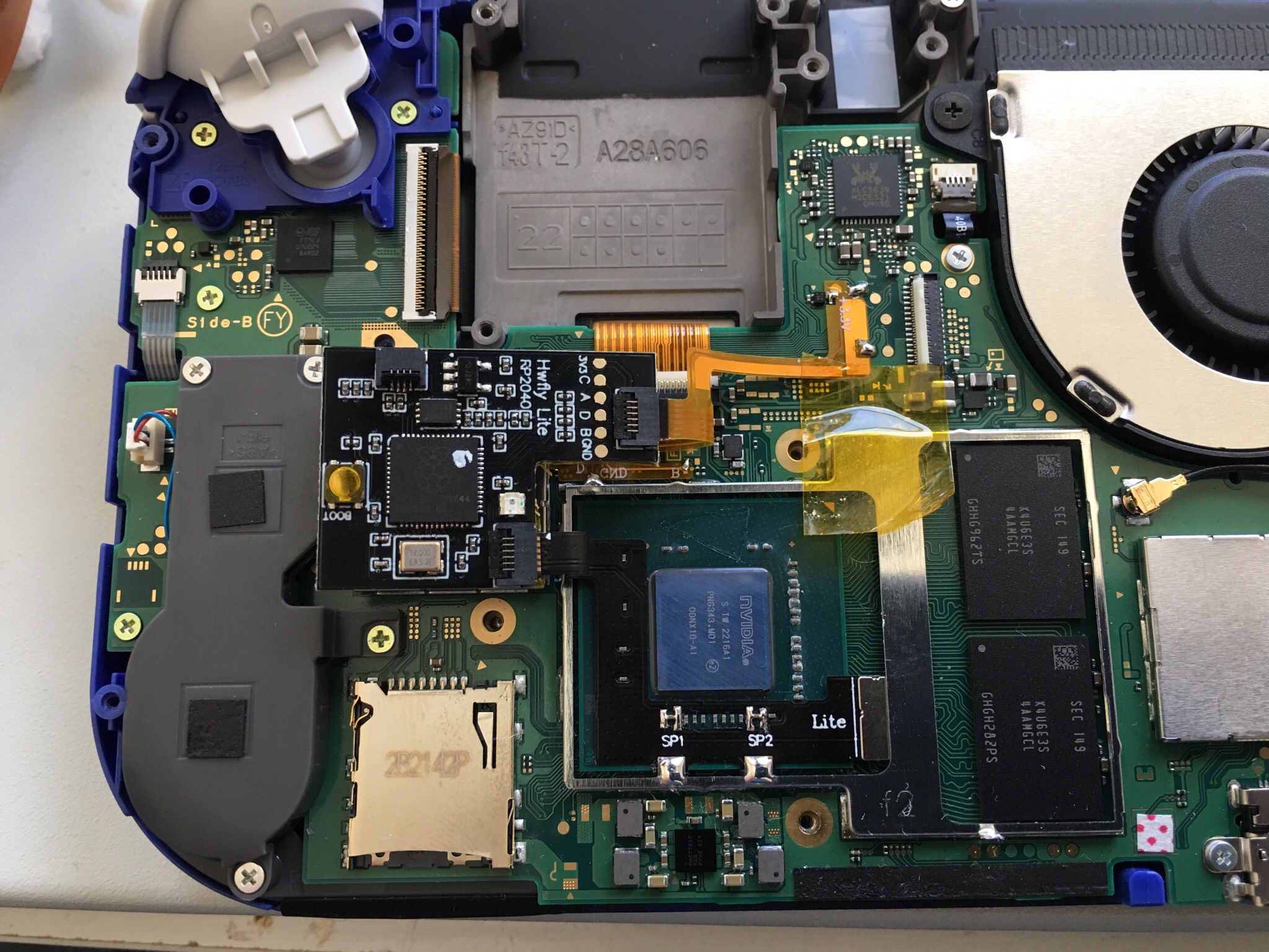

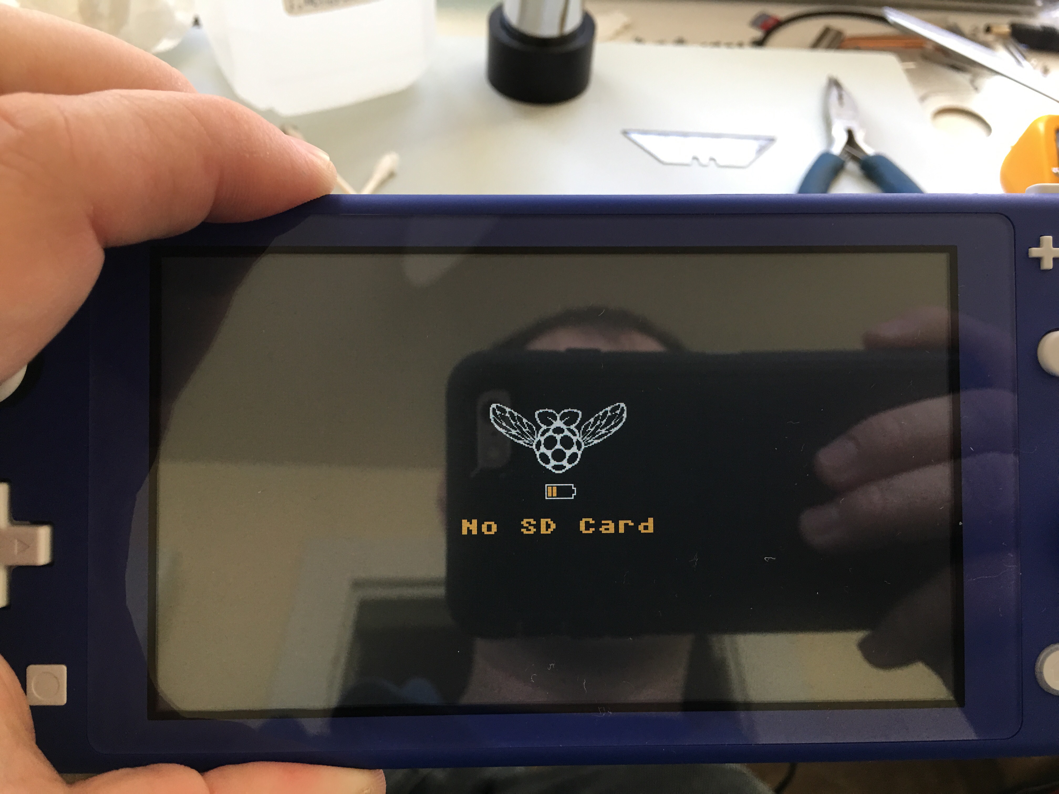

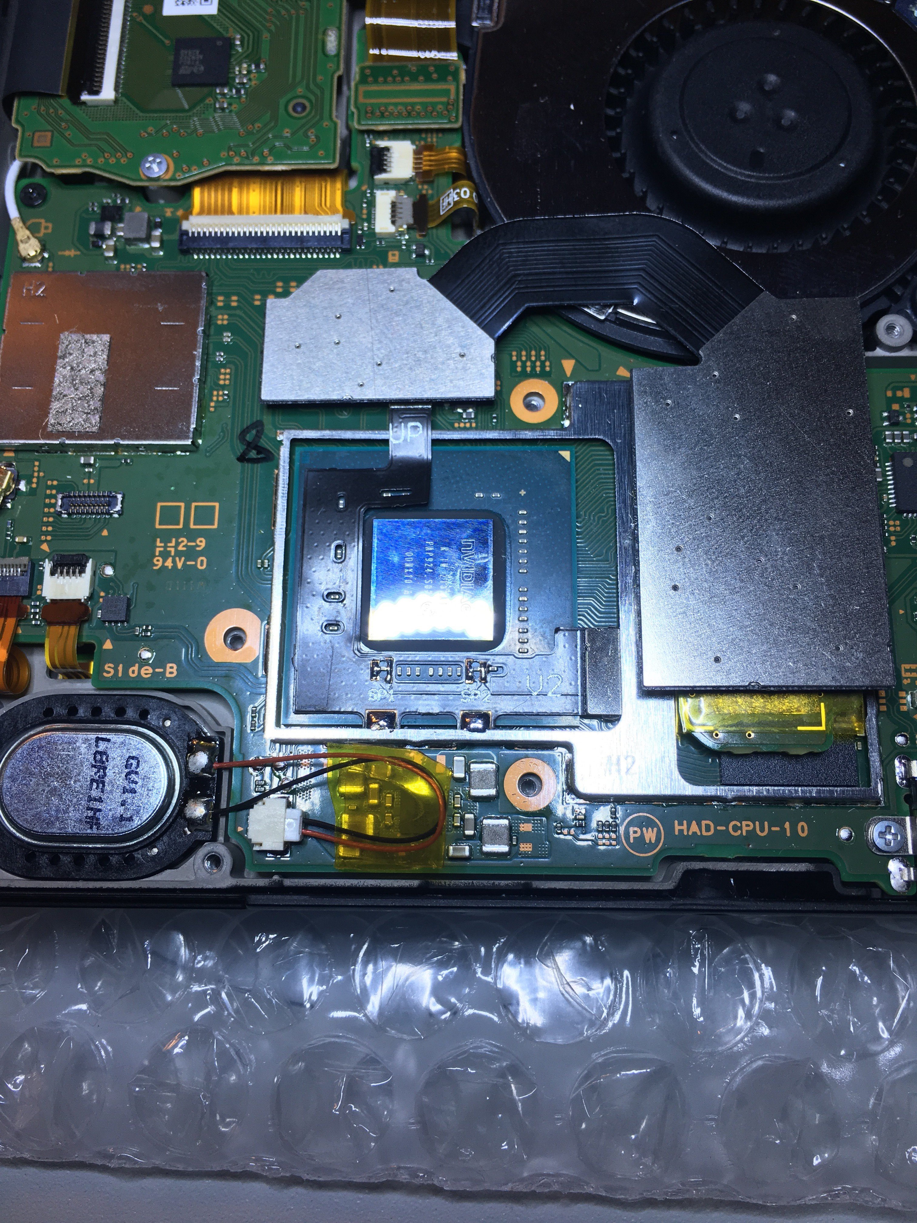

Here are some images of the Lite with a hwfly lite installed running picofly 2.73:
Here are some images of the Mariko V2 with hwfly core installed running picofly 2.73:
Glitching works quite well on both and after the first learning process, glitching usually takes less than 3 seconds. Thank you again for your hard work!
