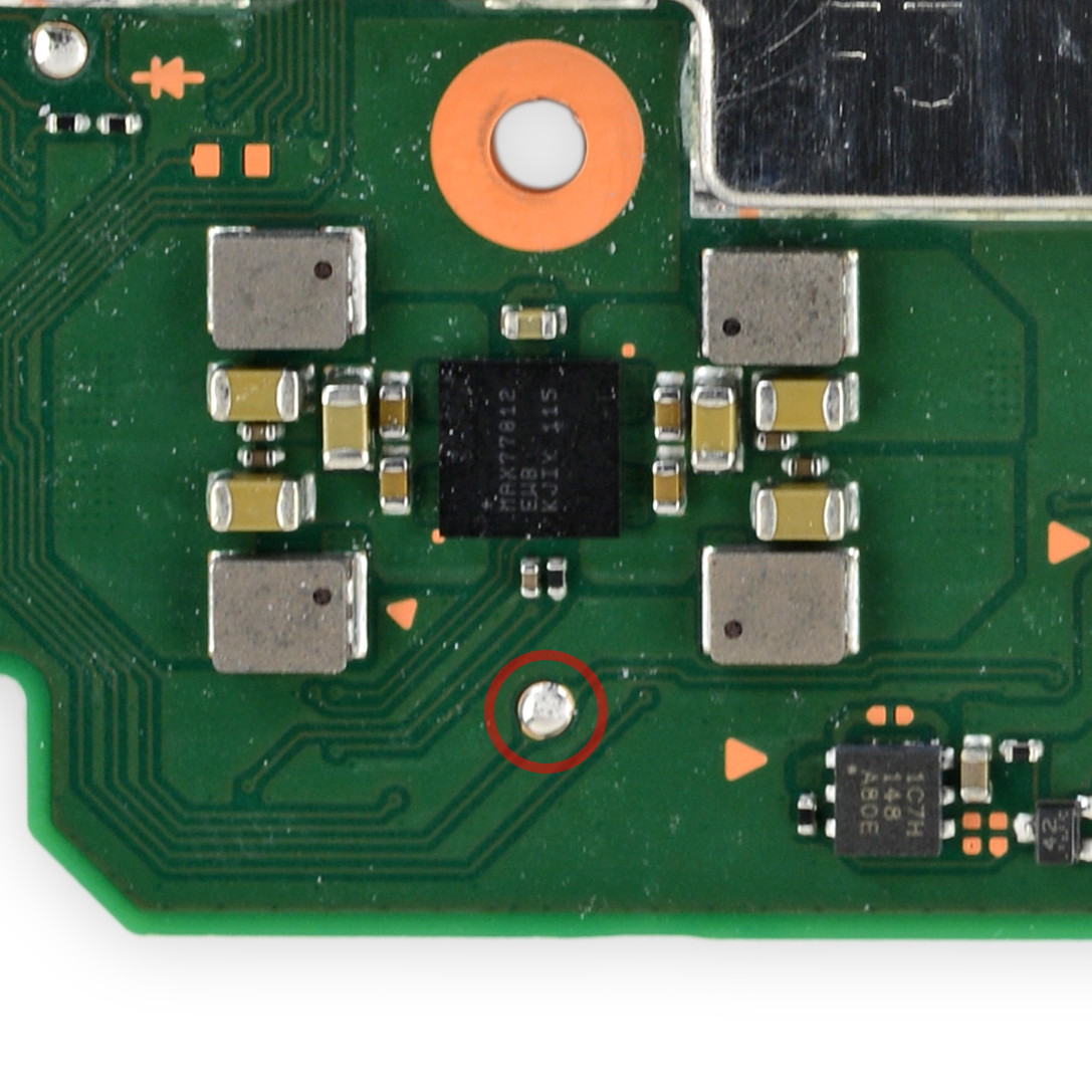

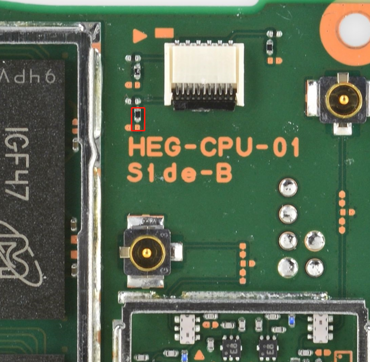

Hello. Is there a way to turn on an OLED board by shorting the power pins' slot? I got one that I think is alive and would like to get it picoflyed.
this is the test pad for the power button on the oled pcb. you can short it to the screw hole above with a pair of tweezers to turn the console on and off.
Shorting this resistor to ground should also do the trick.

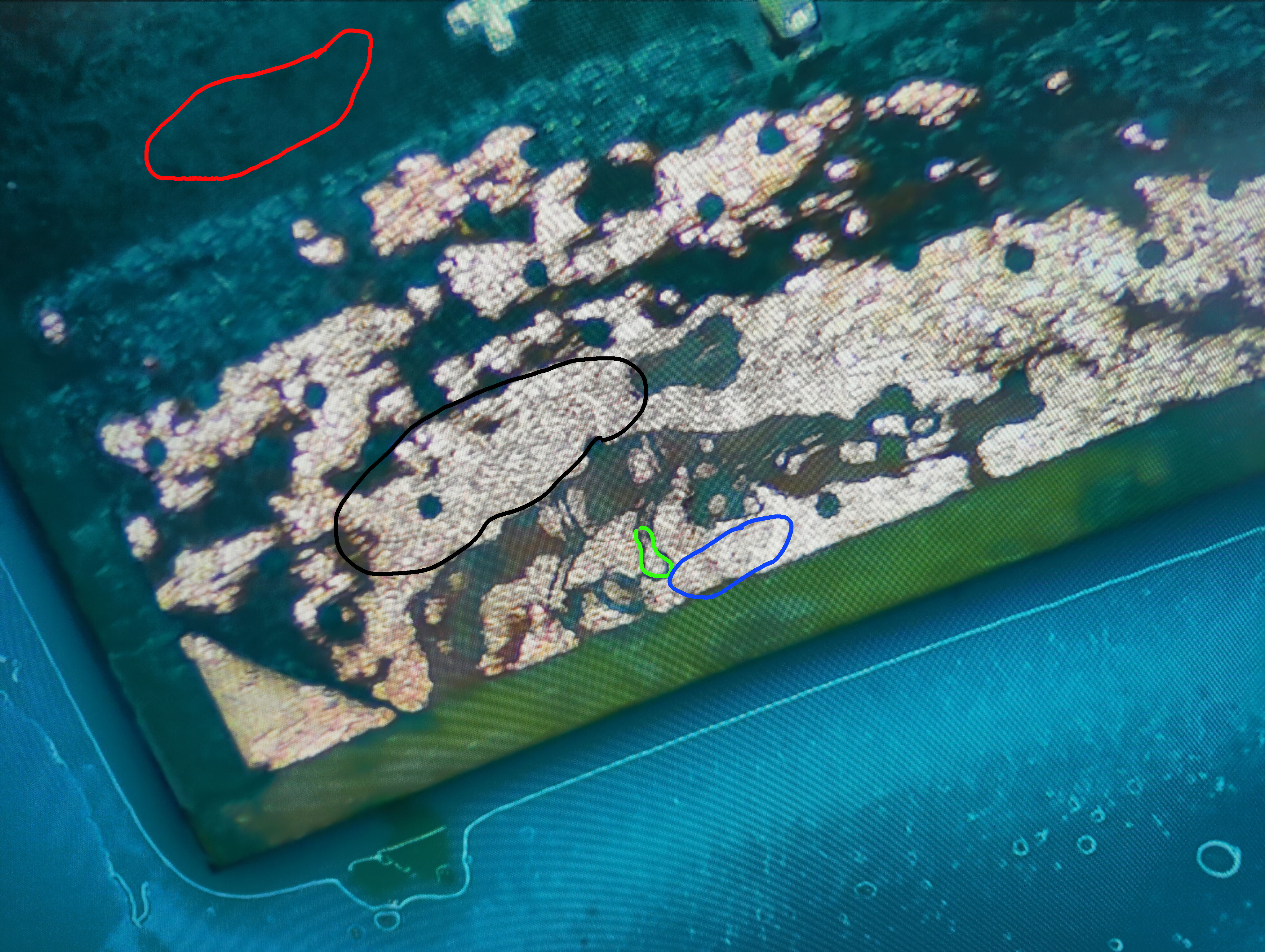

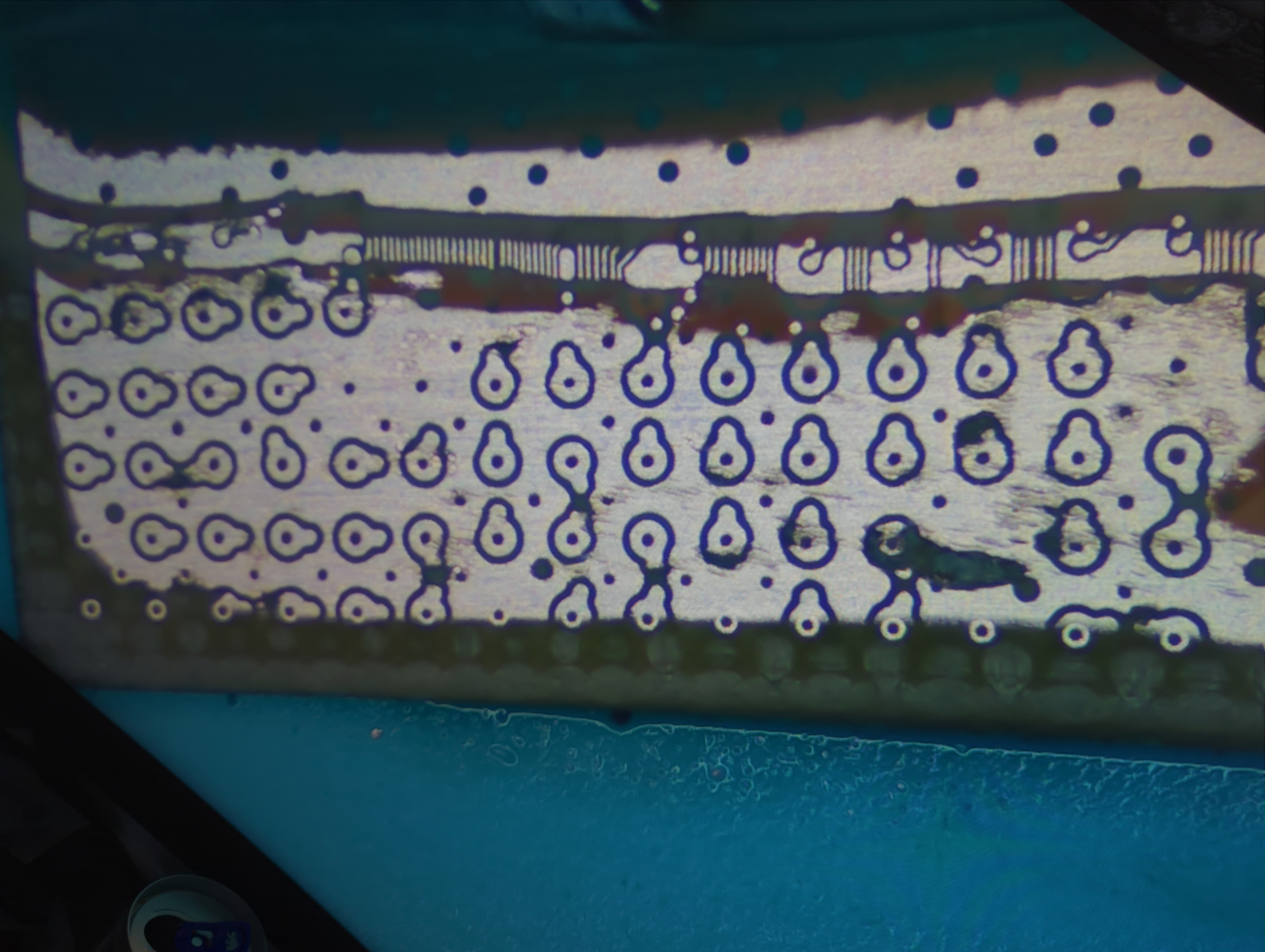

ur gonna have to try to find the original traces it was connected to , so in other words ur gonna have to slowley scratch of the top layers of the apu to find the existing layers
but im pretty sure this is gonna be impossible , give me a sec im gonna show u a picture why
i took a defective Apu from a v2 its the same as on the oled and grinded the layers down fast so u can see what u would be dealing with and why this is pretty much not possible for u even i would try it cause its a wast of time and effort
red top layer (Uvmask)
Black second layer ground
third layer is pcb material
Blue fourth layer ground
green via in forth layer
More of the fourth layer
img_20230722_204140_hdr-jpg.384507
this is the sixth layer after that they appear to go to the solderjoints under the apu
You are very informative. Thanks for doing this for me as I would not have accepted this was beyond my scope without the pictures. Guess I will try again on a different switch.

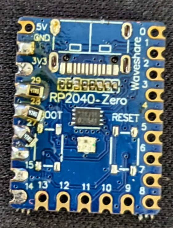

flashed a rp2040 w/ picofly and installed it, it boots :) but **= error still happens a little more rarely now.
I got rid of the FPCB that connects 3.3v, clk, cmd etc. to a ribbon cable as i do not need it anymore.
Booted the Switch about 60 times, 2 times the LED codes showed again. I missed the first LED code but the second one was **= which is 'No eMMC block 1 read (should not happen)' which is one of the two codes I got before.
I have a feeling/I kinda hope it is just the wires I'm using, my wires are thinner than recommended and they are enameled/magnet wire so i wouldn't be surprised if i like, tapped the length of a wire with my iron by accident and it is shorting with something.
I'm using the same 38AWG wire all points including the 3.3v and ground, I am going to replace them with 30AWG once I receive it. Is 38AWG too thin to use for these lines, even temporarily? I will undo them and wait until I get the proper wire if so.
I was having that 2002-3539 error on OFW after initial install, I doubt it's related but I don't wanna fully rule it out. It thankfully hasn't happened since I swapped DAT0 adapters and leaving the Switch on overnight in-game twice to confirm that the issue is gone for 'good'. Could it have possibly corrupted the eMMC block 1? It boots into OFW no problem with or without the modchip so idk. I have backups of BOOT0/1. eMMC and keys ofc.
Attached pictures of my dirty yet prepared rp2040 w/ resistors, the switch itself and 'install' pictures. The 'install' picture was taken after first boot, after that I desoldered everything and routed all the wires properly and got rid of slack + reflowed the points on the RP2040 to get rid of the cold joints. I used magnet/enameled copper wire, so they should be insulated but I am going to replace them anyways when I receive 36AWG and 30AWG wire in the mail. I will take new pictures of the install at that point as well. I put a layer of electrical tape over the RAM part of the heat spreader for the underside of the RP2040 and layered Kapton tape on the underside of the metal shielding that would touch the top of the RP2040 to prevent shorts.
Thanks for reading :)

ofw can be unstable because of the 47ohm resistors on dat0/cmd, which is why many of us use 100 ohm instead. if you dont have any 100ohm resistors you can add another 47ohm to achieve 47+47=94ohm
added another 47ohm resistor onto dat0 and cmd, was initially able to boot around 50 times without fail but after screwing the shield onto the back i got the **= error again. unscrewed it, powered the switch back on, booted no problem. kept the shield off, kept on rebooting for a while to test and eventually got the **= error again. simply powering off the switch and rebooting is enough to make the chip correctly boot again. In other cases, it requires like 2 reboots.
at this point im almost certain its wire interference/shorting related as adding the resistors didn't fix it but it did seem to help. I did however use the one kind of wire that could cause shorts that are practically invisible so im leaning towards that being the culprit
ordered non-enameled 'proper' (im sure theres a better term) 36awg and 30awg wire, gonna replace the dat0 wire (as it seems related to dat0 ofc) and 3.3v/ground wires as soon as i can and see if that gets rid of the problem for good

Try to touch/rub all solder point on pico with finger, any sharp? protude? thats will make a short if you screw the shield.
