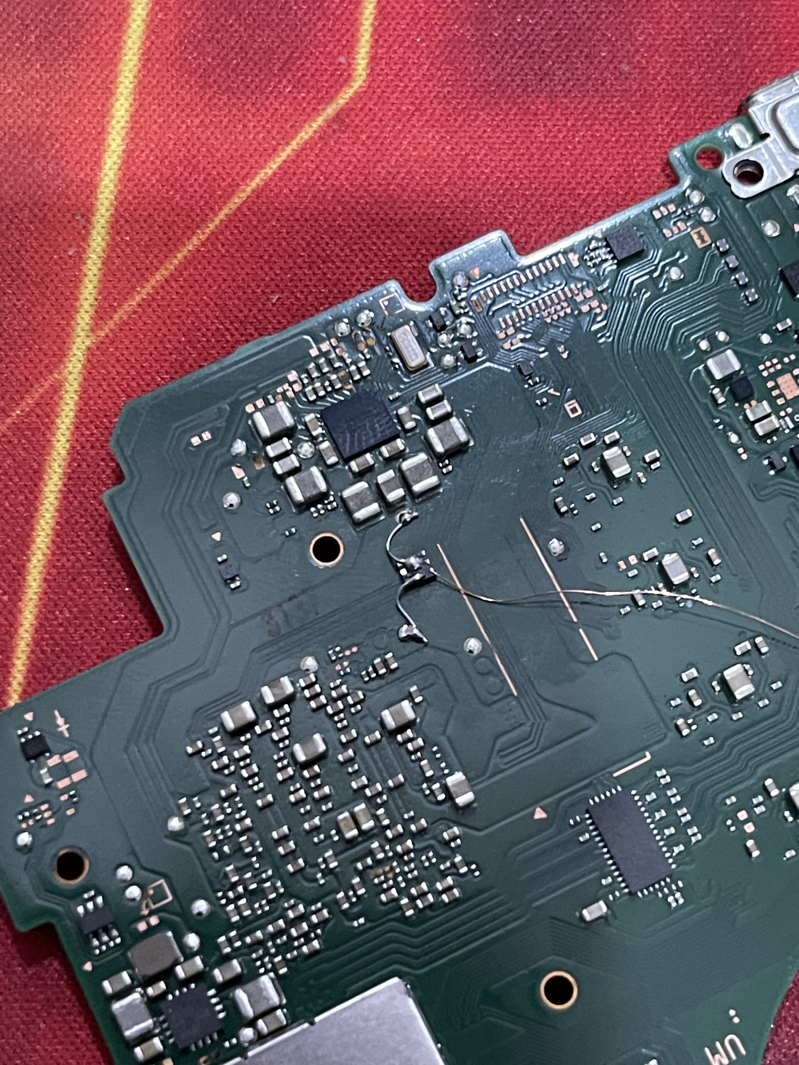

Here's two easier/safer mosfet positions on the back of the motherboard for the Switch Lite. They're both working fine. I moved the rp2040-zero LED to the home button led while i was at it just to test. Looks pretty neat, but not very useful.
I will personally not be using these points since the added time it takes to remove the motherboard makes it not really worth it for me, but I guess they might be helpful for people with less experience who are afraid of the apu caps.
I believe the big pad super easy position on the back for the OLED that I posted about before should be the standard recommendation though; it is far superior to all other locations (the pads are even pre-tinned!) and the motherboard has to be removed anyway.
Thanks, more choice, but I prefer soldering in to the cap, it easy to melt than this big via, because the heat is hard to concentrate to the large surface of the via and a cold point is easy to happen.
