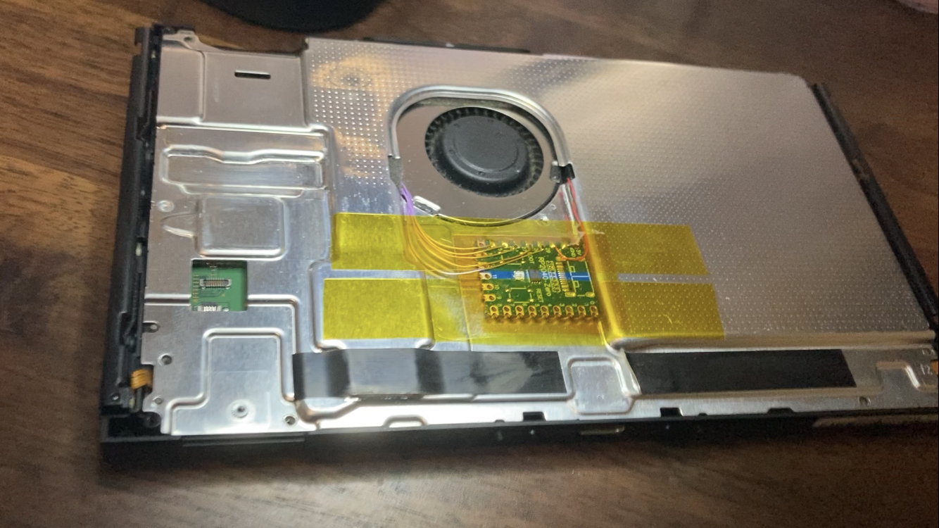

Ldo is out in every install . I'm cutting the shield becouse of the doble sidded tape i'm using is to thick You know cuba lol
Yeah I understand bro, sometimes it's difficult to get simple supplies like that and it's really frustrating.
But, if you don't cut the shield you could just use a larger piece of kapton to cover the pico and attach it to the shield in one shot and it will not move because there is no space anymore once the plastic cover is placed on top of it.
*Edit: see abal1000x comment below, he explains it very well.
Hey guys i want to impruve My work for future consoles . this uis my latest install. Any advice??
Just share an opinion, subjective taste, not objectively true.
I prefer not cutting the shield. Only bend the shield, to accomodate the picofly.
The reason:
1. More rugged, if someone shake the device so hard, the pico will be intact in there, since there is a shield locking it.
2. Better temp, since the shield will suck the heat up. For example if its put upon the car dashboard.
3. Better EM shield. Which i think is not so usable. Maybe someone put the switch around big coil which is almost an impossible scenario.

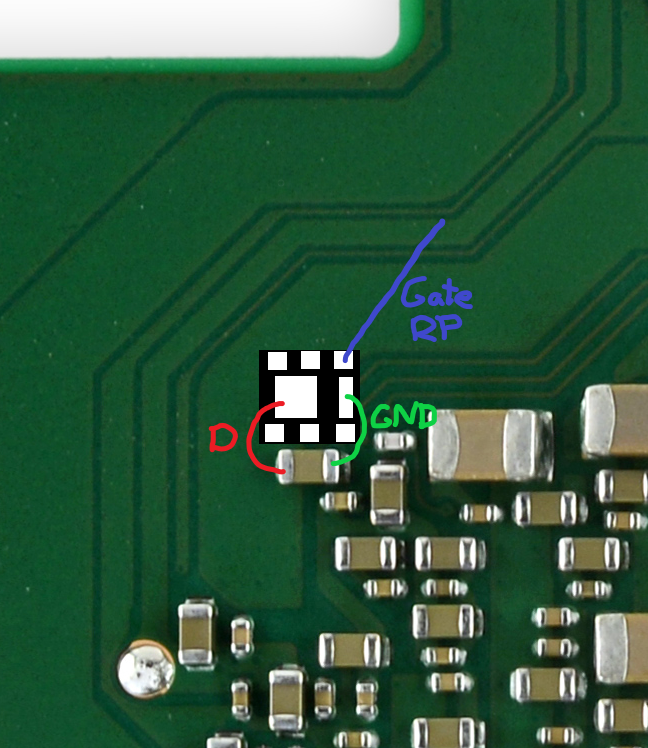

I wanted to just clarify how it was meant to be installed here, so I drew it up in paint again.
Looking at the pictures, it seems to be like this, but can you please confirm? Is the solder avoiding the corner pads or you're just soldering over them in a straight line?
Reactions: frozenboy
You're always so super helpful with your findings, so many thanks in general!
Yes its correct.
In my opinion its easier to line the GND first then the D.
Yes its correct.
Ok that makes a lot of sense, and to clarify, do you avoid the corner pads? Like my drawing arcs away to avoid them, but from the pictures it almost looks like it's a straight line through them.
No need to avoid them, solder straight through just be careful not to bridge the separate lines, so same as Abal did in his installations

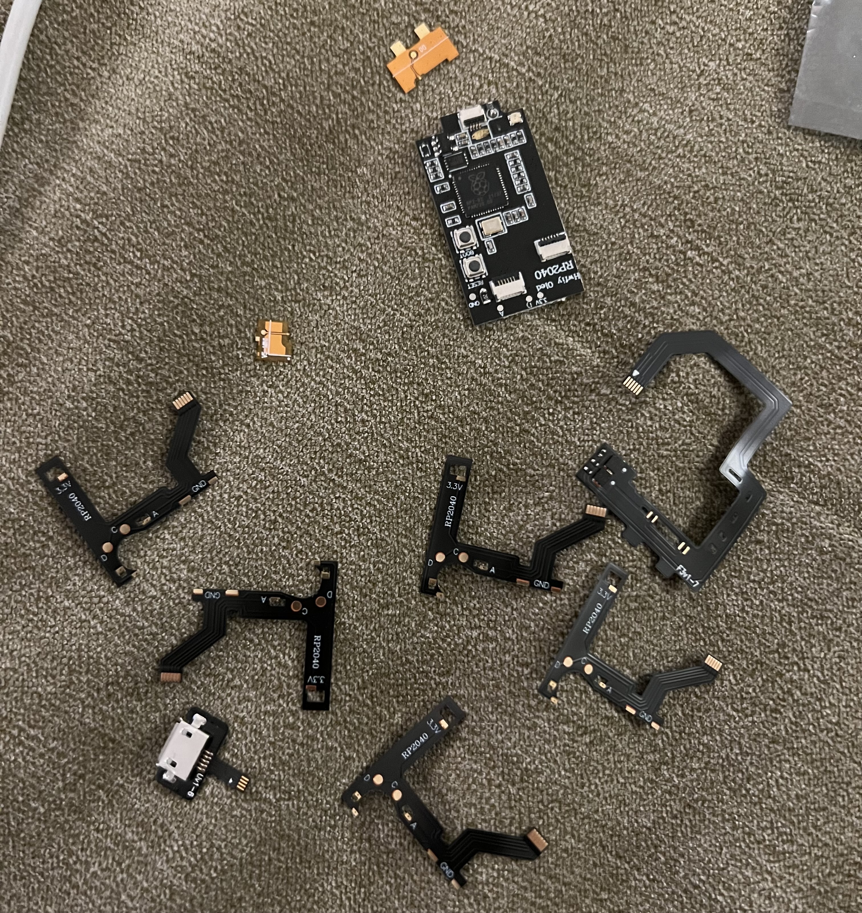

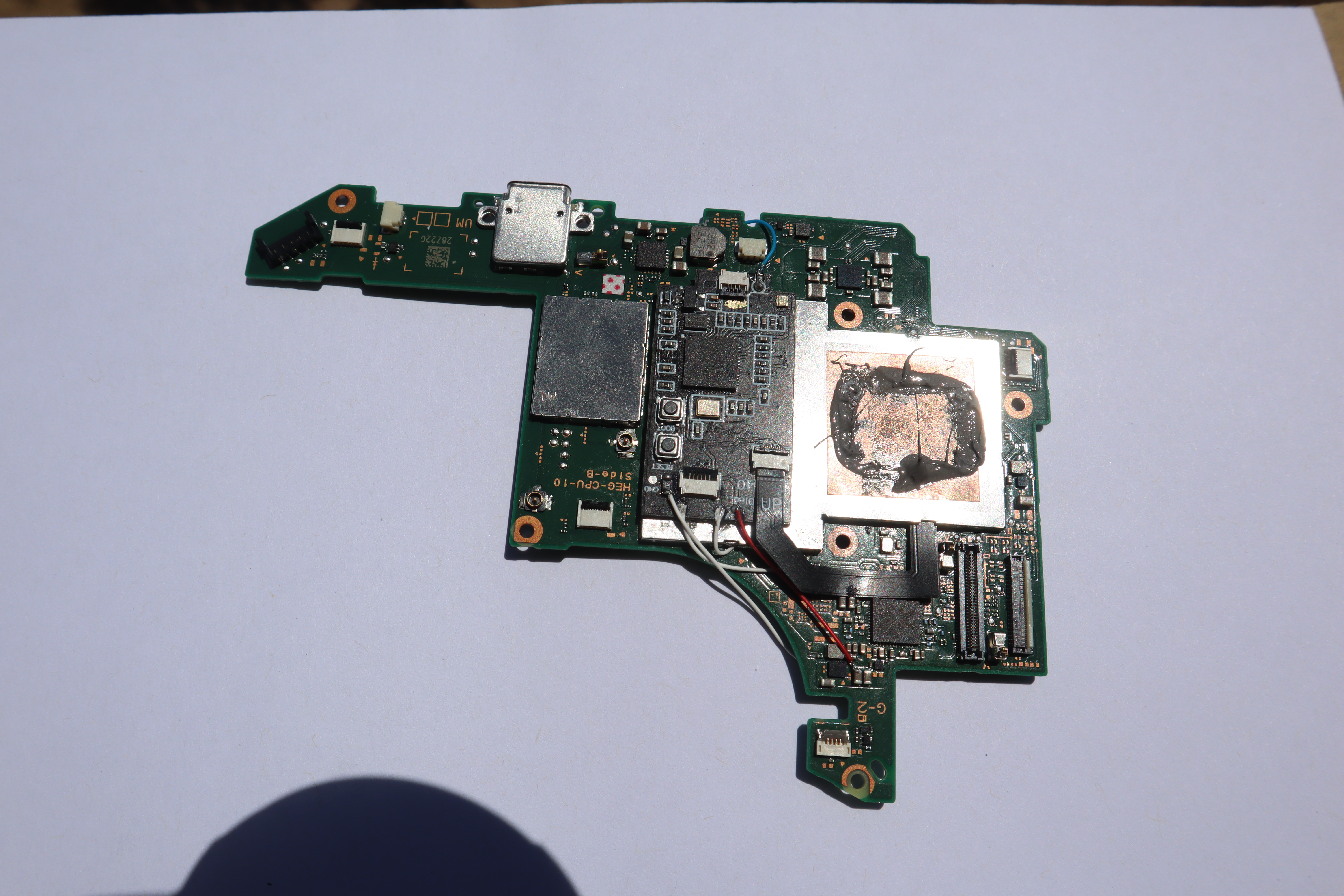

(I am cross-posting from the AIO thread to here since this thread seems to have more activity. This time with pics):
Hey all. Hoping I can get some help here.
First time Switch modchip installation here, but I managed to install the Hwfly RP2040 modchip onto my OLED this weekend. I was very excited to see the "No SD Card" screen and thought things were going to be fine from here on out. Hekate boots up fine.
However, any attempts at interacting with the emmc are failing, and if I attempt to Reboot -> OFW, I get the purple screen.
I've been trying to search the forums here and, if I'm understanding correctly, it seems like the most likely cause is a bad point A / CMD connection (or blown resistor). I am attaching pics of the modchip before installation as well as some shots of my motherboard and Dat0 connection.
My questions are:
  • Is there anything obviously wrong here? I'd be willing to give any suggestions a try, but I'm also starting to feel a bit out of my depth here, thus:
  • Would any modders on this forum be interested in fixing / completing this modchip installation? Ideally US-based, but I'd ship to anywhere if you are confident that you could get this resolved.
Cheers, and thanks in advance.
