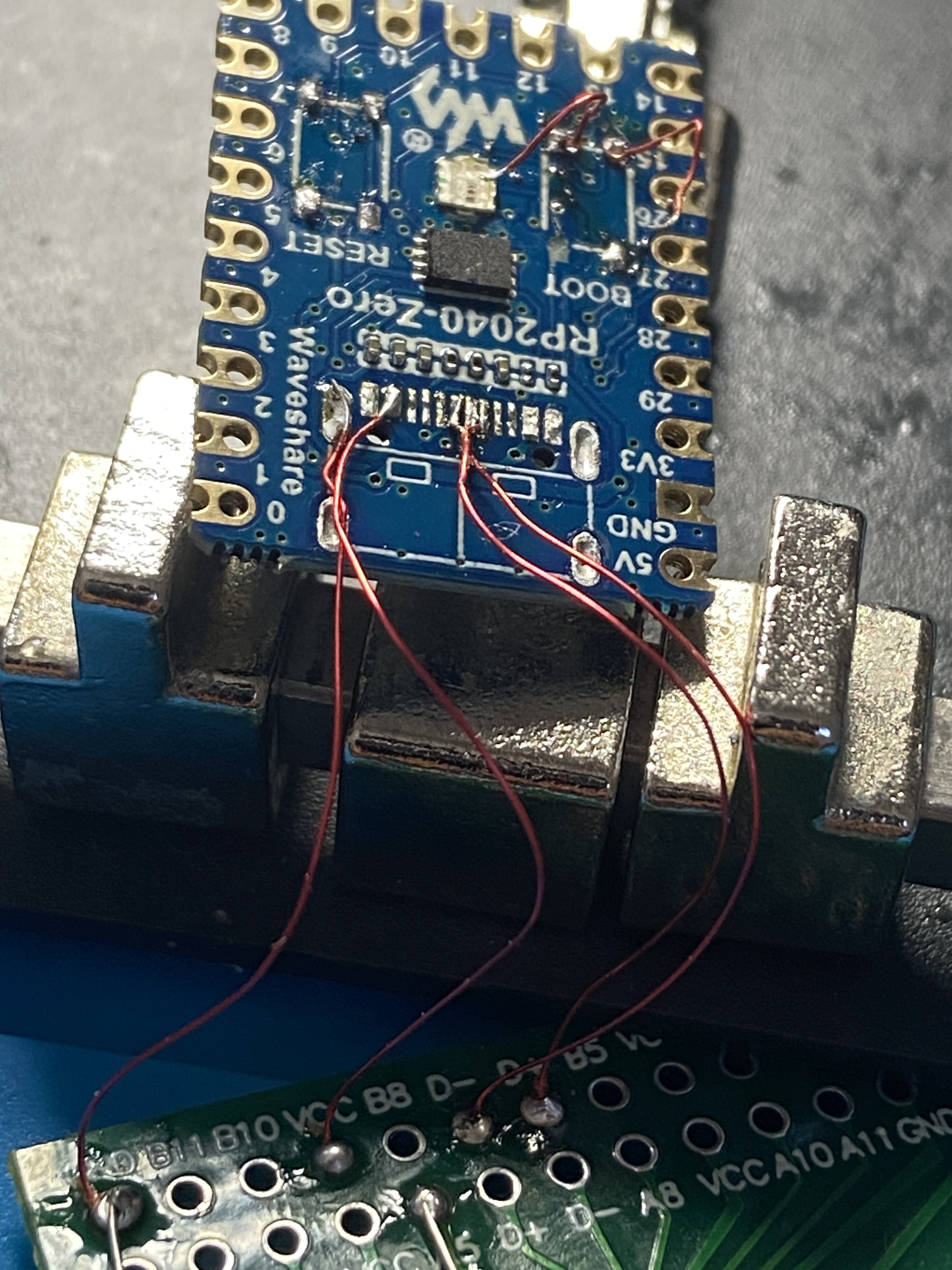

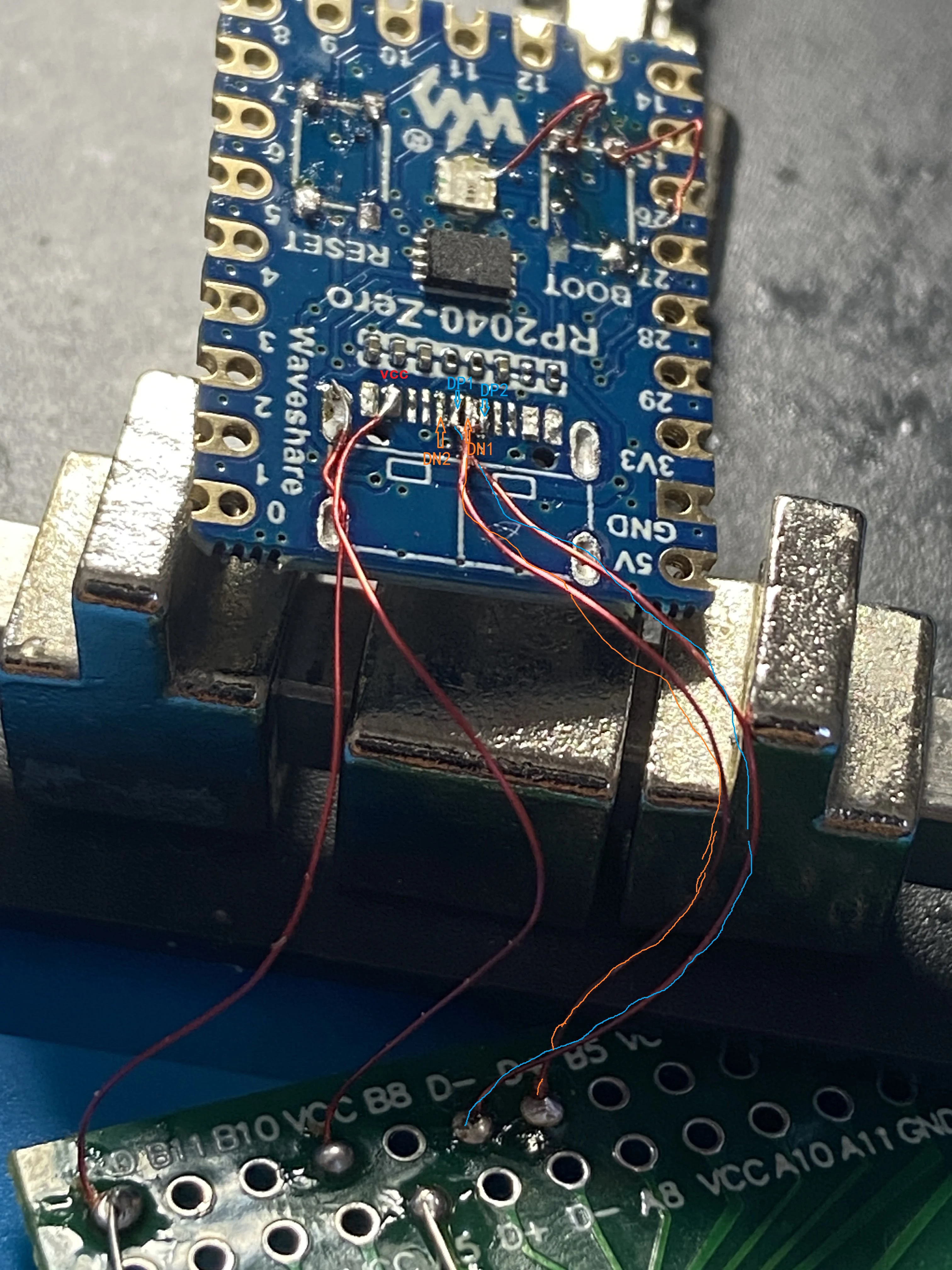

Hello. I removed the buttons and USB before flashing, duh.
I resoldered the USB points but I always get multiple flashes (like being plugged in without boot button pushed).
Could not boot it into flashing mode. How can I simulate the boot button being pushed with wires? Thanks.
I do believe you have a wrong connection from you breakout board wiring.
And make sure you have a clean soldering on the rp2040 side.(seems having bridge from the right jumper cable).
If I were you, I would use DN2 & DP2 which make more space for solder and less chance bridging near by

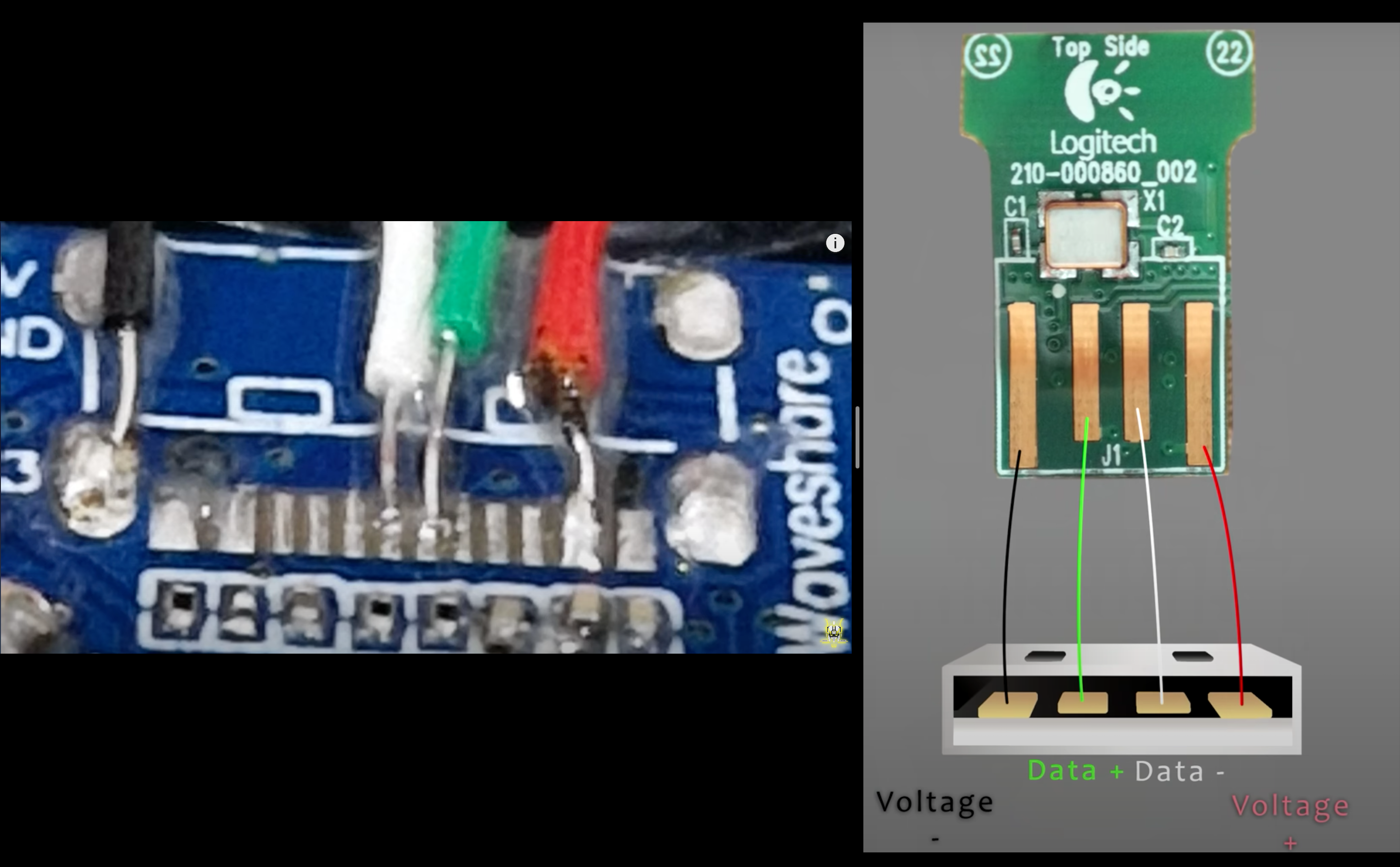

Did you figure out the pinouts for the Pico USB-C pads? Because I remember from before when I soldered a ZIF connector and make a ribbon cable with a USB-C i discovered they aren't the standard USB-C pinout.

search for rp2040-zero datasheet and you should find the c-port printout

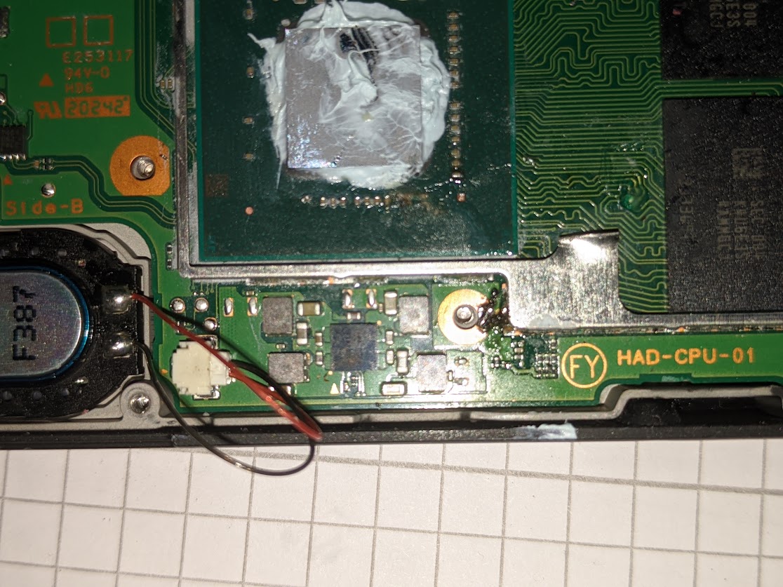

Resistance on the right cap was 20.3ohms after installation.
Is it really fine to blast the APU with hot air? 350C should be fine right?
And pictures are coming shortly as I currently dont have the switch with me.
Alright I removed everything that wasnt stock(so my mosfet board and all the wires going to the rp2040), stole a cap from a non working rp2040, attached it and it boots again! Im pretty tired for today so I will propably try to redo everything tomorrow after work but I dont think I will be touching that left capacitor again. Also I attempted to secure the right cap wire with super glue(dumb idea, I know) which is why that area looks so dirty. Any advice on getting it off without further making this poor switch suffer?
Thanks, I thought I messed up the connections. I loosely related on "AlignGames" diagram when he attempted this.
Alright I removed everything that wasnt stock(so my mosfet board and all the wires going to the rp2040), stole a cap from a non working rp2040, attached it and it boots again! Im pretty tired for today so I will propably try to redo everything tomorrow after work but I dont think I will be touching that left capacitor again. Also I attempted to secure the right cap wire with super glue(dumb idea, I know) which is why that area looks so dirty. Any advice on getting it off without further making this poor switch suffer?View attachment 378329
Acetone should disolve super glue. You need to soak the glue so maybe keeping a cotton swab with acetone on top of the area for a few minutes will do the trick.
In this case however, I think you best option is to still to use the left cap. Just so you know Switch works fine without those caps and there are people here who do this mod by always removing the caps and soldering directly to the pads.
I am not advising that you remove the cap, just letting you know that it works without it.

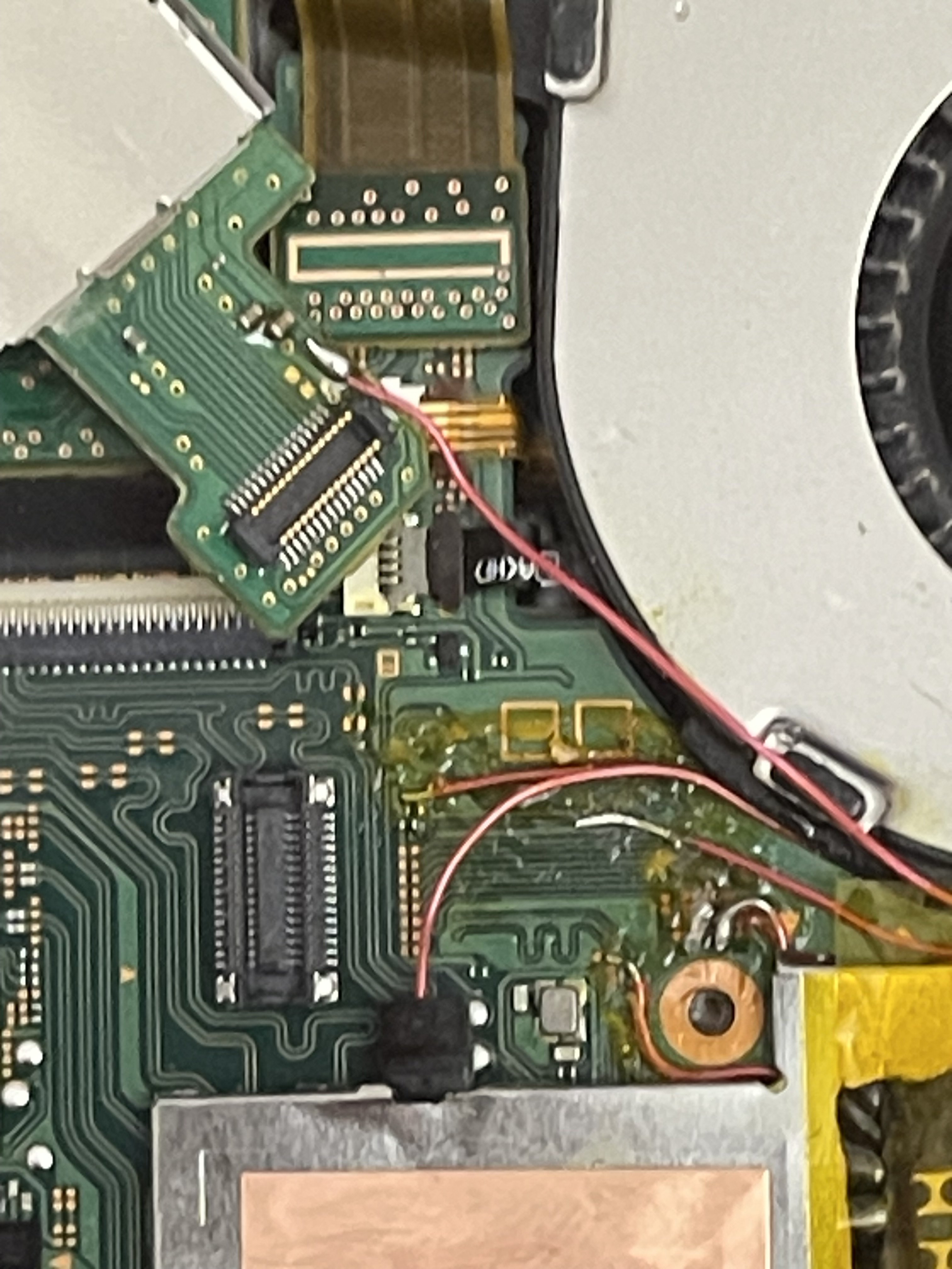

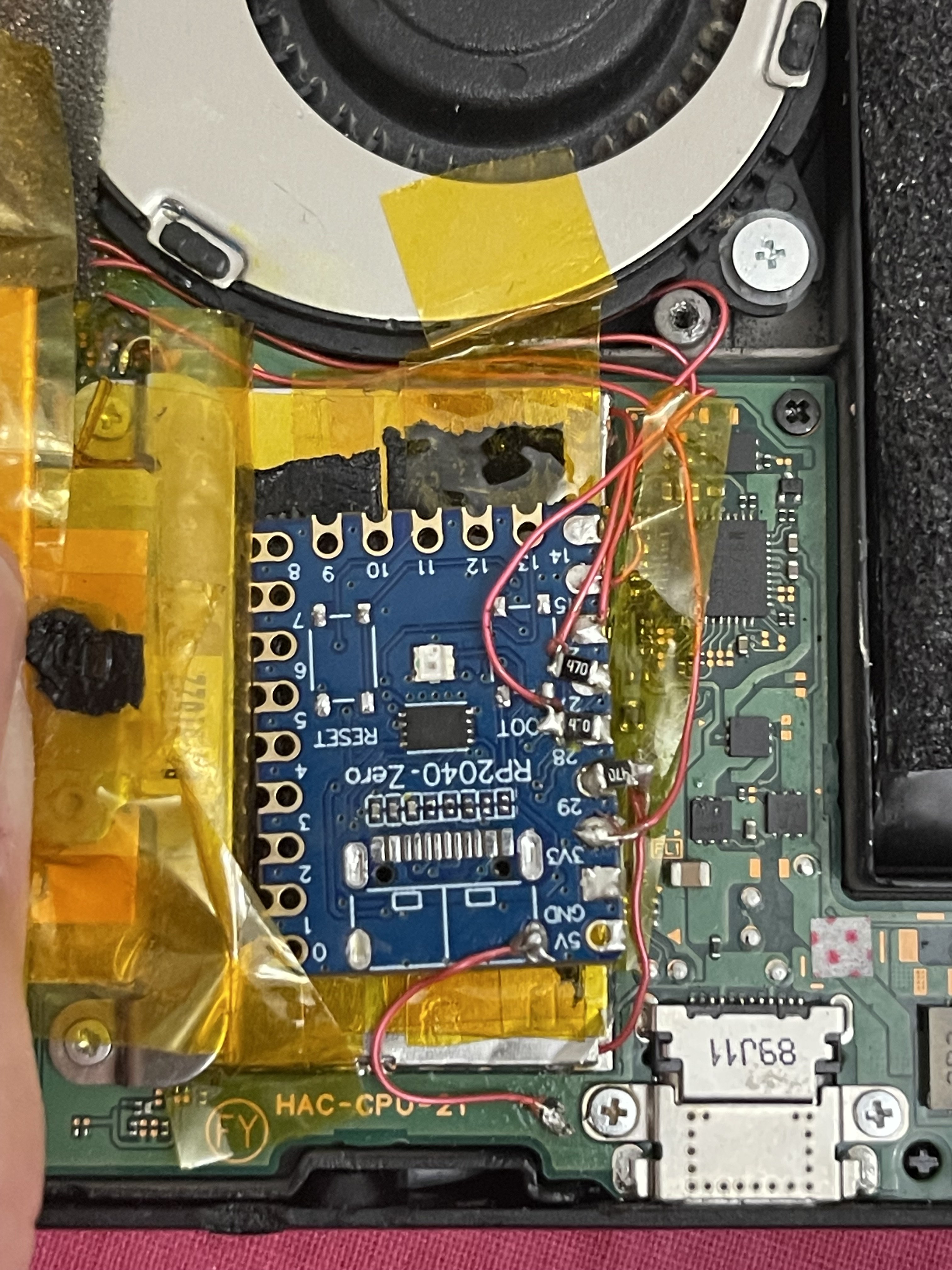

Hi! After reading and reading I have decided to do my Erista V1. I have done all the installation but the Nintendo only start in stock. Picofly flash blue, after that flash green but Nintendo screen appear. What should I test?
1st you should post pictures of all solder points and a video of picofly booting so we can see whats going on. Afterwards someone here will eventually figure out what the problem might be.
Also, what version of firmware did you flash on pico?
Ok, I attach the photo/video. In addition, I took the 3,3V from nand because I ripped the 3,3v capacitor and I wanted avoid do more damage in the area. The version of firmware is fw_2.74.uf2.
