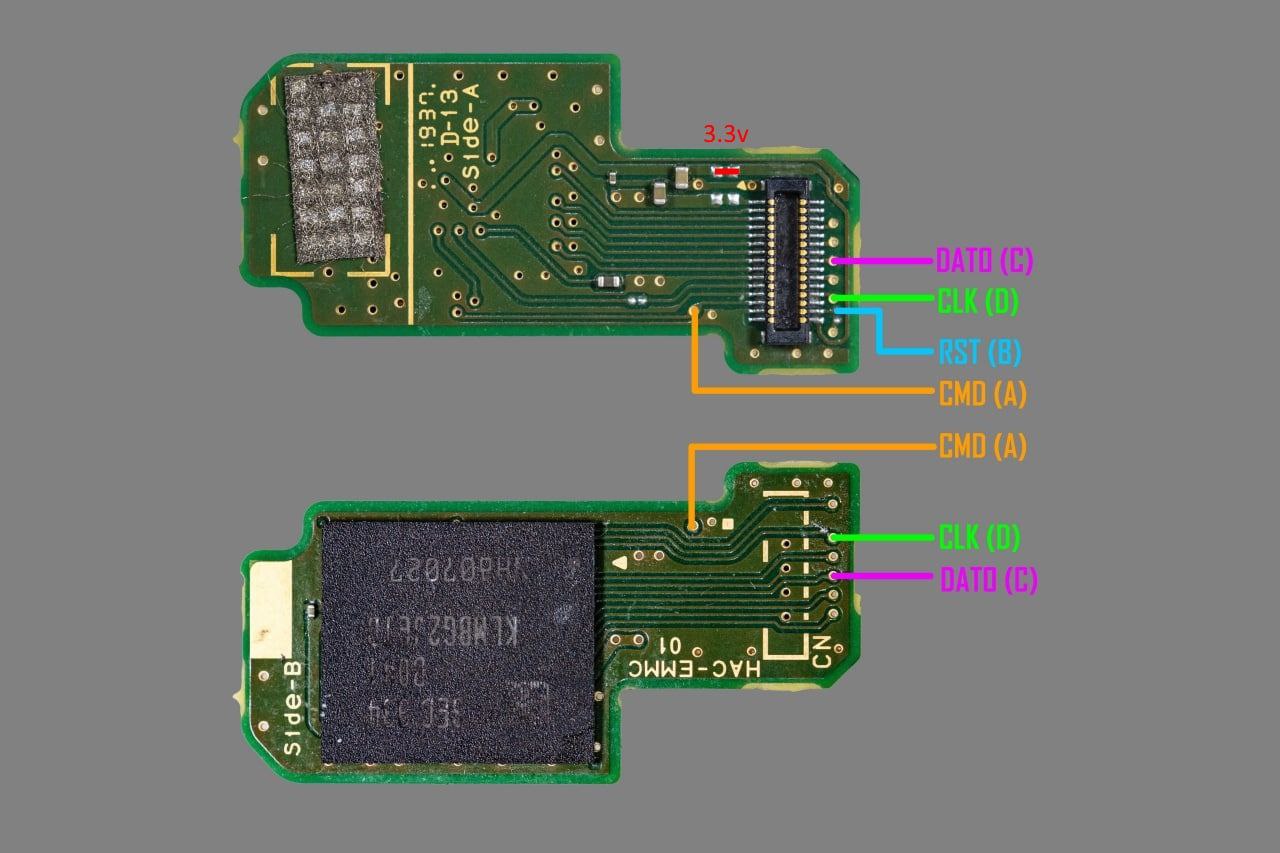

I found long press VOL- & VOL+ boot original HOS
Can play games
I use this diagram

What thickness do you recommend? 0.1mm, 0.5mm?
0.1mm works great for this size soldering. Do make sure that your soldering tip is the right size, most people try to do this type of soldering work with an iron tip that is WAY too big, and solder that is awful for the task. Use some thin lead or bismuth solder, something with a low enough melting point that you won't risk knocking other components off the board if you're not super good. Your solder should melt low enough that you can easily solder non-ground points at 280-300 Celsius. Invest in paste or no-clean flux.

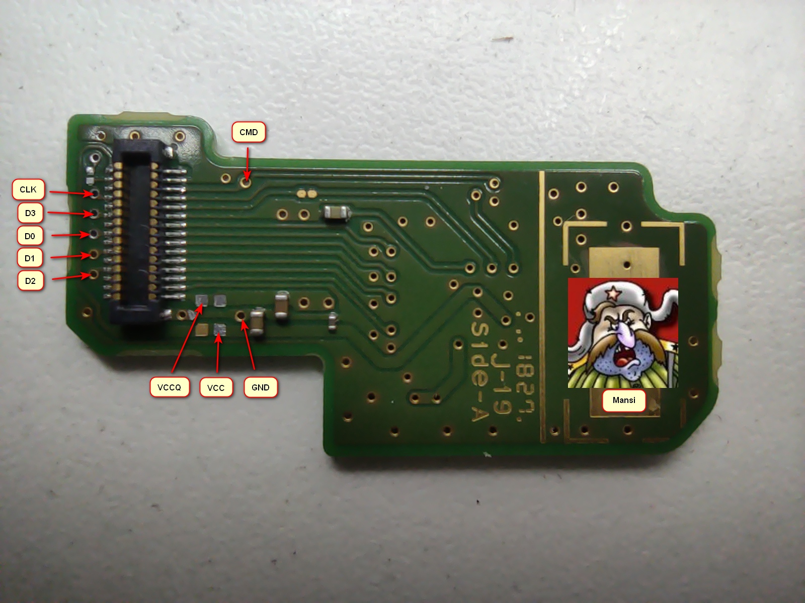

Can play games
I use this diagram
