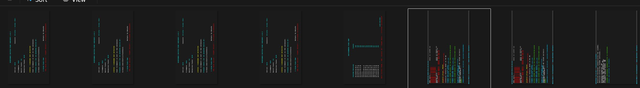

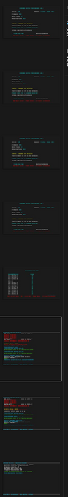

Got a busted V1 Switch from a buddy of mine... not sure what he did, but fellas, it's a doozy. Think it may be cooked.
I get the black-and-white Nintendo boot screen, then just a black abyss when trying to boot into Stock FW. It is completely black when trying to use Hekate to boot into CFW."
Here is some screen shots.

I don't think even a literate mouse can read that. Try separating the screenshots and uploading them to imgur. Anyway, modern Hekate does NOT look like that, so I imagine this is malformed on purpose to force a download of a potential infostealer malware disguised as an image. The Guy Fawkes mask (a la Anonymous, the so-called 'noble' hacking group), along with the activity of your account, indicate a hacked account.
Did you merge all of your screenshots into one tall png? Because the text in them is quite unreadable at least on my end?
No version of Hekate has ever been styled like any of those screenshots. This is likely a phishing or hacking attempt. Considering the typo in the title, likely a script kiddie.
Yeah, I did that.

Yeah, Google Lens is saying it isn't an image. Some hacking is going on here.
Sorry, I had to covert .bmp to .JPG.... not sure why converter put the images in negative.

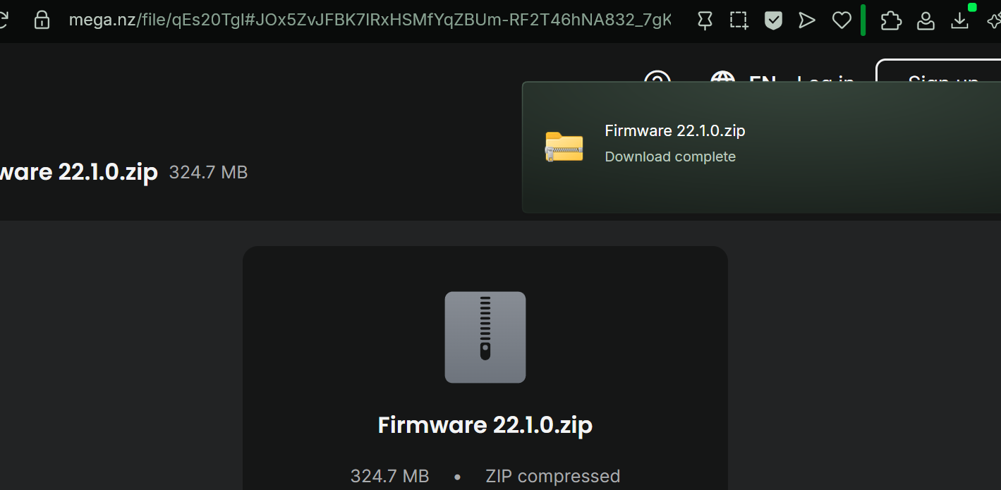

... I don't think so. but I'll grab a new V22.1 FW.
grabed another... jic

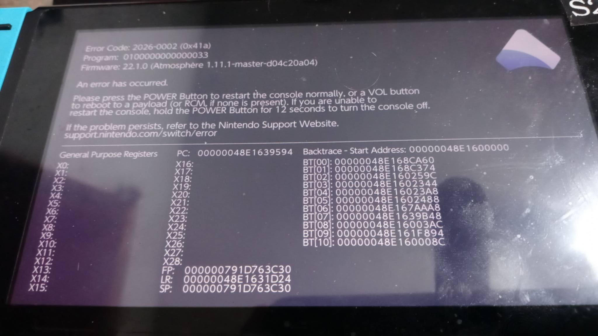

Huge progress.
Here is the crash logs.

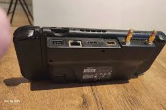

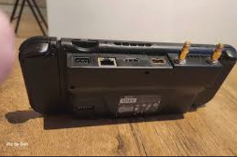

If your unit looks like the picture below, then you have yourself a dev unit.
Anything else is just a botched attempt to put the dev unit firmware on a production unit.
If that is the case, then you need to rebuild the nand and re-sign it with the shit that Sthetix releases.
The console keys are linked to your console so you can dump them with lockpick_rcm.
Actually, that's an SDEV unit, but EDEV units exist, and are indistinguishable from normal Switch consoles except that they say "EDEV" somewhere on the back of the console.

If you have these folders on your sd card delete them.
/atmosphere/contents/0100000000000033
/atmosphere/contents/0100000000000014
Maybe you installed some patch, mod, sysmodule or similar that added that folder, which broke the es and audio process
Those are done by sys-patch for sigpatches. Don't tell them to remove stuff willy-nilly without actually researching it first. A quick Google search for both '0100000000000033' and '0100000000000014' brings up a result for sys-patch each, both from GBAtemp. At this point you're spreading misinformation.
Edit: Okay, '0100000000000014' is for sys-tune, made by the creators of sys-patch, so it's still a legit folder. If I am right, and this is indeed an EDEV unit, then sys-patch is expected to break booting atmosphere, and stock booting still won't work, so this isn't really progress.
But that's what atmosphere is crashing on. Maybe sys-patch is the issue. He can just test removing them
Uhh, I'm fairly certain you either didn't fully read or didn't understand my post (due to not reading the previous posts in this thread), but OP did say that their Switch won't boot at all, neither on CFW nor stock, without using sys-patch and the other stuff added, and this indicates that it is indeed a hardware-firmware mismatch, and thus a keys mismatch, as sys-patch goes by the firmware version and checks if the bytes match that firmware, and if they don't that is the screen you get. Broken firmware is another possibility, but they got their firmware from a legitimate source, obvious from a previous screenshot provided by OP.
