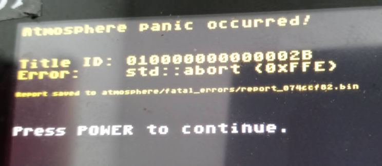

If your unit looks like the picture below, then you have yourself a dev unit.
Anything else is just a botched attempt to put the dev unit firmware on a production unit.
If that is the case, then you need to rebuild the nand and re-sign it with the shit that Sthetix releases.
The console keys are linked to your console so you can dump them with lockpick_rcm.
NO! it's not a devkit, Them are @Maq47's words not mine.
If you have these folders on your sd card delete them.
/atmosphere/contents/0100000000000033
/atmosphere/contents/0100000000000014
Maybe you installed some patch, mod, sysmodule or similar that added that folder, which broke the es and audio process
I don't have them folders.
Those are done by sys-patch for sigpatches. Don't tell them to remove stuff willy-nilly without actually researching it first. A quick Google search for both '0100000000000033' and '0100000000000014' brings up a result for sys-patch each, both from GBAtemp. At this point you're spreading misinformation.
Edit: Okay, '0100000000000014' is for sys-tune, made by the creators of sys-patch, so it's still a legit folder. If I am right, and this is indeed an EDEV unit, then sys-patch is expected to break booting atmosphere, and stock booting still won't work, so this isn't really progress.

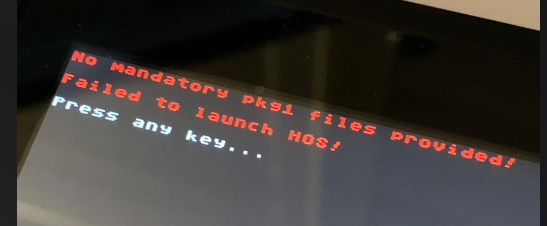

Update:
Booting stock sticks at the white switch logo.
Booting stock through hekate gives
Booting sysnand through fusee or hekate
Try to install sys-patch.
Tried that and still got the same issues.

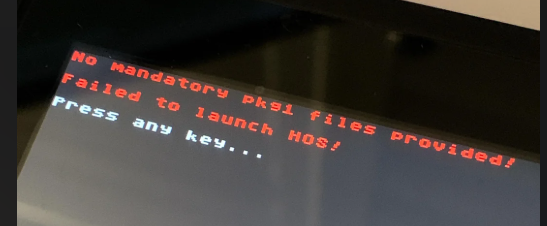

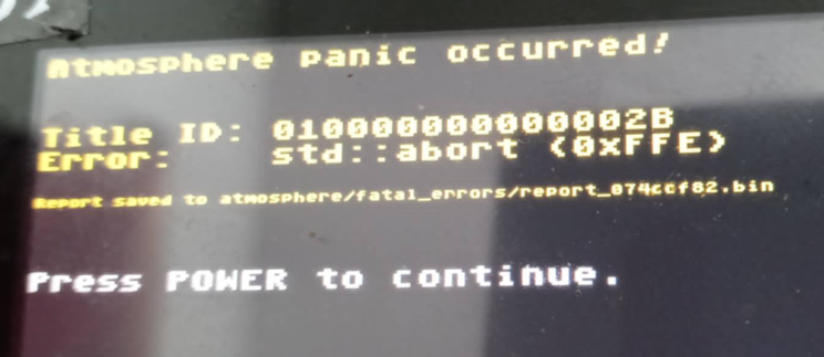

Update:
Check if your /bootloader/hekate_ipl.ini file contains an entry somewhat like this:
[Stock sysMMC]
pkg3=atmosphere/package3
emummc_force_disable=1
stock=1
Code:[config]
autoboot=0
autoboot_list=0
bootwait=0
verification=1
backlight=100
autohosoff=2
autonogc=1
updater2p=1
[100% STOCK OFW]
ofw=1
icon=bootloader/res/ofw.bmp
[SEMI-STOCK (SYSMMC)]
stock=1
icon=bootloader/res/stock.bmp
[CFW (SYSMMC)]
icon=bootloader/res/sysnand.bmp
[CFW (EMUMMC)]
emummcforce=1
icon=bootloader/res/emummc.bmp

SOLVED
____________________________________________________
boot into hekate
Lockpick_RCM_Pro.bin payload ---->Dump prod.keys
Prodforge.bin payload ----> Dump prodinforge.dec
Mount SD to PC using hekate
Move prod.keys and proinforge.dec to PC
Launch NxNandManager File>Open File > prodinforge.dec
Options> Configure keyset > prod.keys >
save as file > PRODINFO.bin
Launch NAND-FixPro
Settings> Offline Mode > Stick the things in the holes>
Move BOOT0 BOOT1 and RAWNAND.bin to SD:\backup > [unique ID] > restore
Eject SD
Using hekate
Restore eMMC BOOT0 & BOOT1
Restore eMMC RAW GPP
power off
Not sure if this is what did the trick... but see what da happen was
I didn't realize my jig wasn't in and an my big hands put me into factory reset.
So I did. YMMV
