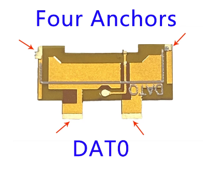

Switch OLED adapter Solderless adapter for eMMC DAT0 point from muna.io are reliable? or just the other models are better?
