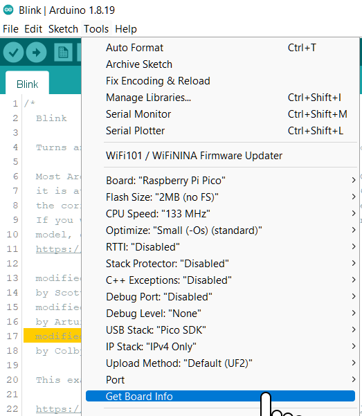

to get your Pico ID (the NOR Flash one) you have different methods:
Using Arduino Genuino

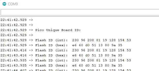

Or run this program on the Pico:
C:
#include "pico/unique_id.h"
String cadena;
String cadenaHex;
void setup() {
Serial.begin(115200);
while (!Serial) {
; // wait for serial port to connect. Needed for native USB port only
// send an intro:
Serial.println("\n\nPico Unique Board ID:");
Serial.println();
// initialize digital pin LED_BUILTIN as an output.
pinMode(LED_BUILTIN, OUTPUT);
// the loop function runs over and over again forever
void loop() {
digitalWrite(LED_BUILTIN, HIGH);
cadena = "";
cadenaHex = "";
pico_unique_board_id_t board_id;
pico_get_unique_board_id(&board_id);
for (int i = 0; i < PICO_UNIQUE_BOARD_ID_SIZE_BYTES; ++i) {
cadena += String(" " + String(board_id.id[i], DEC));
cadenaHex += String(" " + String(board_id.id[i], HEX));
Serial.println("Flash ID (int): " + cadena);
Serial.println("Flash ID (hex): " + cadenaHex);
delay(250);
digitalWrite(LED_BUILTIN, LOW);
delay(250);
then connect to computer and monitor the COM port of the connected pico, you will get something like:
This program DO NOT start running on the pico until you open a COM monitor

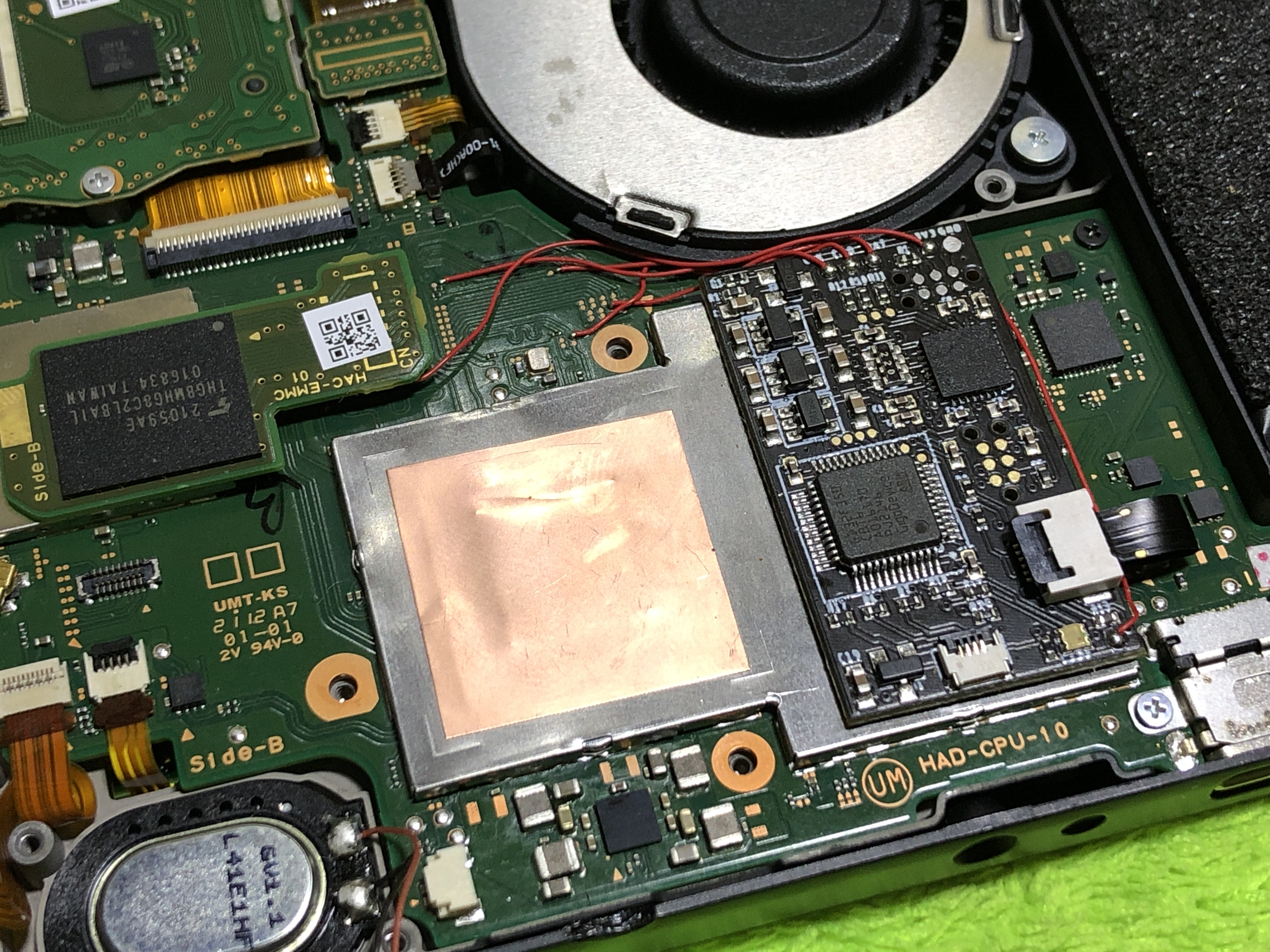

Interestingly, binwalk only sees these encrypted binary sections in the uf2, when flashed and then dumped it no longer detects anything- just pure binary.
you aren't going to have any luck decompiling the uf2 file. I tried to decrypt the binary file and while it worked, it seems they've done their homework and removed any useful information from that file. It would genuinely be easier to write your own.
From what I understand they're using the PIO on the rp2040 to perform the glitch instead of the fgpa on the hwfly boards

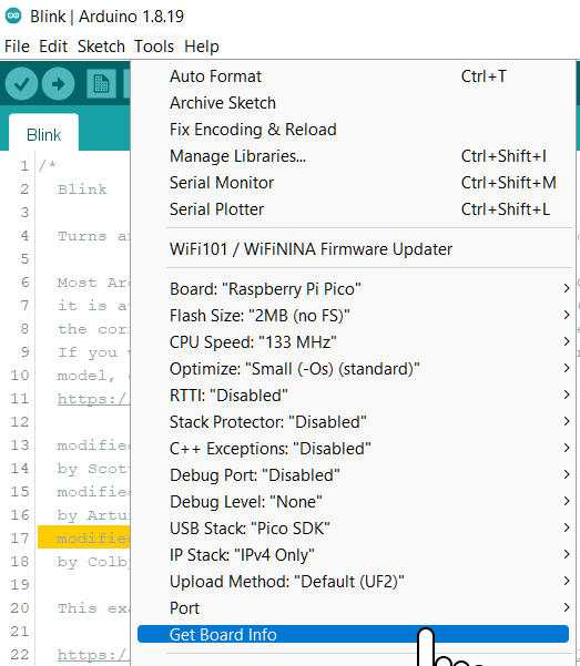

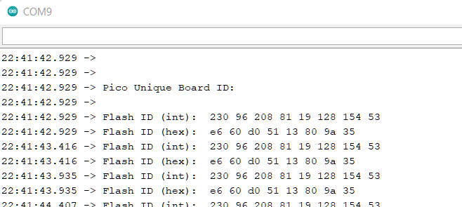

String cadena;
String cadenaHex;
void setup() {
while (!Serial) {
// send an intro:
Serial.println();
void loop() {
cadena = "";
cadenaHex = "";
delay(250);
delay(250);
