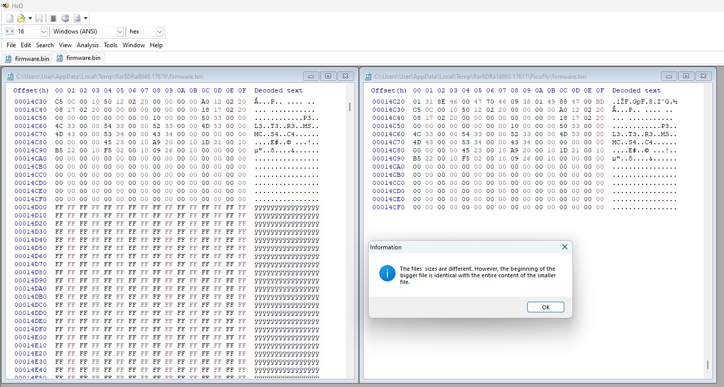

well we'd need a second dump wouldn't we?
Just checked both dumps, md5 is different. Possibly this is dumps from different chips. Uf2 is the same
bins same too, its just cleared of empty blocks, so md5 must be identical
Reactions: SylverReZ
a little higher in the subject there is an archive with a firmware dump
The dump is the same as this guy's dump here: https://gbatemp.net/threads/pikofly...y-modchips-or-not.622701/page-8#post-10049937
They just added extra padding to the dump to make it more convincing. You ain't fooling nobody, kiddo.

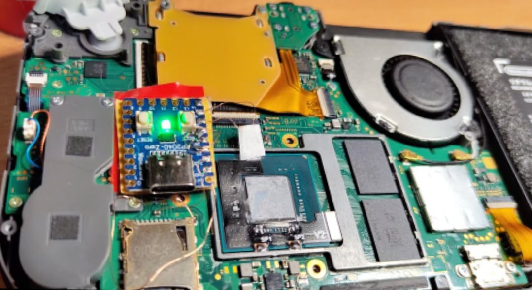

Little update on this...after posting I thought I better go and check I had soldered in the flex's correctly so took the rp out and wired up a sx core manually using the same wires i was using for the rp(dont have any lites currently) and it wouldn't glitch...turns out I hadn't soldered dat 0 correctly.
fixed that issue and confirmed my wiring was good with the sx, rewired the RP back in but unfortunately getting the same result. blue light then red light...BUT now im NOT getting into OFW like I was before, this is similar to what happens when you have soldered a sx/hw chip in incorrectly(again I confirmed this wasn't the case)
removing 3.3v does allow the console to then boot OFW like normal(expected behaviour)
so IMO at this point its trying to do something and failing...maybe this is to do with the ID encryption I read a few pages back...maybe its missing something but im now in a position where I can test anything hardware side. so please let me know.
also ive tested the install with and without resistors as the picture on page 1 clearly doesn't have them installed. so not sure why schematic a few pages ago does
