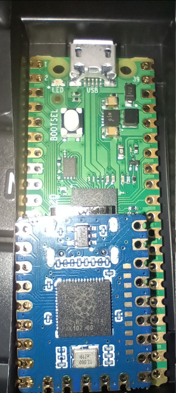

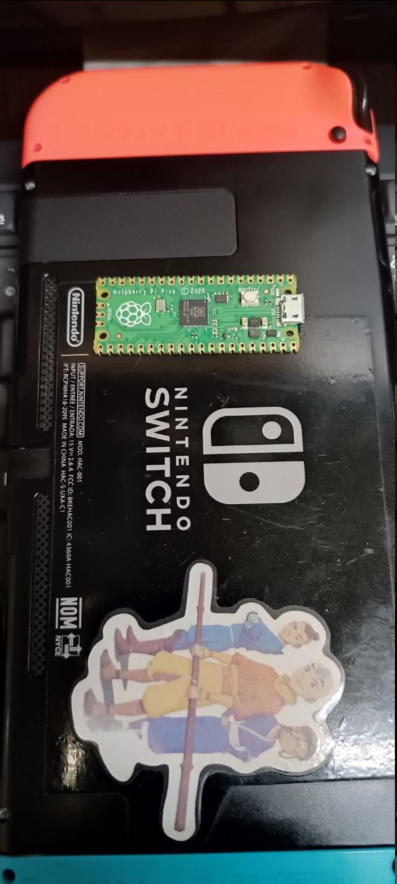

Someone asks if the raspberry pico would fit inside the console, I think maybe, Here are two pictures, a RP2040-Zero on a Raspberry pico, and a Raspberry pico on a V1 Switch.
  • Love
