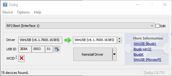

If someone is interested on the Pico related boards, a must have tool is the PicoTool (https://github.com/raspberrypi/picotool) but the tool needs compilation to use.
Also, Arduino have a repo of precompiled tools, you can find them on https://github.com/arduino/rp2040tools/releases there are tools like:
  • elf2uf2.exe
  • picotool.exe
  • pioasm.exe
  • rp2040load.exe
The instructions on page are a bit dry. I found another set of instructions on https://shawnhymel.com/2168/how-to-build-openocd-and-picotool-for-the-raspberry-pi-pico-on-windows/ but they are a little bit scrambled and have unnecessary steps.
Here are the steps I did use to build PicoTool from source using MSYS MinGW:
First you need
Download the latest version from: https://github.com/msys2/msys2-installer/releases
Install the version corresponding to your Operating System (64 or 32 bits).
Accept the defaults in installation program of MSYS2 once you finish the installation you will have shortcuts for MSYS2, MinGW32 and MinGW64. MSYS2 is used to compiling POSIX binaries for Linux from Windows.
MinGW32 & MinGW64 compile Native Windows binaries using a linux toolchain (gcc, bash, etc.)
Launch MSYS2 shell and execute the command: pacman -Syuu several times until you get the message: "there is nothing to do".
After you have a MSYS environment set up you need to Install Build prerequisites following these steps:
Bash:
pacman -Syu --noconfirm
pacman -Su --noconfirm
pacman -S --noconfirm git make libtool pkg-config autoconf automake texinfo wget mingw-w64-x86_64-toolchain mingw-w64-x86_64-gcc mingw-w64-x86_64-cmake mingw-w64-x86_64-python mingw-w64-x86_64-libusb
Seems what was upon a time when the libusb of Mingw had a error and you need to install an old version, that can be acomplished using:
Bash:
cd ~
wget https://repo.msys2.org/mingw/x86_64/mingw-w64-x86_64-libusb-1.0.26-1-any.pkg.tar.zst
pacman -U --noconfirm https://repo.msys2.org/mingw/x86_64/mingw-w64-x86_64-libusb-1.0.26-1-any.pkg.tar.zst
Then you need to setup the Pico-SDK and the Pico-Examples needed to successfull compile:
Bash:
cd ~
git clone -b master https://github.com/raspberrypi/pico-sdk.git
cd pico-sdk
git submodule update --init
cd ..
git clone -b master https://github.com/raspberrypi/pico-examples.git
export PICO_SDK_PATH=~/pico-sdk
You can be sure all is setup to go running these commands:
gcc
Result:
Bash:
gcc.exe: fatal error: no input files
compilation terminated.
ld
Result:
Bash:
C:\msys64\mingw64\bin\ld.exe: no input files
make
Result:
Bash:
make: *** No targets specified and no makefile found.  Stop.
mingw32-make
Result:
Bash:
mingw32-make: *** No targets specified and no makefile found.  Stop.
echo $PICO_SDK_PATH
Result:
Bash:
/home/<YOURUSER>/pico-sdk
and now you are ready to start the building process:
Bash:
cd ~
git clone -b master https://github.com/raspberrypi/picotool.git
cd picotool
mkdir build
cd build
cmake -G "MSYS Makefiles" -DPC_LIBUSB_INCLUDEDIR="/mingw64/include/libusb-1.0" ..
make -j
Thanks to @binkinator, If anyone gets the following error:
Bash:
$ cmake -G "MSYS Makefiles" -DPC_LIBUSB_INCLUDEDIR="/mingw64/include/libusb-1.0" ..
CMake Error: Could not create named generator MSYS Makefiles
Generators
* Unix Makefiles               = Generates standard UNIX makefiles.
  Ninja                        = Generates build.ninja files.
  Ninja Multi-Config           = Generates build-<Config>.ninja files.
The Error:
Bash:
Generators
  CodeBlocks - Ninja           = Generates CodeBlocks project files.
  CodeBlocks - Unix Makefiles  = Generates CodeBlocks project files.
  CodeLite - Ninja             = Generates CodeLite project files.
  CodeLite - Unix Makefiles    = Generates CodeLite project files.
  Eclipse CDT4 - Ninja         = Generates Eclipse CDT 4.0 project files.
  Eclipse CDT4 - Unix Makefiles= Generates Eclipse CDT 4.0 project files.
  Kate - Ninja                 = Generates Kate project files.
  Kate - Unix Makefiles        = Generates Kate project files.
  Sublime Text 2 - Ninja       = Generates Sublime Text 2 project files.
  Sublime Text 2 - Unix Makefiles
It's because regular cmake has priority in your path over the mingw version.
By example if you run:
$ which cmake
you get:
/usr/bin/cmake
So you can try this to fix it:
Bash:
$ export PATH=/mingw64/bin:$PATH
$ which cmake
and you should get
/mingw64/bin/cmake
Now the command
will work as needed
The last step is to copy the needed external libraries to the same folder of the new build executable, you need to take them with the Exe file if you like to use outside the MSYS environment.
Bash:
cp /mingw64/bin/libusb-1.0.dll .
cp /mingw64/bin/libgcc_s_seh-1.dll .
cp /mingw64/bin/libstdc++-6.dll .
cp /mingw64/bin/libwinpthread-1.dll .
./picotool.exe
If you get a USB deviced don't recognized of the error:
e: and if you get the following...
Bash:
       $ ./picotool.exe info
No accessible RP2040 devices in BOOTSEL mode were found.
but:
Device at bus 2, address 1 appears to be a RP2040 device in BOOTSEL mode, but picotool was unable to connect.
You may need to install a driver. See "Getting started with Raspberry Pi Pico" (https://github.com/raspberrypi/picotool/issues/20) for more information
In summary you need to use Zadig to create the needed drivers for windows
https://zadig.akeo.ie/
