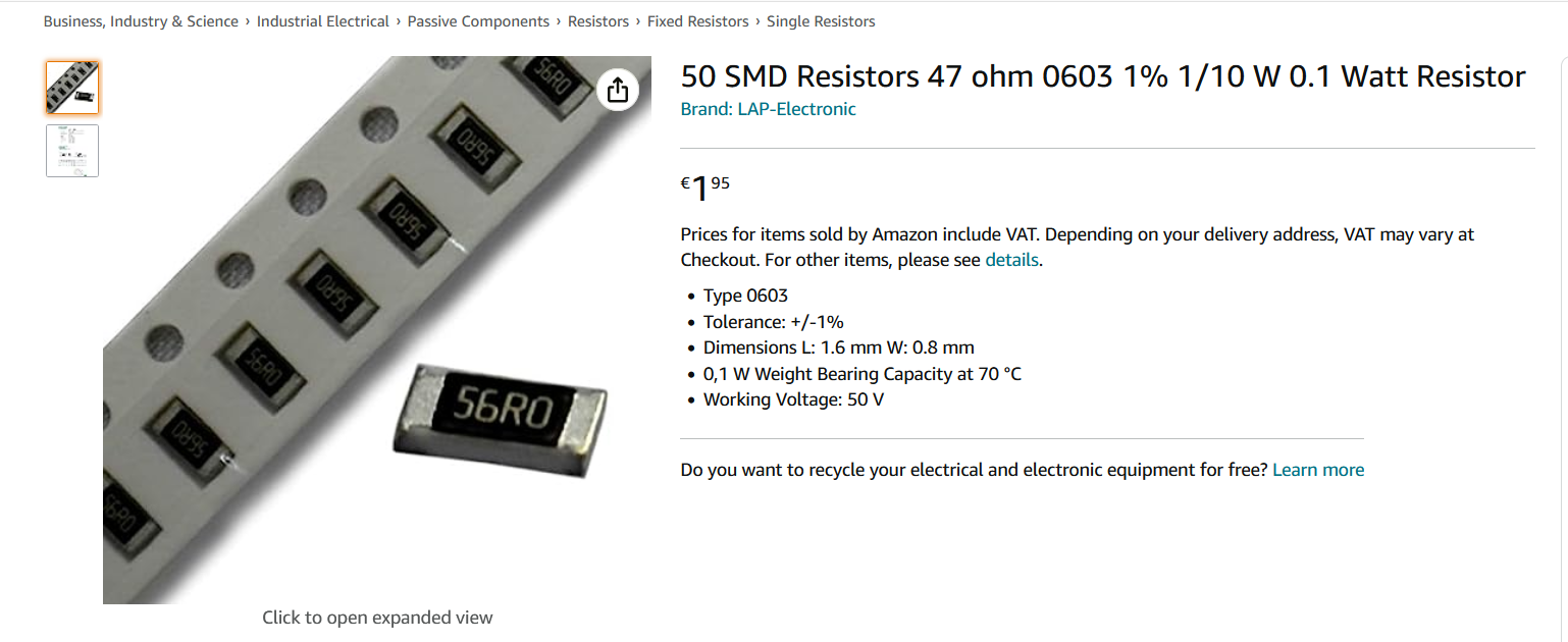

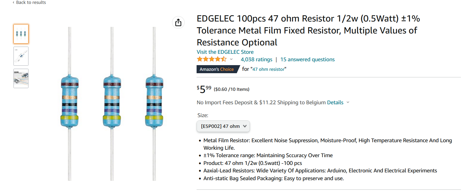

Hi, do these resistors work? they are 47 ohm so they should right?
You want smd resistors. Those are too big.

Yes, they will do. You sure you don’t want some nice flat SMD resistors In a 1206 package? about the same difficulty and will lie flat and look much better.
oh. You don’t thing they could be pushed over to lay flat?
