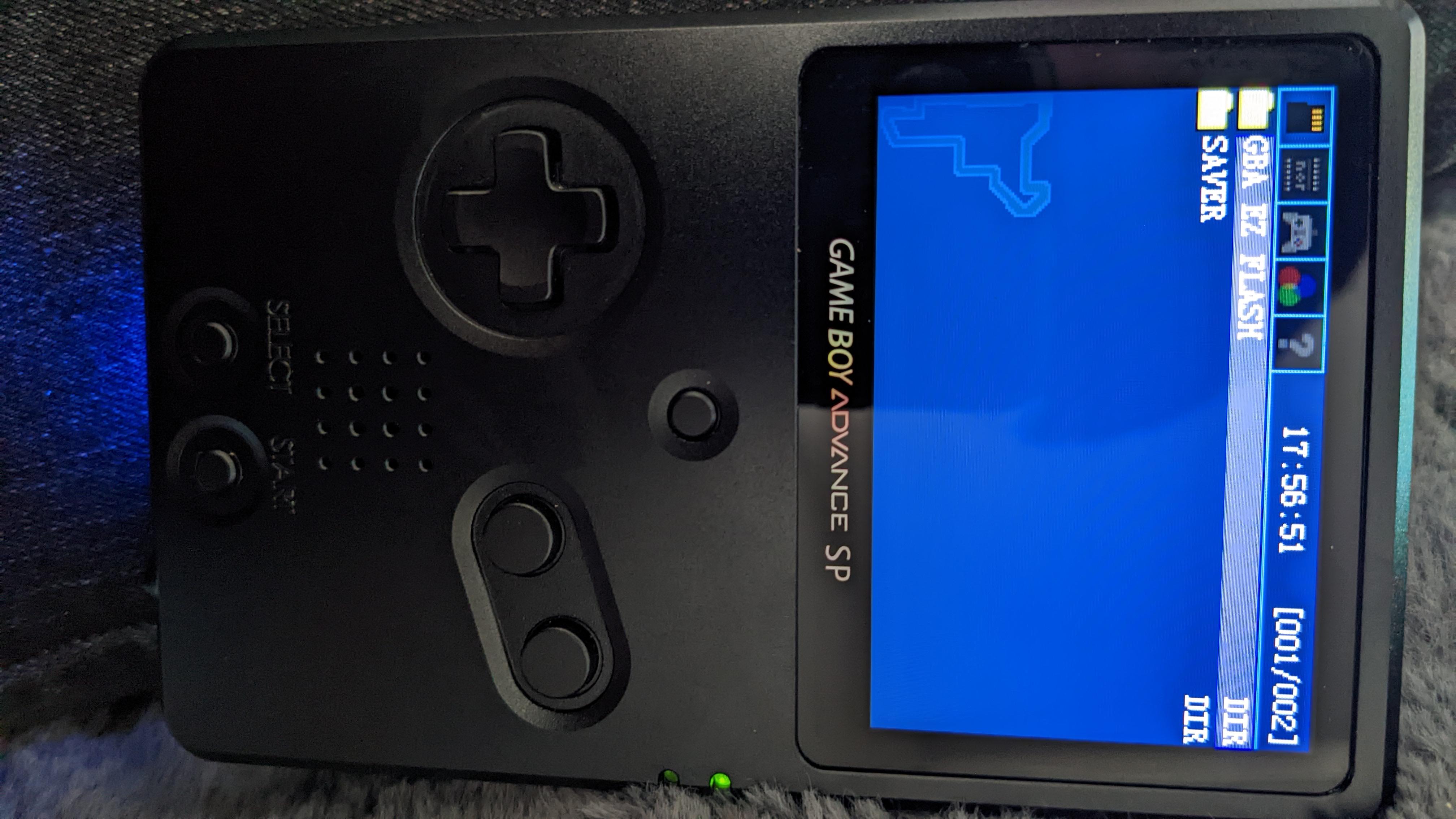

É possível implementar a mesclagem entre quadros para evitar danos às telas de LCD ao jogar jogos como F-Zero?
Are you saying that F-Zero can cause physical damage to the Nintendo 3DS screen? But the same game exists officially via Virtual Console. Could you explain it to me better?
Thanks!
Nintendo used a trick for F-Zero to avoid real transparancy effect on the map : the map is blinking giving the illusion to the player that the map is somewhat transparent. 1 frame the map is displayed, the other frame it is not and so on. New screens do not like this and there is a risk of permanent burn-in. My 3DS's (both IPS and LCD) display the map during 5 minutes or so after switching off the console (I never tested the VC version). Here is an example of the problem :
I think there are ROM patches to turn it off altogether
