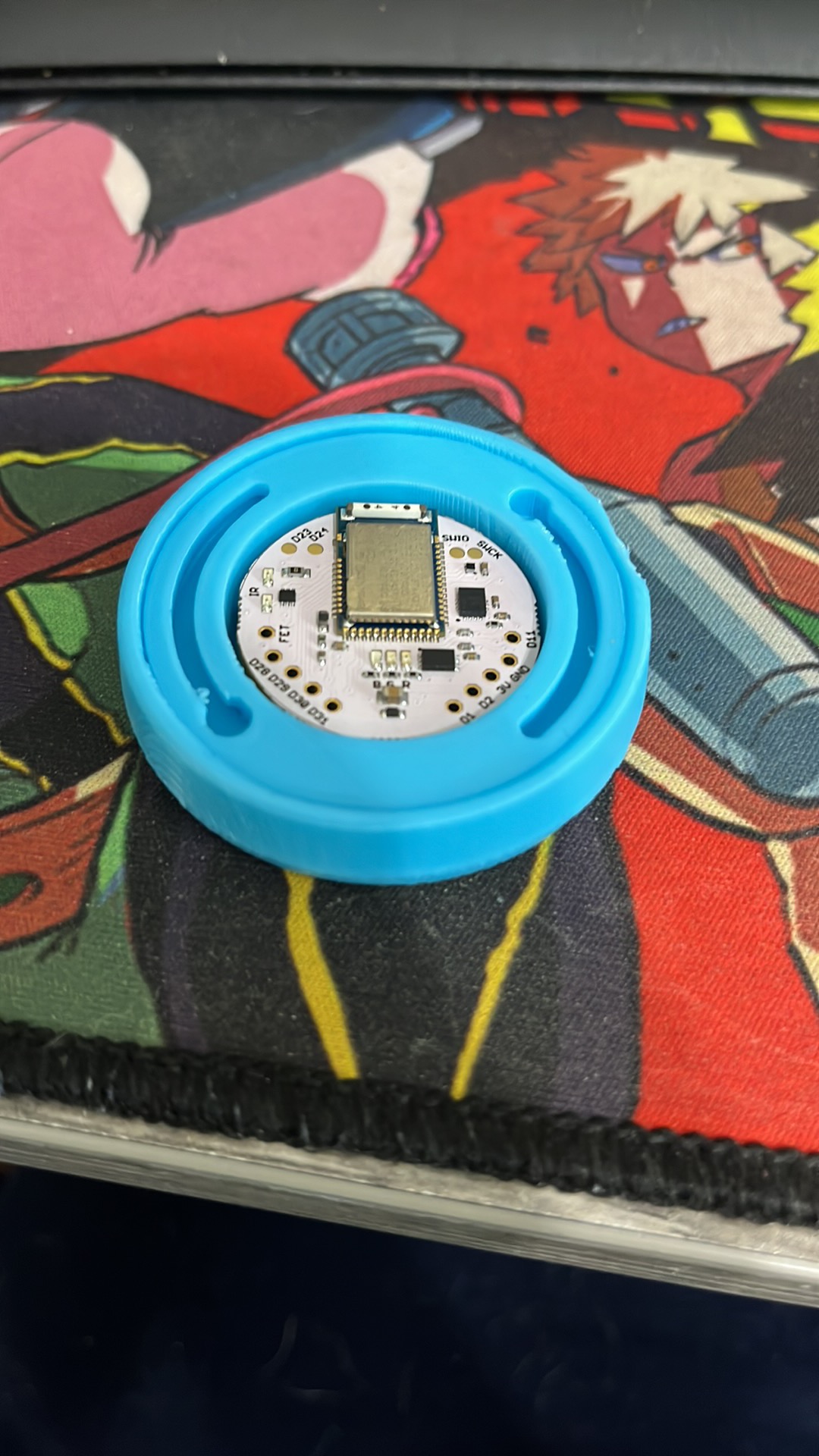

I just need to dial in my PETG a bit more..

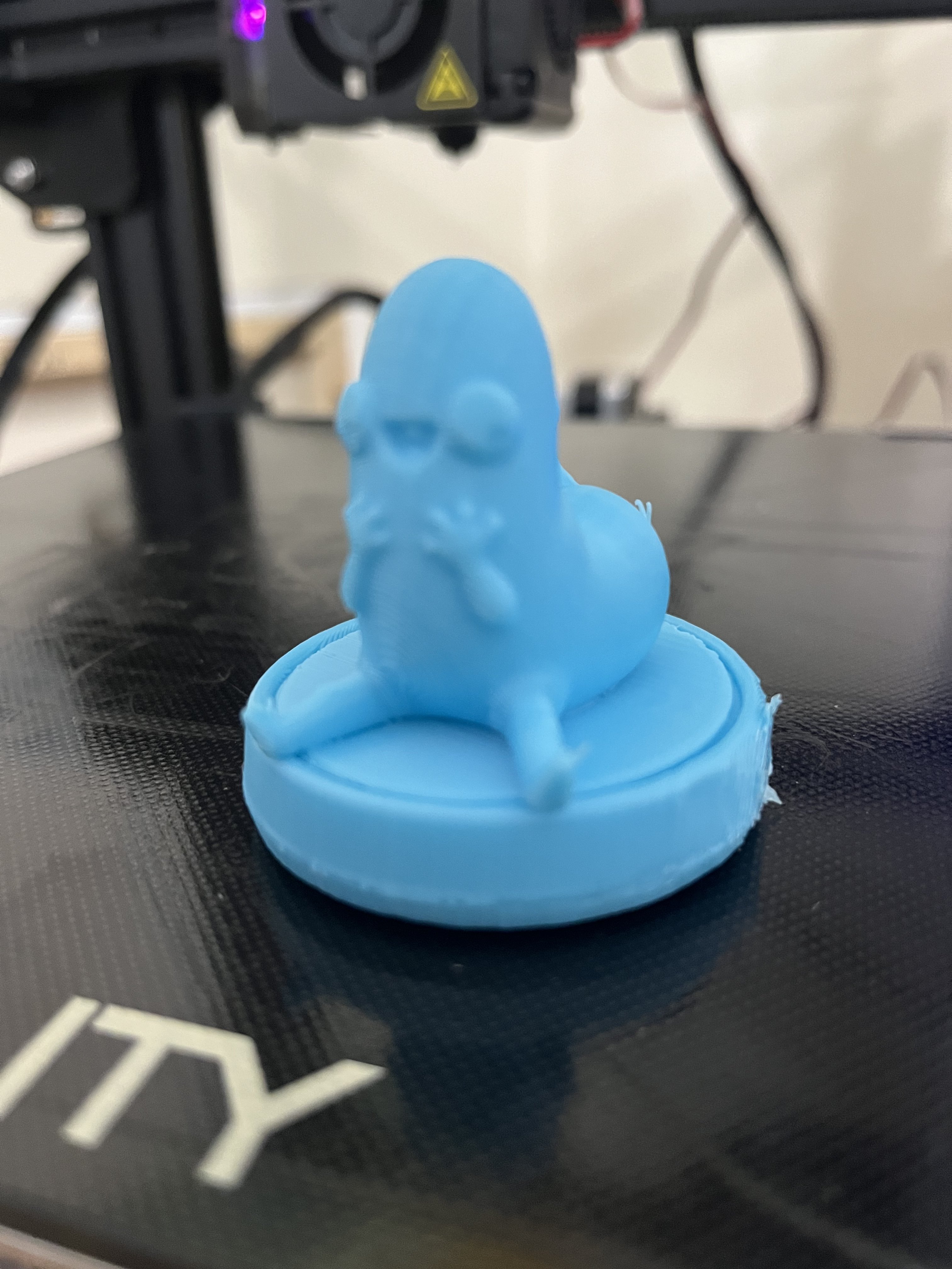

Plus the customization is always fun. I don’t think Nintendo intended for there ever to be a “rocktopus” amiibo lmao

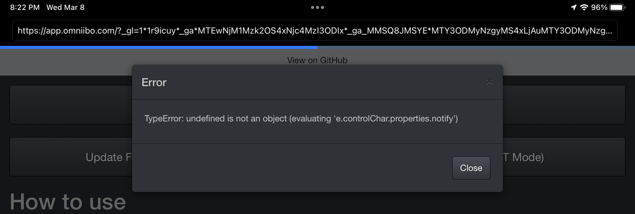

I can update the firmware but I can’t used the tag manager app
asking again…then…how are you getting the omniibo firmware onto the puck.js v2?

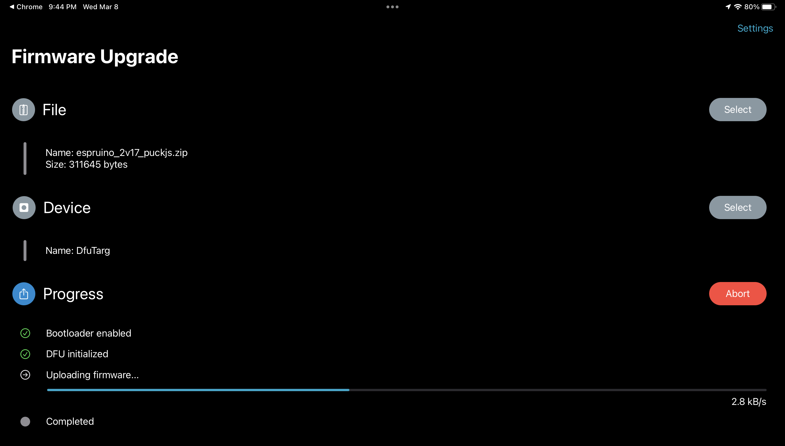

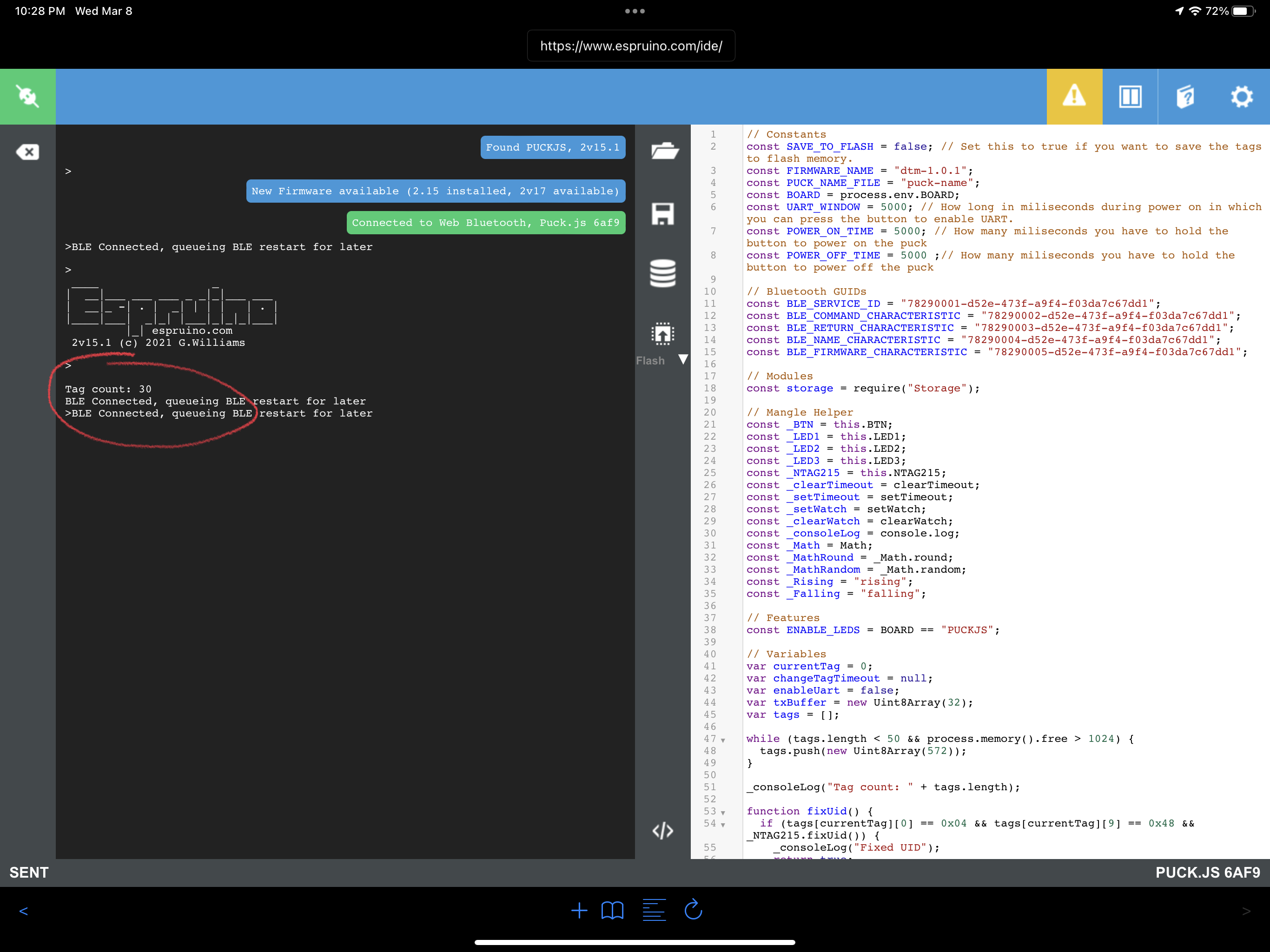

e3: here’s what I’ve done (successfully?) thus far:
download the espruino_2v15.1_puckjs.zip firmware file by hand.
used the iOS Device Firmware Update (15 or later - recommended) app to upload the firmware to the puck.js in DFU mode.
installed the webBLE app and opened it to the puck.js web IDE located here: https://www.espruino.com/ide/
uploaded the script located here

I forgot to write the steps down so after work tomorrow I will dig up my puck js and help double check/give exact instructions if this doesn’t help
But I had similar issues. I believe I had to connect the puck to my pc (I didn’t use iOS) via Bluetooth normally at first
Than do the DFU mode by inserting the battery while holding the button. From here the device should hopefully auto connect after a minute or so since it’s already been paired and you can use that DFU mode button
Assuming I’m not misremembering I don’t see why this wouldn’t also work on iOS as long as you have that correct browser

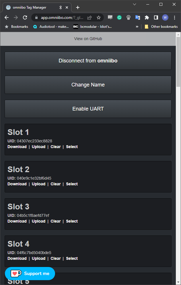

Heya...I spun up my Windows box (I was replacing the ssd yesterday) and everything works like a champ now!
The steps I took on the iPad also work except for the last piece where you connect to Omniibo via the web app.

This is the only tool I’m aware of for managing the puck
That’s great that you got it working though!
That’s still weird that your ipad won’t connect however. I wonder if it’s just an issue with that third party browser and if android solutions would work better

one thing I failed to mention is I also had trouble with Bluetooth on my windows machine as the internal device was not V4.0 compliant. Disabled the internal and plugged in a cheap BT adapter and it just popped right up!
