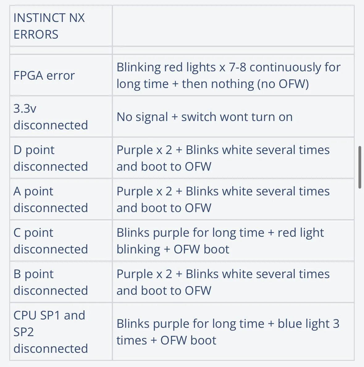

Perhaps this might help you.
For that to have any meaning the console must boot normally when lifting the modchip otherwise error signals will not help much if the console is dead.
