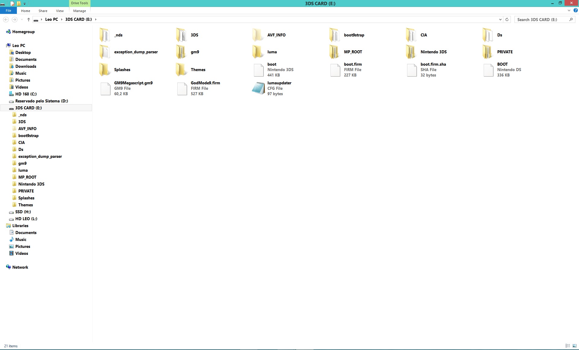

Can you show us the root of your sd card? What exactly happens when you turn on the console?
Nothing, not even the LED turns. Of course, here.
