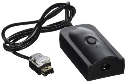

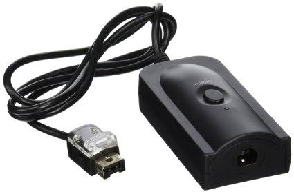

im not too sure where and when i saw it but a GC adapter plugged to the end of the WiiMote exists as well..
edit: here's a photo courtesy of Google images
*just in case anyone is interested.. ^^^^^^^^^^^^^^^^^^^
i have one but it just turns the gc controller into a CC and the worst part is no rumble support and you still need to have it connected to a wiimote draining its batery everytime.
