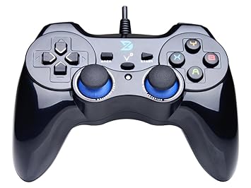

I have a unique problem, and it's configuring my controller using HID_Test for reference.
I own a ZD-V (Wired version)
A unique feature of the controller that is has a DInput and XInput mode, but on the Wii, it defaults to DInput mode, but that's beside the point.
I can map the buttons correctly, including L and R in analog mode, but the problem I'm facing is that two bytes of data change whenever I move the left or right thumbsticks, instead of just one byte.
So, for example, if I decide to move the left thumbstick to the left, it returns:
6,00
7,80
and if I move the same thumbstick to the right, it returns:
6,FF
7,7F
and unfortunately, I can't specify both byte positions on StickX/Y or CStickX/Y, because it only accepts one. This is what my ini looks like:
[ZD-V Wired]
VID=11C5
PID=5506
Polltype=1
DPAD=1
DigitalLR=0
MultiIn=0
Power=3,04
A=3,20
B=3,10
X=3,80
Y=3,40
Z=3,02
L=4,7F
R=5,7F
S=2,10
Left=2,04
Down=2,02
Right=2,08
Up=2,01
RightUp=2,09
DownRight=2,0A
DownLeft=2,06
UpLeft=2,05
StickX=7,80,7F
StickX=6,00,FF
StickY=9,80,7F
StickY=8,00,FF
CStickX=B,80,7F
CStickX=A,00,FF
CStickY=D,80,7F
CStickY=C,00,FF
LAnalog=4
RAnalog=5
Rumble=1
RumbleType=0
RumbleDataLen=05
RumbleDataOn=00,00,00,00,01
RumbleDataOff=00,00,00,00,00
RumbleTransferLen=05
RumbleTransfers=1
If I leave out 6, 8, A, and C, the thumbsticks will simply not work, but if I leave out 7, 9, B, and D, it confuses the neutral position with the left or up position. Any tips on what I should do about it?
