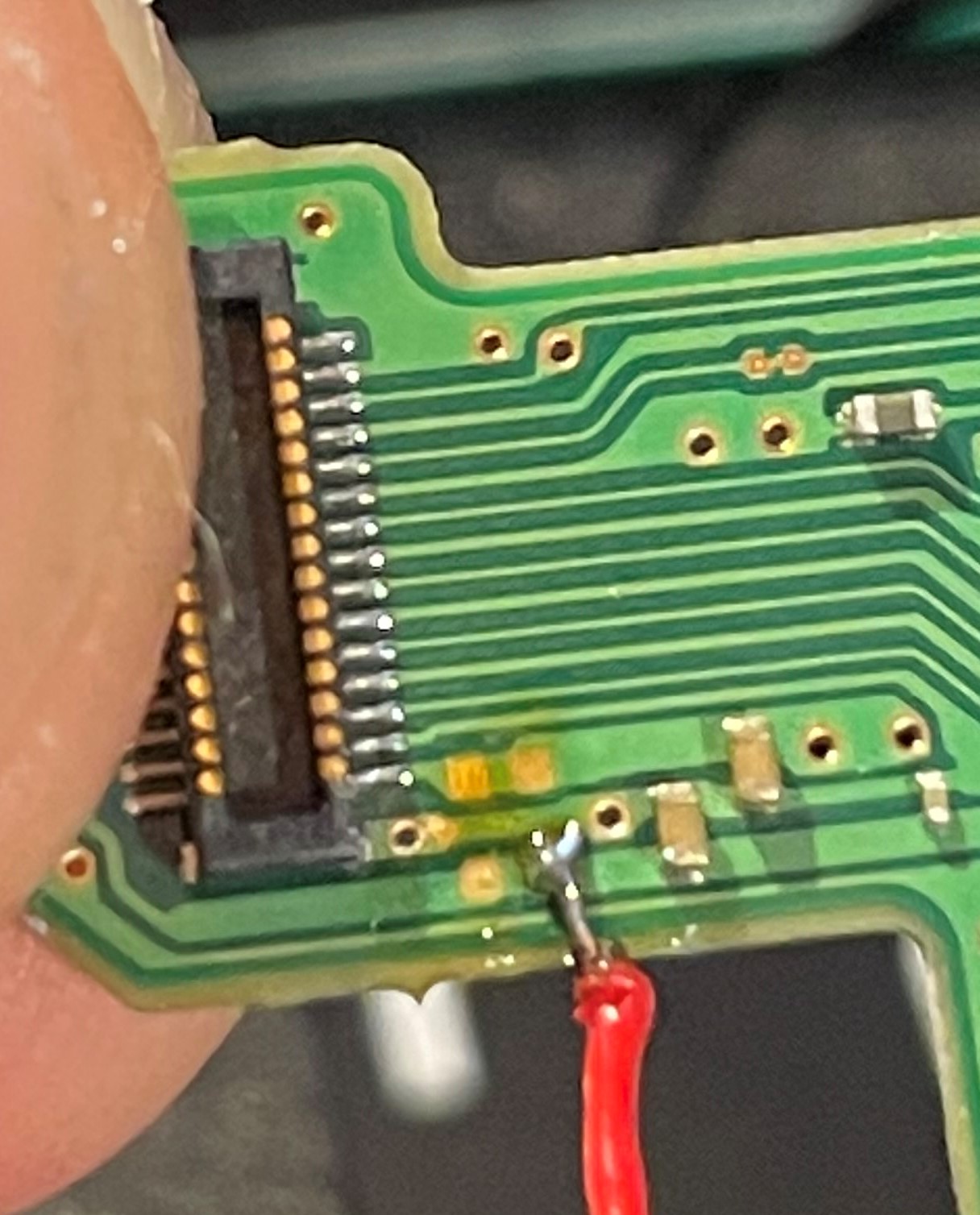

@pyorin This is super unrelated but I could use some help with this (I don't know why I wasn't given the option to PM you). I saw your post of alternate solder points for M0 trinkets (Im using RCM x86) and I couldnt solder the 3.3v properly so i decided to use the alternate nand points. Is this correct or was i supposed to join the two points together with the wire (extend the wire to the pad to the left aswell).
Thanks, and sorry for the misplaced question

These are the points - So yes.
