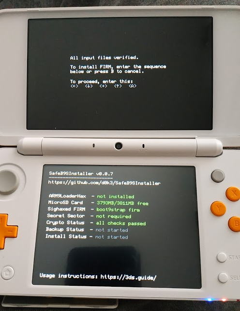

Hi Everyone,
after trying a software modification my DS does not start anymore!
I try to turn it on but the blue power LED only flashes.
I tried to modify it with an R4 following a guide on the internet but I made a mess ....
Can you help me?
I would at least be able to bring it to the original state.
Thanks and Sorry for my English...

This is what happen when i trie to open with inserted the R4/sd card and the other sd....if i try to open without this one it remains all black ..

yes i do it..all the combination requeste and seems to go becouse it appears in green also the last 2 voices...bur then it restarted and go to the same image you can see here..

You are suppose to run the SafeB9Sinstaller once and then replace the boot.firm to the luma3ds one.

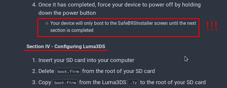

Thanks to your support...
I can hardly understand what you say ..I'm not an expert ..Can you tell me what I can do to restore the situation? All these terms are
incomprehensible for me....i arrived here only following a sort of guide...but i don't understand..

Wrong, that screen is for the B9S installation, he is just in a loop, where he needs to replace the boot.firm file to get out of the loop.

Perfect... i resume the DS to original! It works...:toot::grog::bow:
thanks for all...
