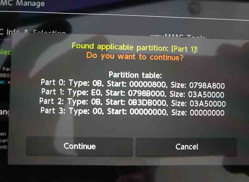

Tagging onto this thread because I'm having the same issue. Followed EmummcInstructor and set up 2 emuMMC partitions exactly the same way and written with the same backup NAND.
When I run Hekate and migrate emuMMC, it gives me the repair dialog, just like in the instructions. That set up 1 of the 2 partitions. I can select RAW1, but RAW2 is greyed out.
When I look at it in linux, 1 of the partitions is FAT32 and the other is unknown. I'm not really sure which is which, but in any case, only one partition is getting repaired.
As a follow-up to my last post, see the partitions here. Part 1 is recognized by Hekate and working as an emuMMC. Part 2 is the same size, with the same data, but doesn't get recognized.
I noticed the same thing when I looked at mine in Gparted. The partition in the unknown format should have successfully flashed while the partition in the FAT32 format was unsuccessful. You could try flashing to the FAT32 partition using the dd Terminal command in Linux as @kassio69 advised in his guide to see if that is enough. If it is not, then you could do as I did and delete and reallocate the emuMMC partitions. I was finally successful. If you need any help, reply to this thread. Between those of us already here, we should be able to help you.
