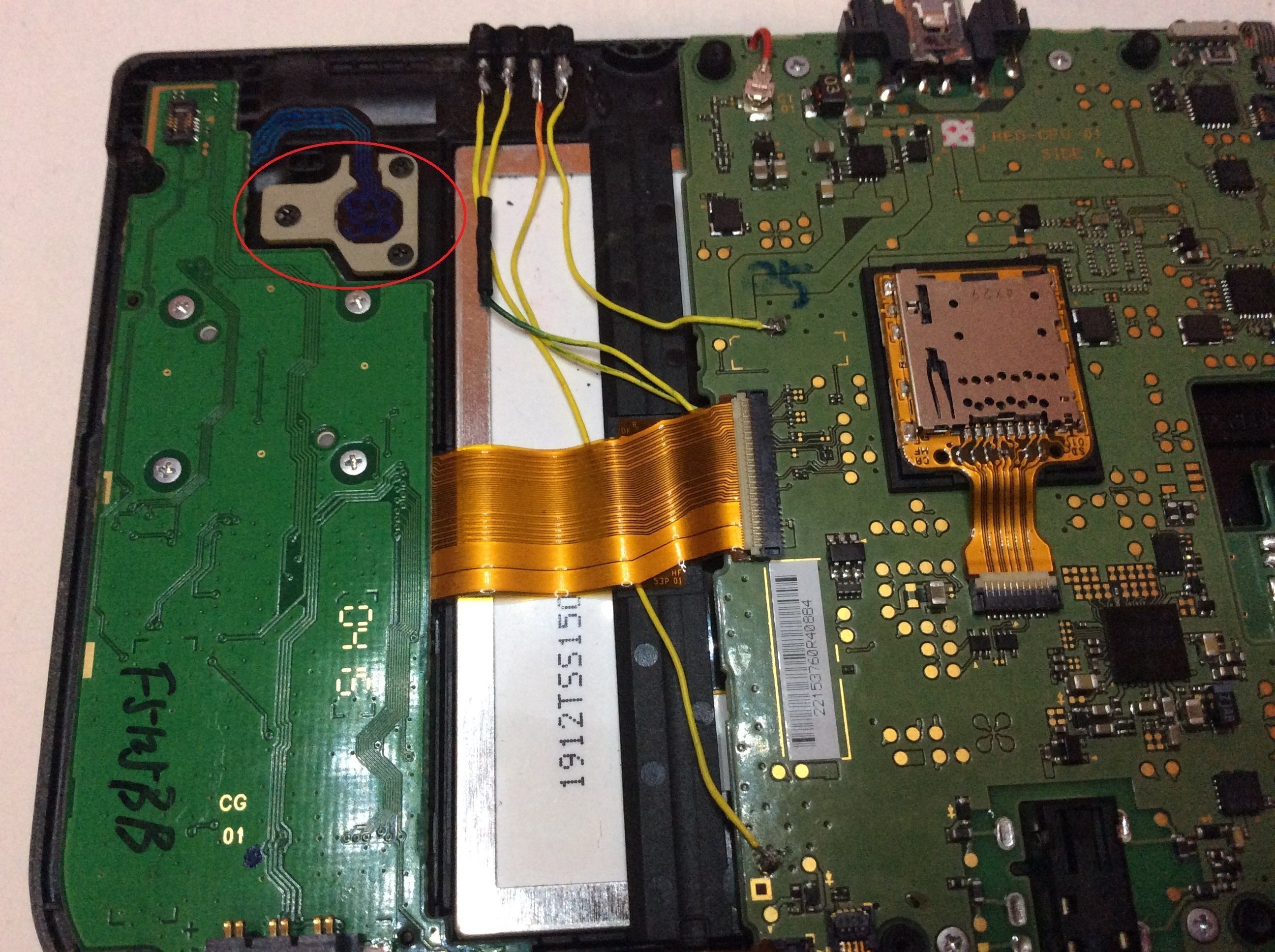

is worth it to put psp stick? i have n3ds (not the xl)
Yes defently BUTTT you need to have some balls, people just stick it on top the "holder" and call it a day but then it's a little wobbly, i used super glue and positioned perfectly streight and it worked out perfect, if you glue it in it feels perfect and it's so odd because the nub doesn't move but the position of your finger makes stuff move and it's very accurate,

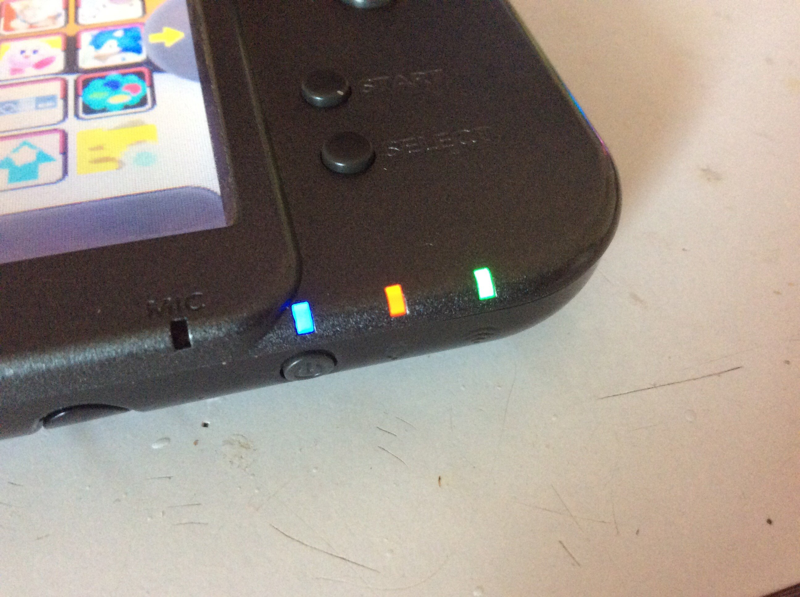

i've done my third n3ds xl mod, i was really annoyed by the orange wifi led, so i replaced it with a green one to match the spotpass green :P

I have a ton of 3000 sticks did you just shave the nub to make it fit or?
you need a psp-1000 nub, the 3000 won't work the 1000 had a cap on the stick like the c stick does though the 2000 and 3000 use a complete analog stick , you can't remove the nub
Is it as simple as just disconnecting the old led and chucking in a new one or no? :P
desolder the old smd led, it's whiny tiny, but once you removed it you can just replace it with any kind of smd 0603 i think, i had tons laying around, i kinda do want a white one for the power but i don't have one of those but the green wifi looks dope though

OK I also have a shit tone of 1000 nubs im asking what you did though.
you can pull the 1000 nub just off the psp, no need to disassamble or anything, it has a square form underneath.
now you can do two things, take a needle stick it it in the c stick and jank it out, it's holden in by 2 rubber circles one on the bottom left and one on the top, jank it out it doessent matter if you destroy the circles you can still place it back in without it falling out. the second thing you can do is open up your 3ds and remove the 3 screws that old the c stick in place and remove the rubber like that.
the form that the holder of the c stick has is a 95% match of that of the psp 1000 nub,i've glued mine in, but it even holds without glue, i just liked the stability of the glued version, you can find it on youtube, try psp c stick mod or something like that, it should work on both models of the new 3ds, i've only done it with my xl yet since i don't have another set of nub's i only have psp 2000 left, i have orded more for my girlfriend's new 3ds but i haven't done those but i've seen other people do them

You could have just typed "pop the c-stick off and replace it with the PSP nub" lol
well you could have guessed that your self :P as you can clearly see in the picture that i have a torn out c stick and a psp nub on it :P
since you asked i thought you wanted a tutorial
