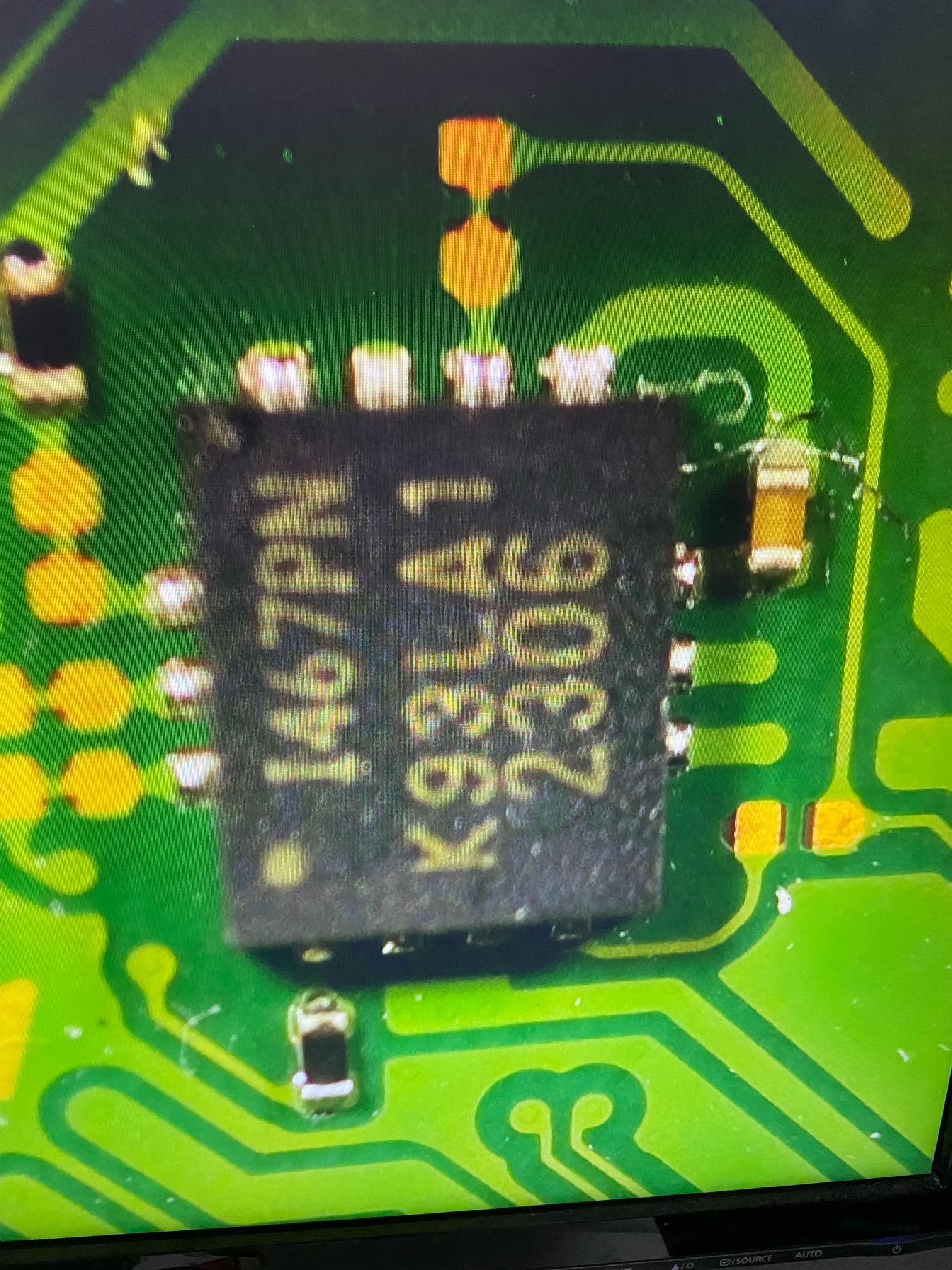

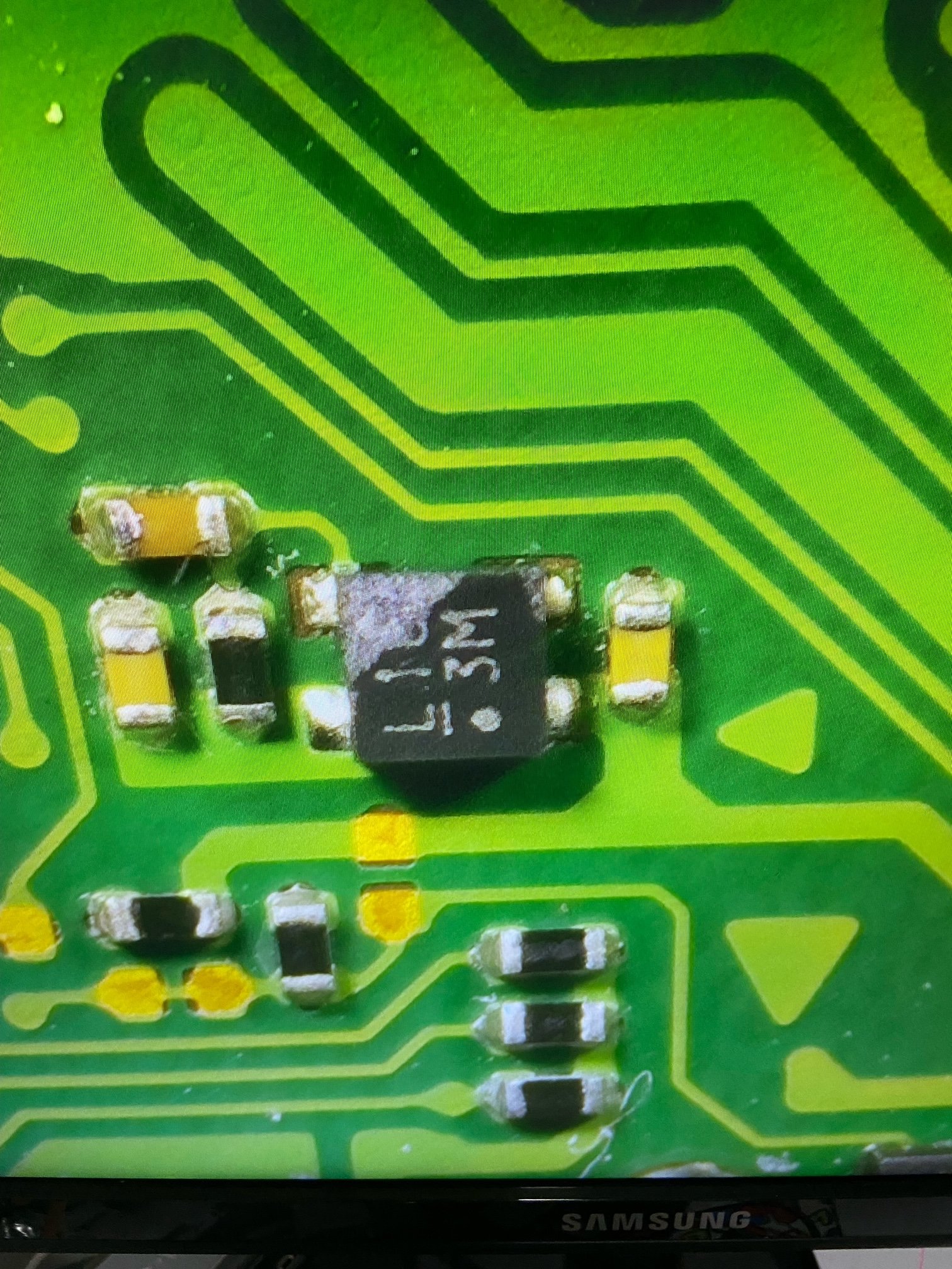

I've bought a dead OLED on eBay and I'm trying to revive it as a learning opportunity (and because I had issues with a picofly installation and was looking for a donor, but I ended up not needing any parts).
There are 2 smc which I can't identify and would be grateful if anyone could help. They are located on the backside of the board, above the M92T chip when the usb-c port is facing down.
Thanks!

BIG one is Gyro Acceleration Sensor. You can use TDK Icm-40607. Small one no idea yet.
Thanks a lot. Do you know if the switch can boot and work properly without the Gyro?
I'm trying to isolate a power issue following retrosix's diagnostics and would wait to see if I can get it to boot properly before changing it.
JUST test, switch would boot without Gyro
