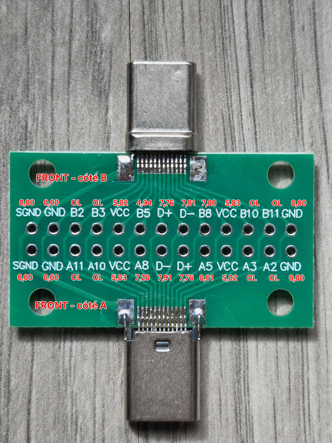

I replaced the port several times put the Switch only charge on one-side and it's undetected in the dock.
At this point I do not know if I soldered bad the new usb-c port, or something else, cuz i changed it several times.

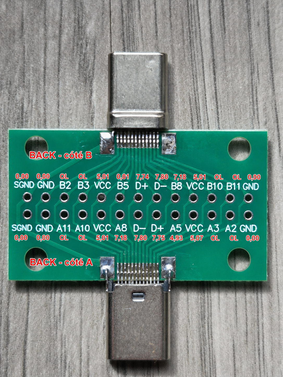

I bought a breakout board, here are my values :
Thanks guys !
Edit:

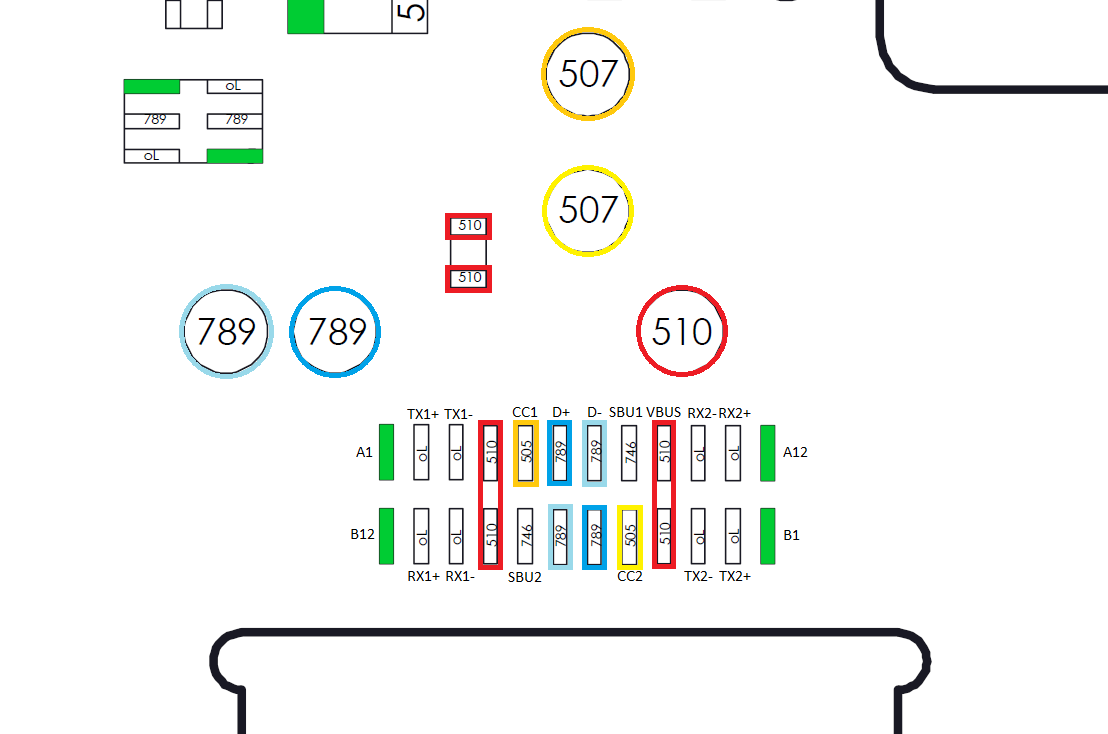

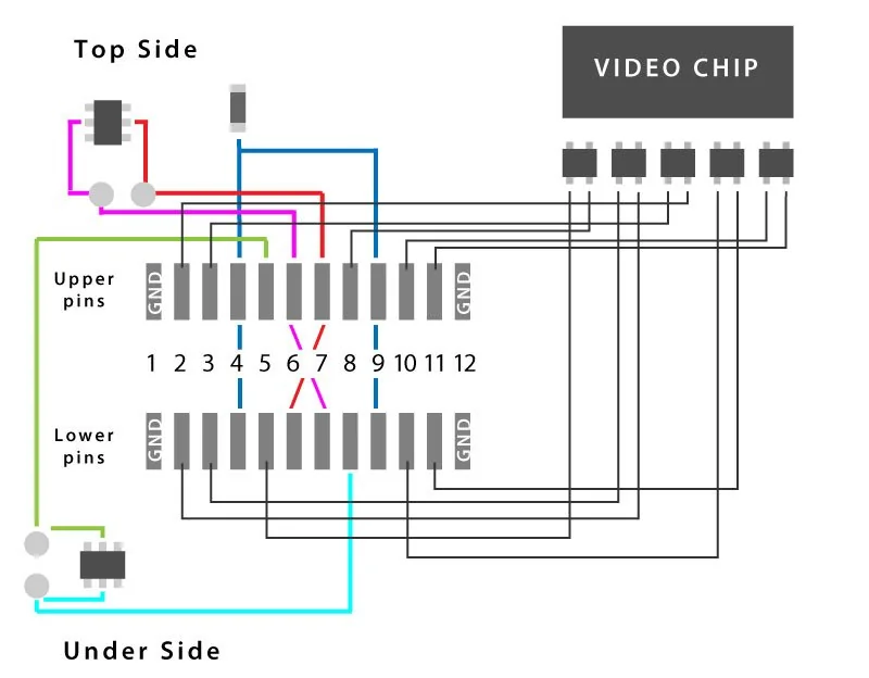

I found that my 5fth pin (B5) doest not have value, can someone help me locate where does it goes so I can track id and find C/C
Even with the diagram i did not find it
The pink line is how the 5V lines are connected.
It is almost impossible not to get +5V and GND so my best guess is microcracks somewhere in the middle.
Unless you maybe have some micro crack in the middle.
When the connector takes a beating when the cable is inserted, the PCB can get bent so much that the traces crack.
I assume you would have noticed any ripped off pads when replacing the connector.
Since the Switch is always inserted into the dock with the same side forward, maybe also the USB lines are cracked.
I don't know if the Switch Dock has redundancy on the data or power lines.
Not sure if replacing the M92T36 would matter because then it would not charge at all.
Remove the USB-C connector and show us some pictures.
