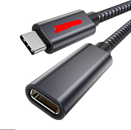

I almost never put NS in to the dock, I have been using the type-c extension cable, use it to connect NS to the dock is as easy as charging
