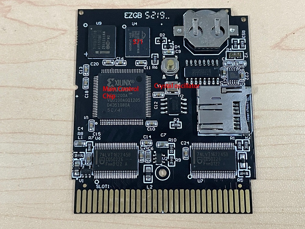

Can you check each of junior's s71 chip??
Location of s71 chip is in the picture.
I changed 71PL032J80 -> 71PL032J08
So far all function is good.
Save, RTC, Recently played game, fw update and etc
And finally, only battery problems remain.
I'll report it later.

final conclusion
power consumption of psram only keeps coin battery for a month.
Q. How do I know if the s71 chip is psram or sram?
A.
The mark of psram is 80.
The mark of sram is 08.
71xL0xxx80~ <- psram mark
71xL0xxx08~ <- sram mark
Q. My chip is psram. how can i solve this?
A.
There are two options.
1. Replacing coin batteries with cr2032
It will probably last 5 months.
2. Buy sram chip and replace it
It will probably last for a year.
Q. Which chip should I buy? how do i replace it?
A.
71GL064A08
71GL032A08
71PL064J08
71PL032J08
Buy one of these you can buy.
prepare a hot air station and Learn how to replace bga chip on youtube.
