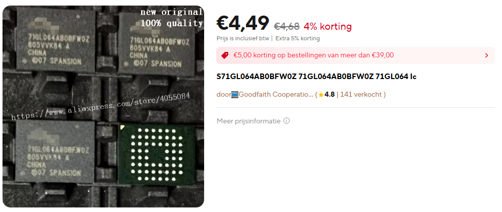

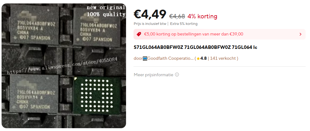

That sucks. Full text on the chip is "71GL032A40BFW0B". I mistook the 0B for 08.
Will this do as replacement? 1005002695329836 (AliExpress Item ID)
SRAM is represented by 04(512KB) or 08(1MB).
They are now more than twice as expensive as when I bought them.
aliexpress.com/item/1005006071577708.html
aliexpress.com/item/1005006011870208.html
This is the same one I bought. (S71PL032J08BFW0B)
Still cheaper than getting an Everdrive X7 I suppose. Might order it and replace it soon. So far the EZFlash has been holding its battery fine, I wonder when it will run out. Must be soon. Thanks for all the info and help!
