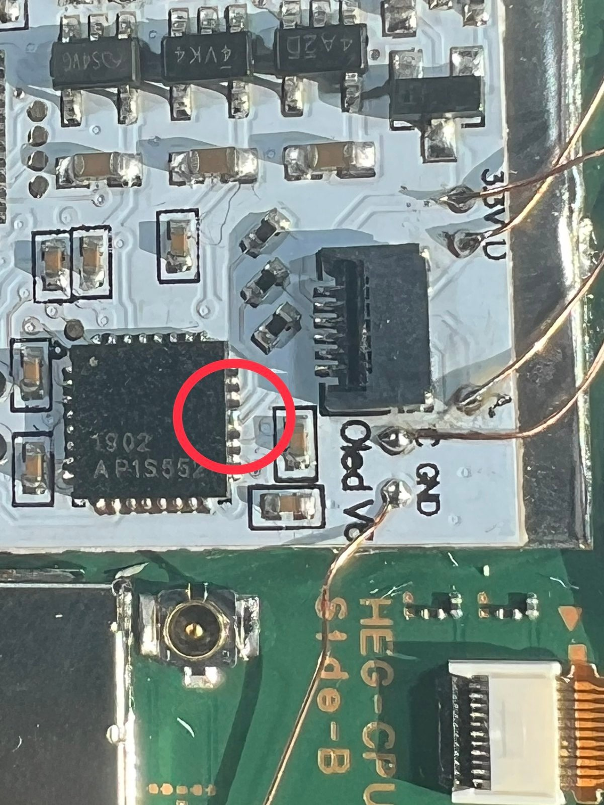

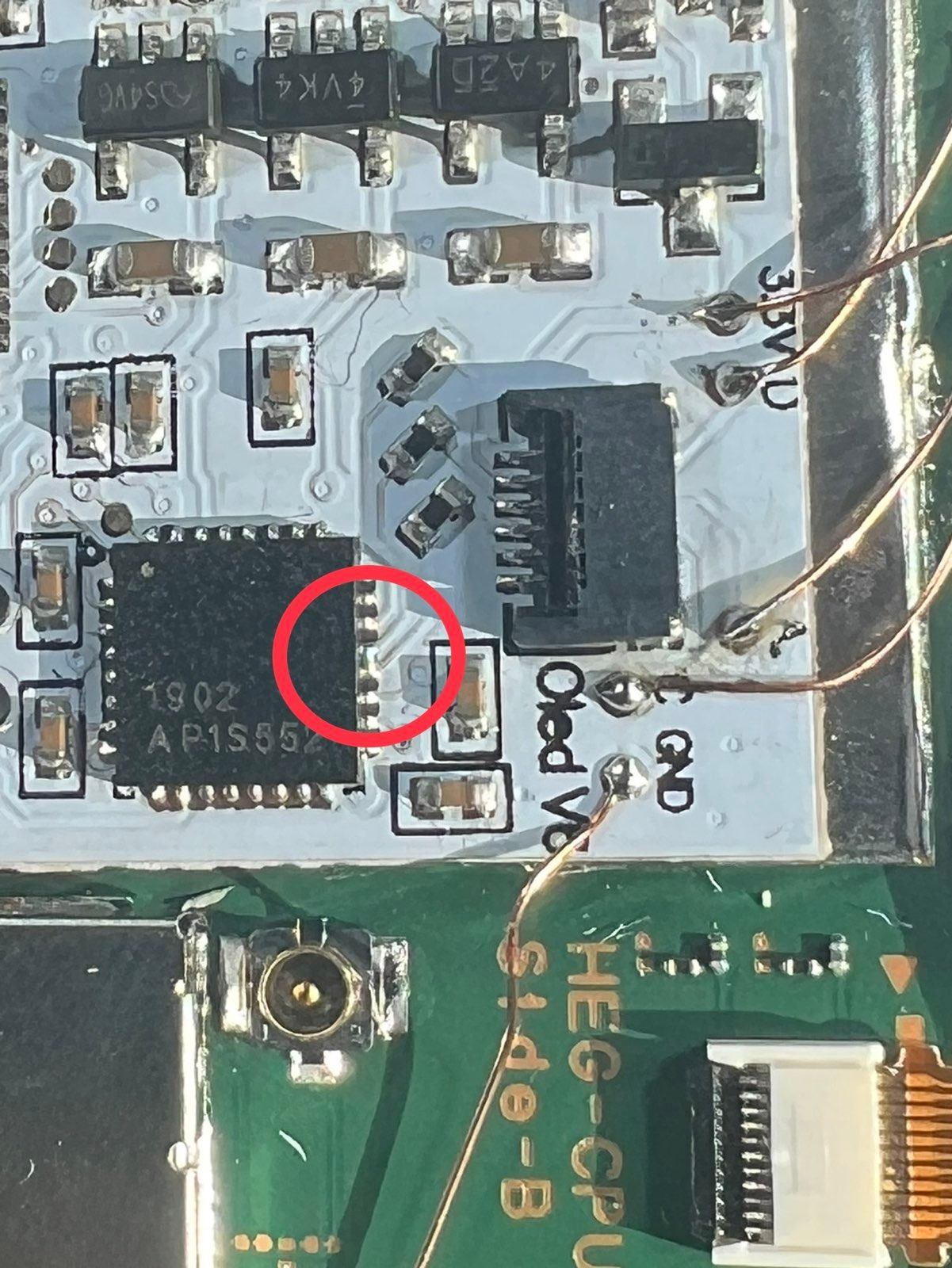

I sent two switches to an installer one with a HW chip and one with the instinct nx chip.
The guy has done many HW installs before but this was his first instinct nx.
Upon soldering the chip the device was a brick and wouldn't turn on. he desoldered everything to resolder it with wires (Thinking it could be the signal interference issue although discovered since that error exhibits different symptoms) and in the process noticed that two pins on the chip were bridged
TLDR If your device doesn't turn on after soldering the chip double-check the pins on the chip itself.
He said that the quality of the instinct nx chip was noticeably worse than any of the HWFLY chips he has done.

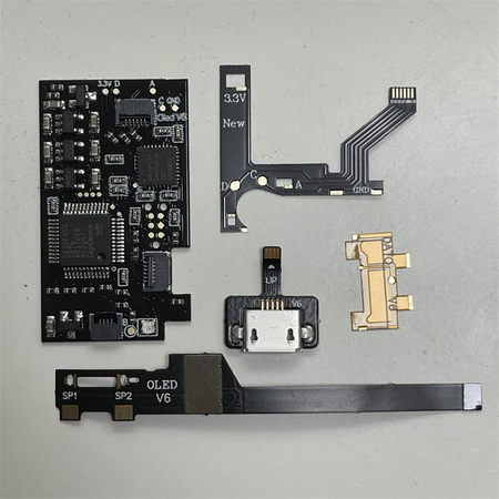

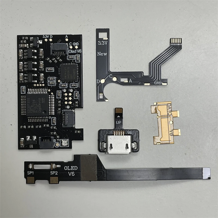

I just got this instinct v6 set from aliexpress for about 30 dollars.
I noticed the soldermask is black and not white.
Does anyone have a review for it?
Cheers.
Reactions: bergstyle

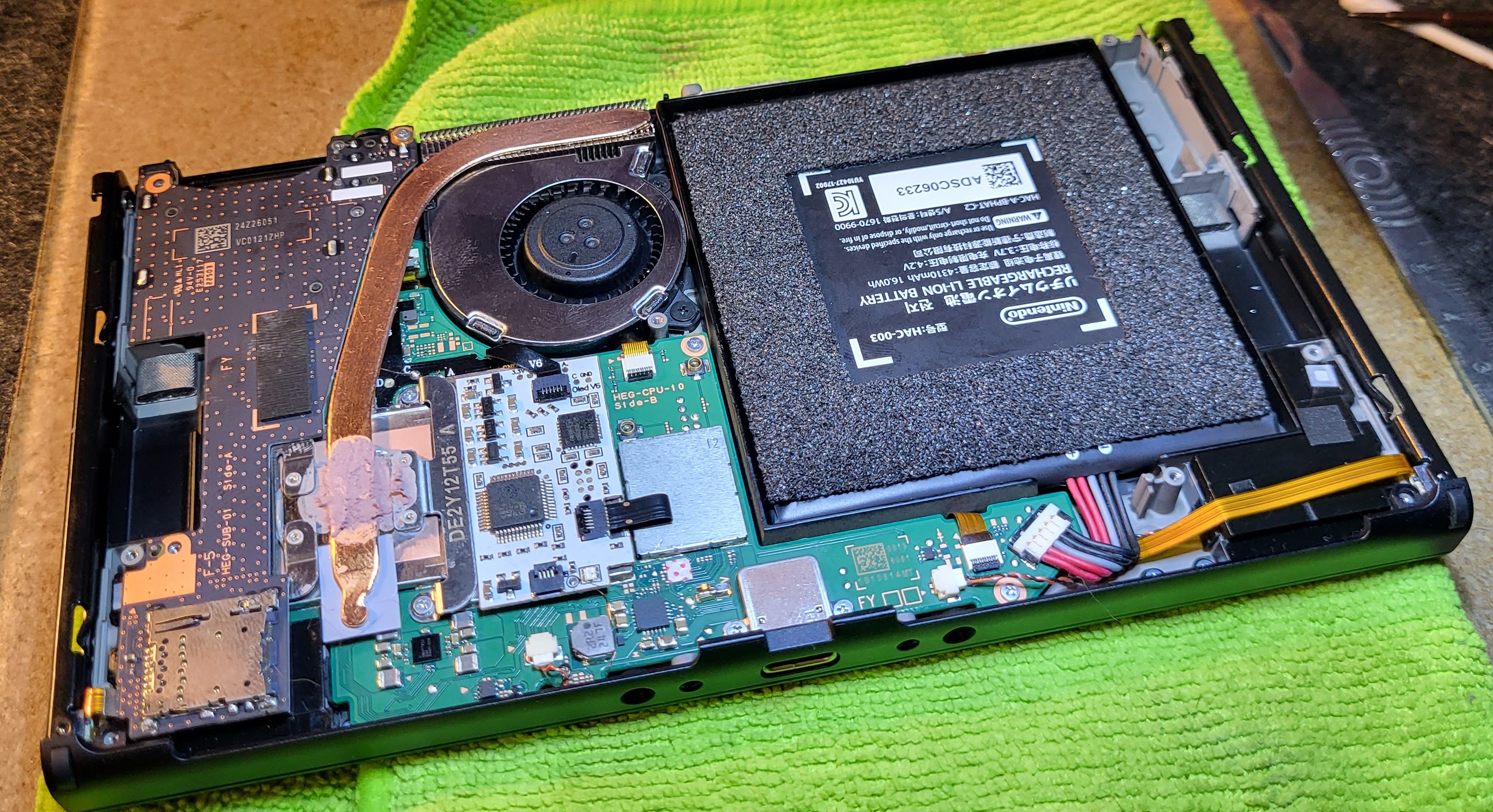

Nice work, which NAND brand you got on this new edition of Zelda?
SK hynix which I've read is unfortunate. I've created backups but fingers crossed it'll be ok

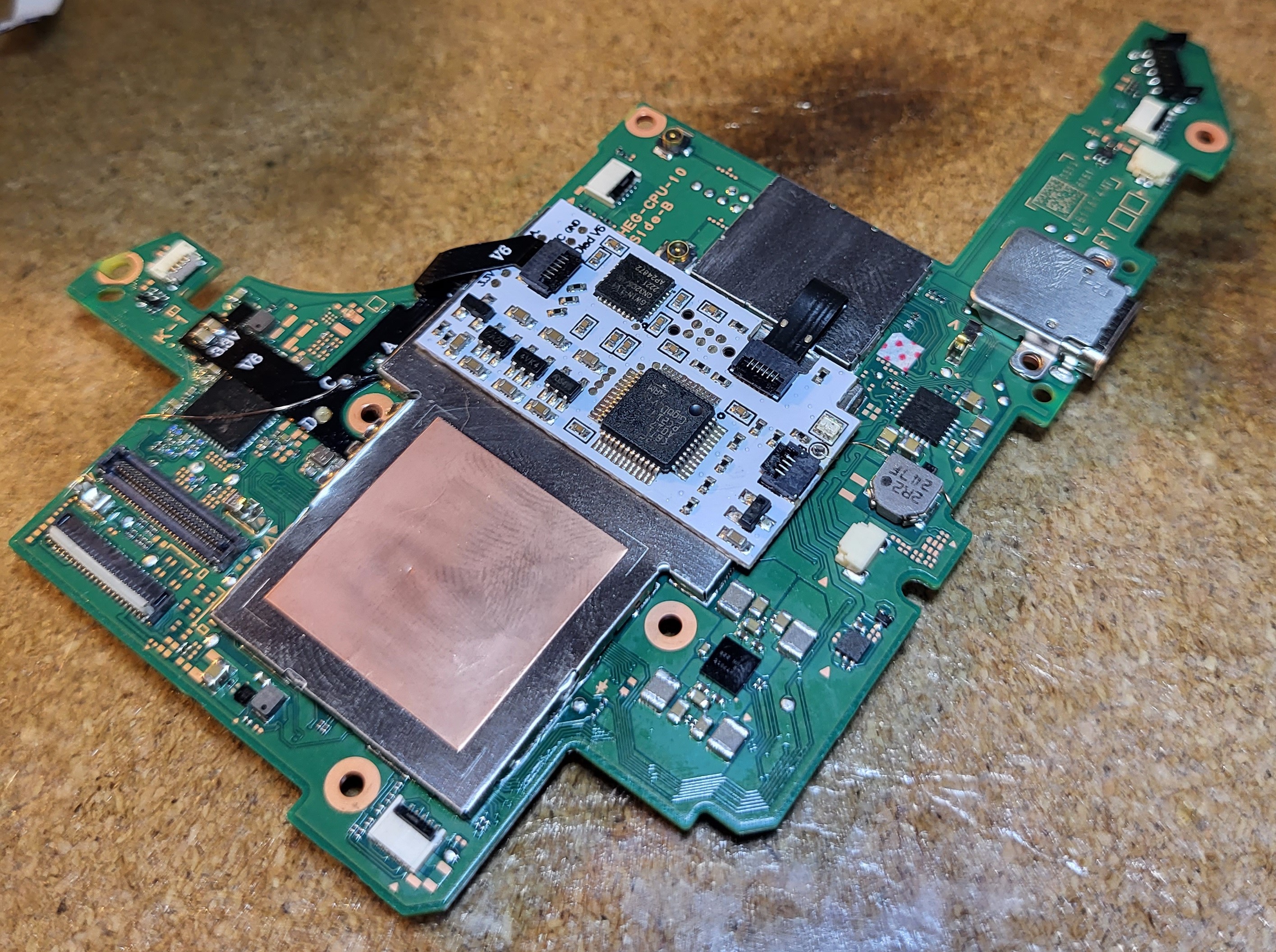

That looks very very good. Am iI correct by saying you only needed 2 flying wires? Which size have you used for them?
It's a very tidy install, I can't claim the credit though but I'll pass along the compliment.
Yes, just 2 wires, 0.1mm enamel coated magnat

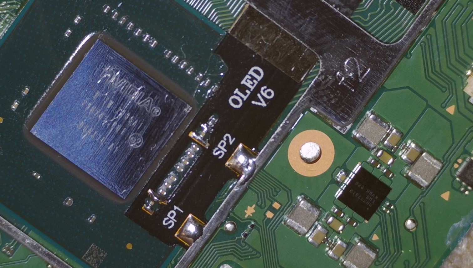

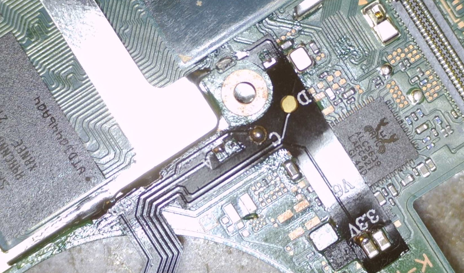

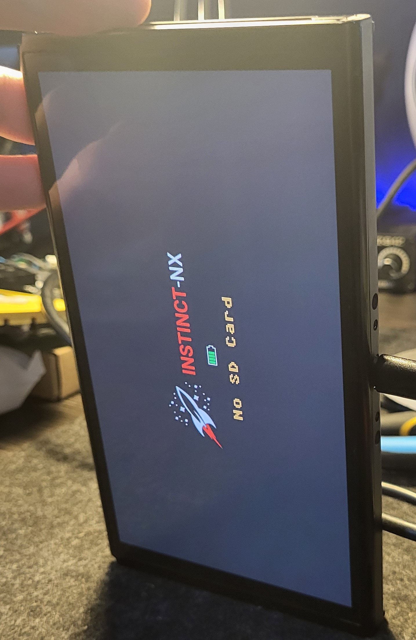

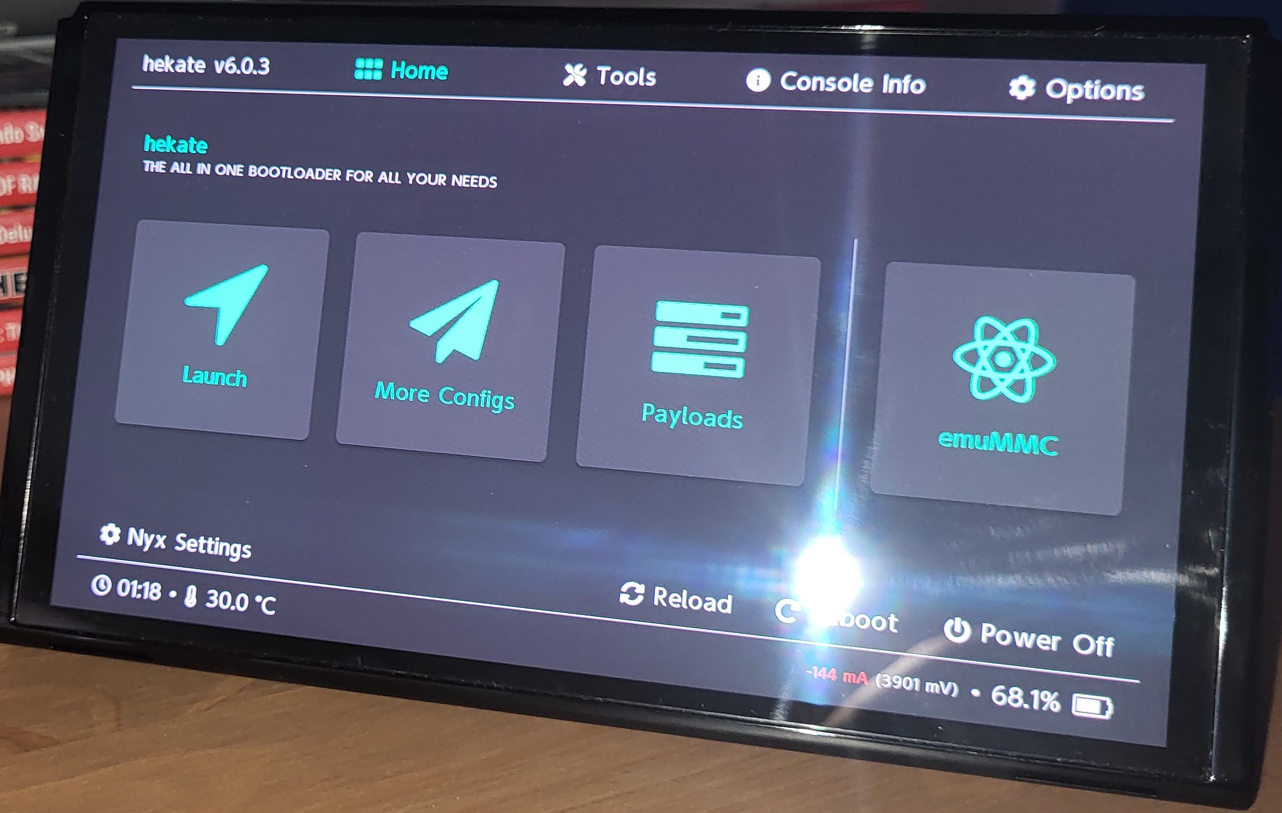

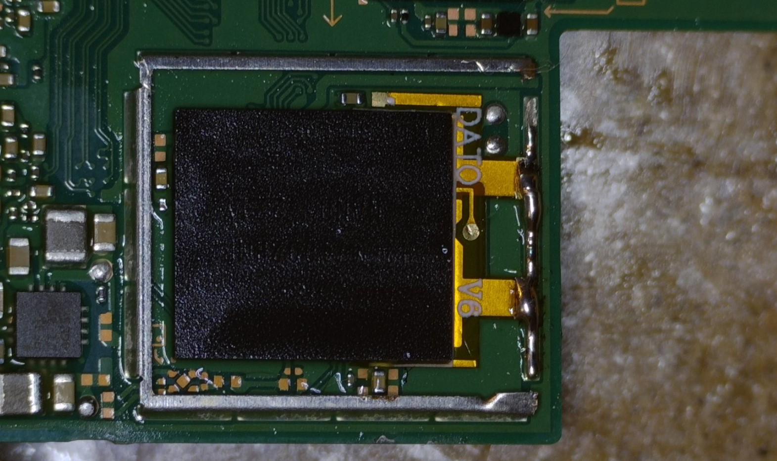

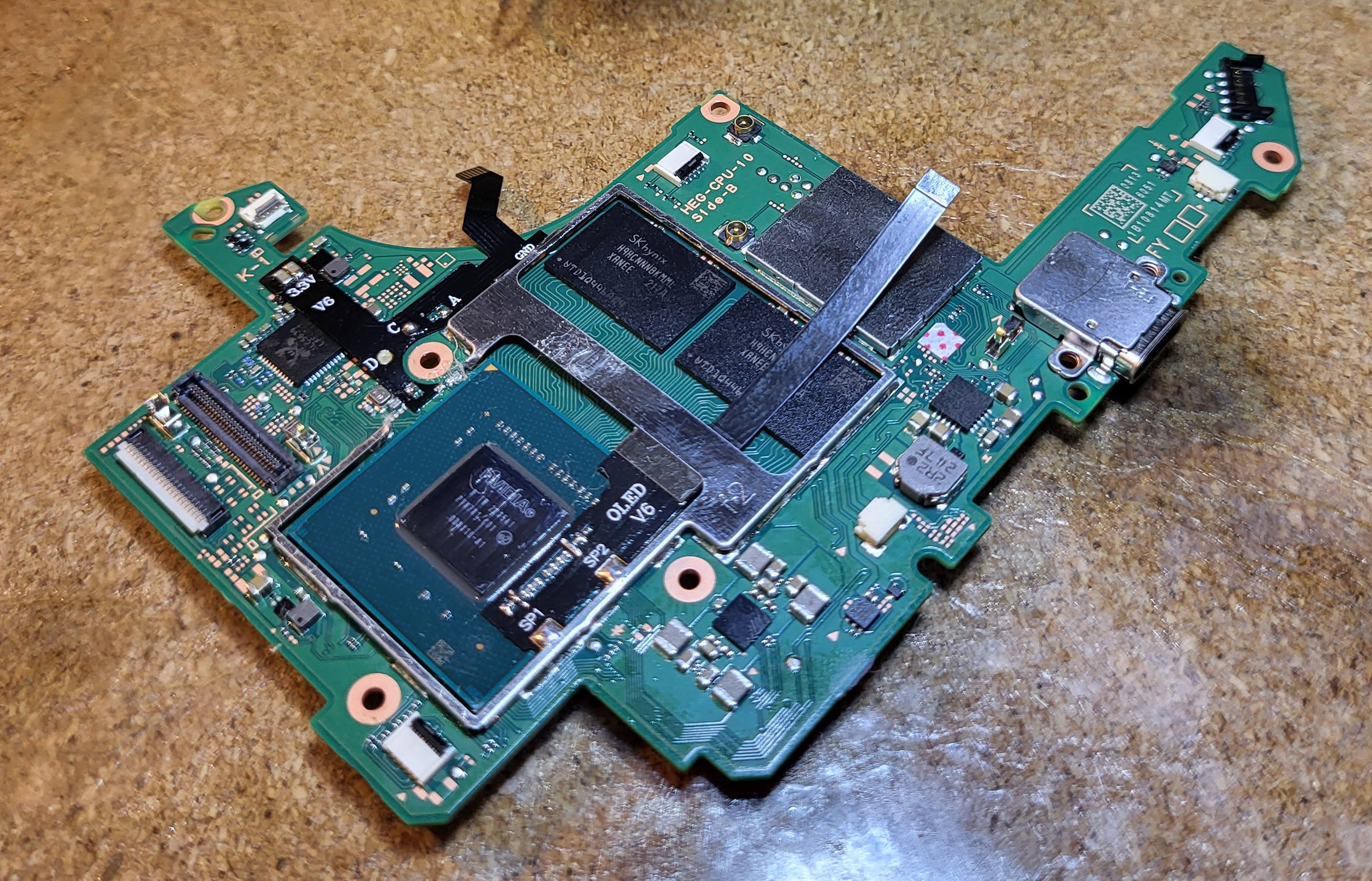

Well, I successfully installed the modchip. The findings are the same as most have already told in this topic. It has excellent compatibility, has a poor build, looks like an end-of-gen clone of hwfly, and so on. I had no problems with soldering or training the chip, everything seems to be done correctly.
A curious detail that seems to me to be a peculiarity of INSTINCT NX (although I haven't tested my SD for problems). Apparently he has problems with high capacity SD. I'm using a 512GB and experience variable booting times in heakate/emunand, ranging from "almost instantaneous" to "up to a two minute wait". It is formatted in FAT32. Sometimes it gives the uncomfortable impression that it is not working, but just wait for it to boot into atmosphere without problems.
Perhaps the only thing I would have done differently was to have used the flat that comes with the chip instead of installing the fly wire type, which are basically loose wires on the board. I followed the sthetix video, which despite being excellent content, gave me the impression that the installation that excluded the flat was more on a whim than out of necessity, despite him stating that the flat would be causing interference and errors in the console.
