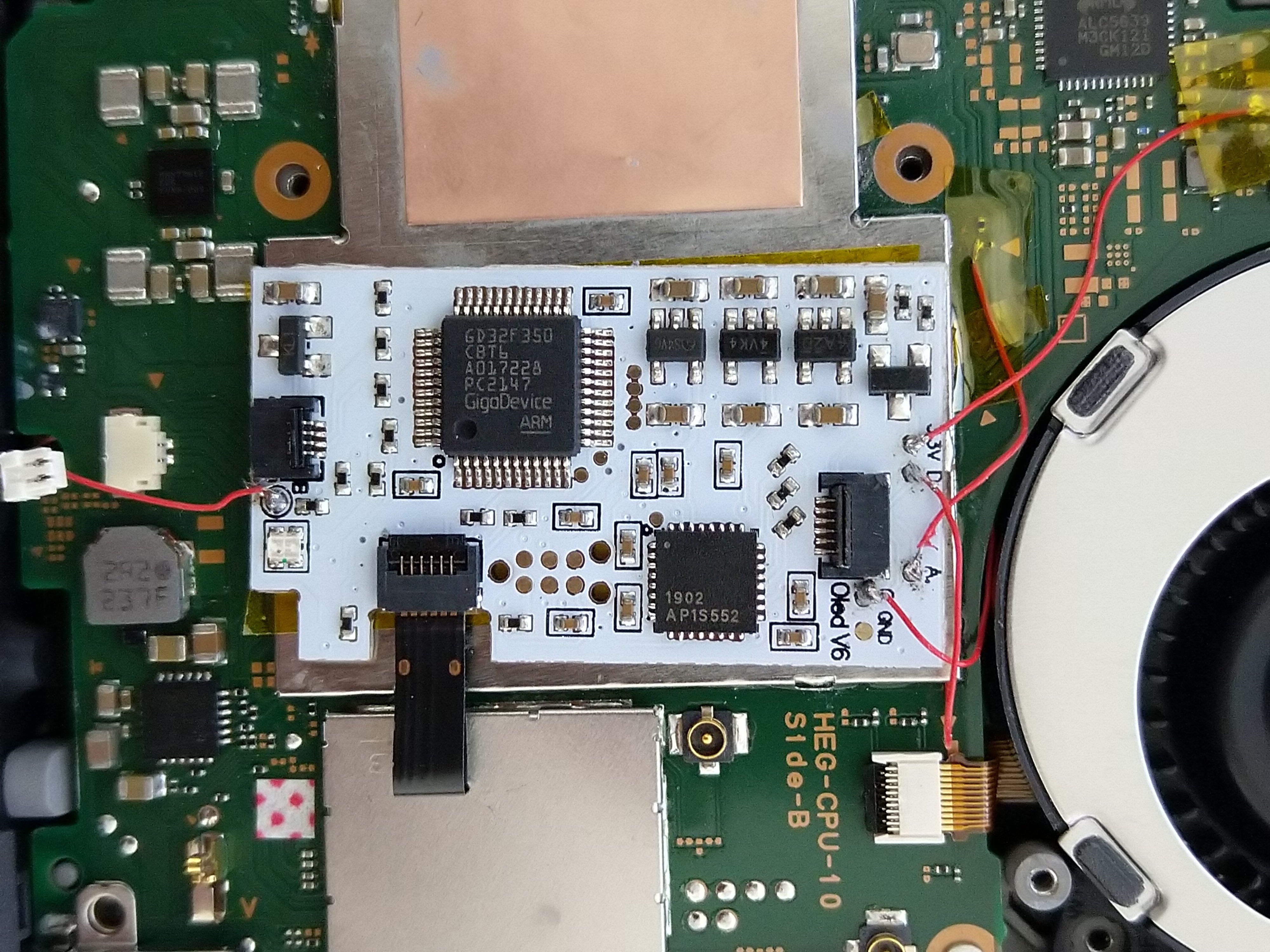

Just did an install of the white Instinct NX chip
Getting 8 red flashes at a time
Most of the points match the range
Except the CLK this is ~0.46v1 rather than 0.500v-0.900v range
And the B point does not seem to give any reading, even from the solder point itself
Late now, 2am, will check agaiin tomorrow
But just wanted to see if anyone has gotten the 8 red flashes error?
Is there a way to check for shorts to the solder mask on the white version?
Al;so, is there a way to check the CPU connections?
red flashes, nothing else? that indicates fpga error. can you post hq picture of modchip?
with usb + putty, option 'i' should print INSTINCT, if not its a bad chip. might be simple to fix, else just request replacement
Thanks for the reply
When taking photos, i noticed some solder on the big ARM chip.
Removed that and now it is giving another error
Red x 2, green x 2, then white flashes, and whining sound then shuts down
If I were you I'd disconnect the chip to see if the OFW would boot normally, if not you're probably screwed at this point.

If you have this issue you need to wire your connections because the fpcb you have is no good.
Do i just disconnect the connections and leave the cables on the switch mother board?
Also, do i need to desolder the CPU cables?
The error im getting now is just 8 or so red flashes, pause, 8 red flashes, etc
that's fpga error and has nothing to do with your install
i say it again: post a high quality pic of the modchip
ok ill post a pic of the install and chip
Sorry my phone does not have the best camera, took like 10 photos and this was the best.
:( I should of waited a bit before I disassembed the chip!
