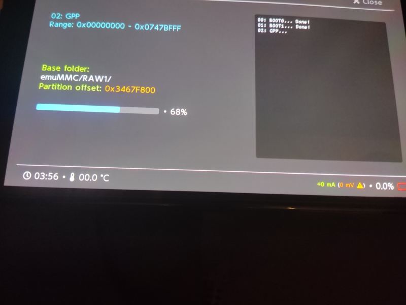

I've installed one of this modchip and now the batt le el is always 0%...
It's a new oled switch and it was working fine (I assume that).
Hekate lets me make the emu but I can't launch atmosphere...
Any ideas
Temp is zero too
Any ideas
Temp is zero too
hi mate I think we spoke about snes repros many years ago.
Issue here appears to have to do with i2c comms between various chips. inspect real thoroughly for solder leftovers near all ic's. I'll post a diagram for points to check/measure.
Any ideas
Temp is zero too
Battery fuel guage chip.

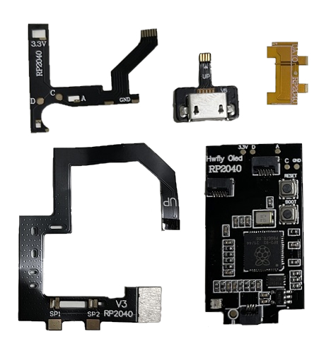

looks quite dumb to me: stupid tegra flex routing, modchip has no mosfet to disconnect switch 3v3 when usb power is present, and the boot/reset tactile buttons are pointless
I think the CPU flex ribbon is alright, far better than that straight one that adds unnecessary tension on the connections.
