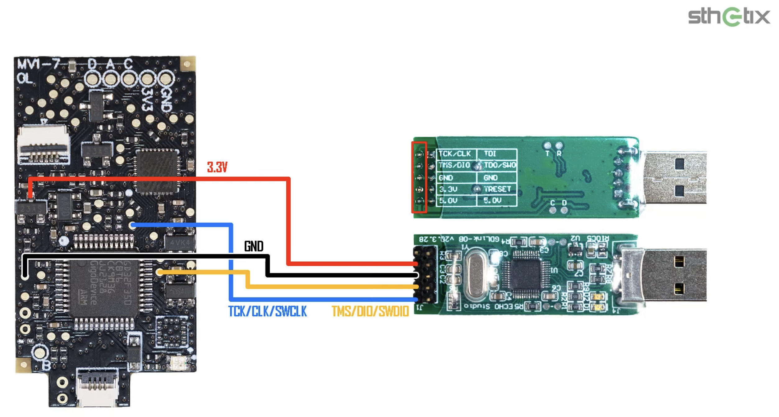

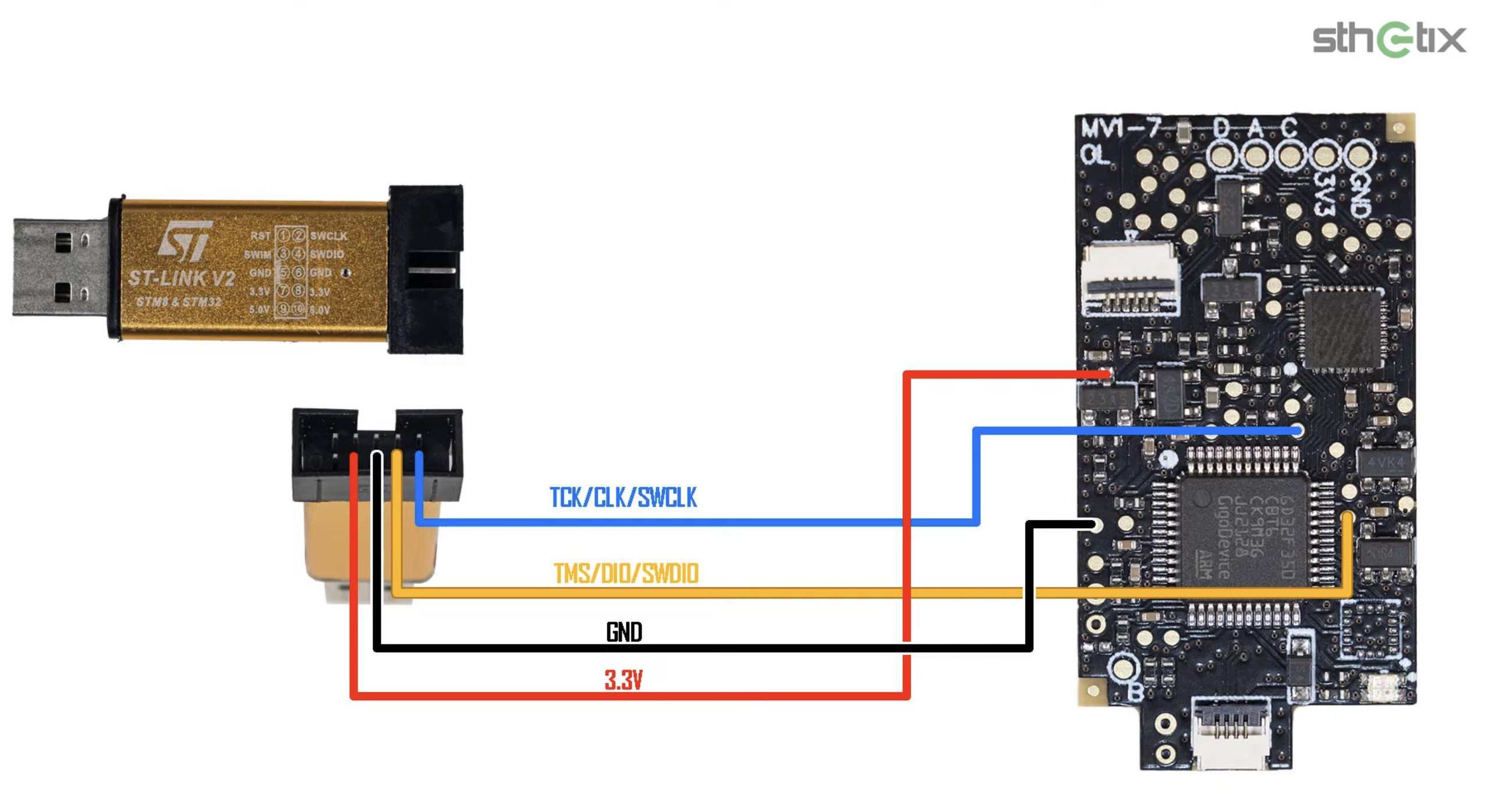

i change the flex but nothing happens ...... i solder the usb points on pcb but nothing happens . The chip is defective......
Are you planning to flash it via ST Link? I don't mind to try if the new flex doesn't fix my issue. But I cannot find an instruction on which points to solder wires to :unsure:
This might help:
pics in case the YouTube vid is taken down….

Unless you can get you USB working another way, it looks like it, yes, Another straightforward option is to send it back for a refund.

I am try to use st link if it works.....
