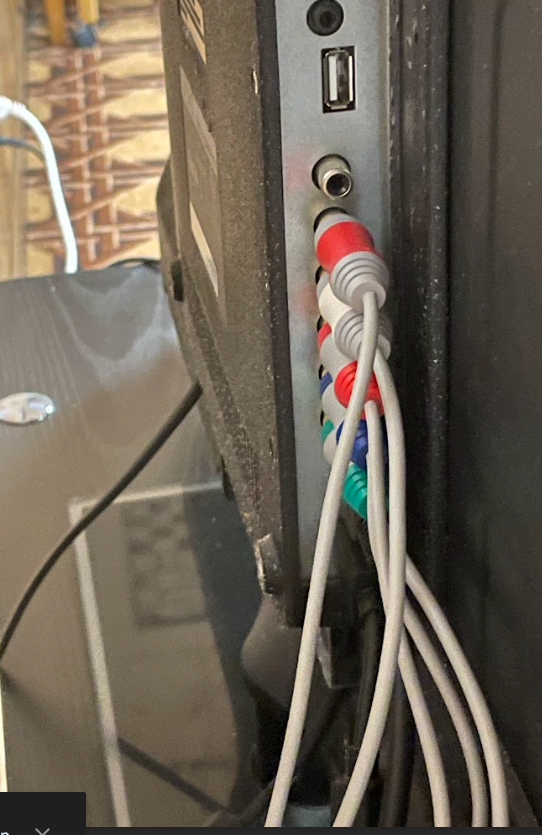

Hi,
I was feeling nostalgic, so I dug up my old wii in my basement. However, I can't figure out how to set up the AV cables and my parents have long forgotten how to setup the will. I attached a screenshot of how I set up the av cables, but the wii doesn't show up when I switch to the AV port. I only have the wii AV apparatus with 5 cables consisting of green, blue, white, and two reds. I entered the cables based on color and I believe the bottom two ports are for audio. Any help would be greatly appreciated.

Do you have input named "component" instead of "av" in your TV? You're right that the white/red pair is audio and the RGB is component video. If the colours correspond to inputs on your TV set, everything should be setup correctly.
Do you know what the black port if for? Are sure your tv actaully supports component video? It might be helpful to have a pic of the ports with nothing in them.
Here's trick you can try. Switch your tv to component video then try plugging the green pin into every port and see if you can get a black and white picture. That will help you figure out what ports to use. If none of them work then something is wrong.
If your tv doesn't actually have competent input you can try the same trick with the tv set to av, although you'll need to get actual composite cables to get colour.
You need to switch your Wii's input mode to component.

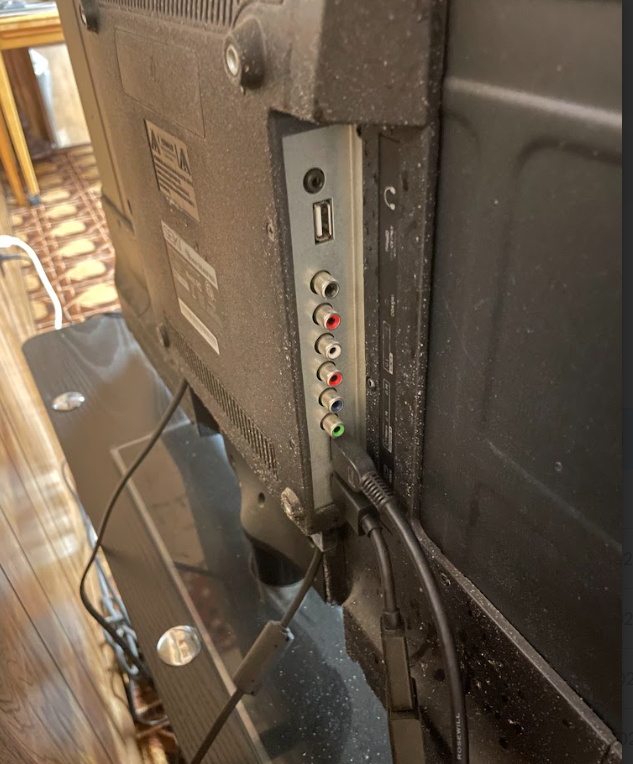

Here are the AV ports without the cables. Did I mess up the inputs? Also I can't figure out what the sixth black port is for. I'm attempting to set up the wii on an old seki tv, as that is what my family used when I was a kid. I don't think the wii would work on my modern roku tv because that tv only has 3 AV ports.

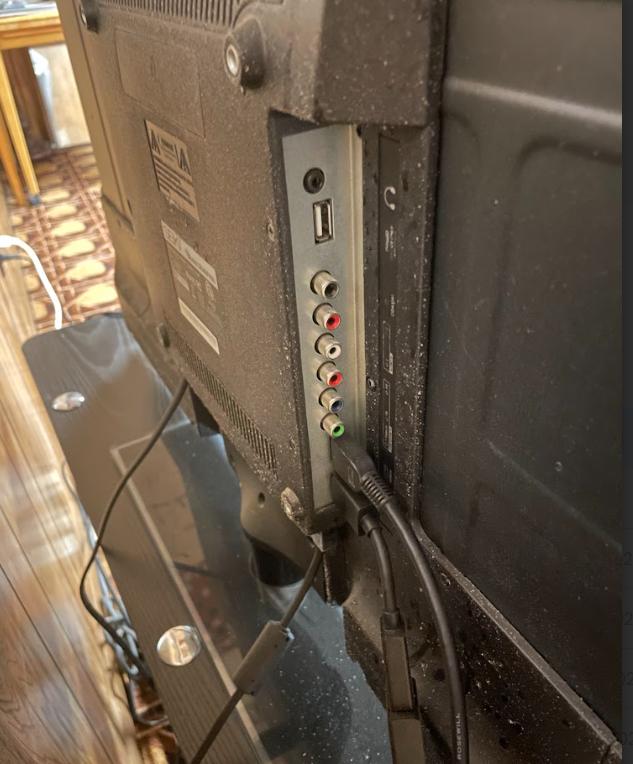

Judging by the setup, it's up from down.
Meaning the bottom ports are for component (video) and the two top ports are for audio.
Mysterious black port is probably for something very old - don't bother with it at all.
Find and read the instruction manual on the TV if you're curious.
It probably supports AV even with those inputs.
Your setup was right from start and I think I've explained the "mysterious" black port competently enough in my previous post...
Does your TV have input (when switching inputs from the remote) called component? If so, that's the one you need to select on your remote. The initial setup of your cable was correct and deductable from your initial message with some reading and basic understanding of TV video connections :)

Thanks, for the pic, you did indeed have it set up right. Also, you never mentioned if you could hear any audio or not?
Boot your console with the cable disconnected from it and plug it in 10 or so seconds later, this will force your (I assume American) console to 480i which is the lowest common denominator (so that it will work even if you accidentally set it to composite, as 480i Y is by definition black and white composite and viceversa)

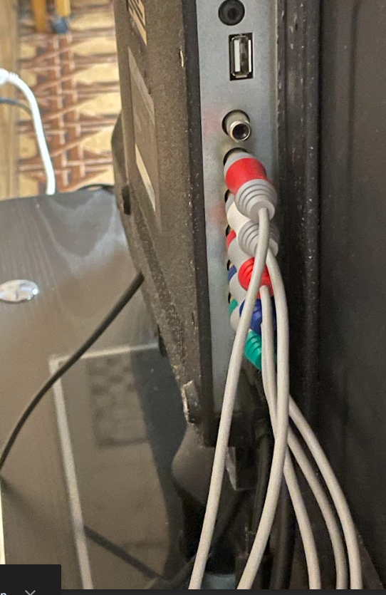

Hi,
That is component, not AV. Which is better! Set it up with Component on your TV.
