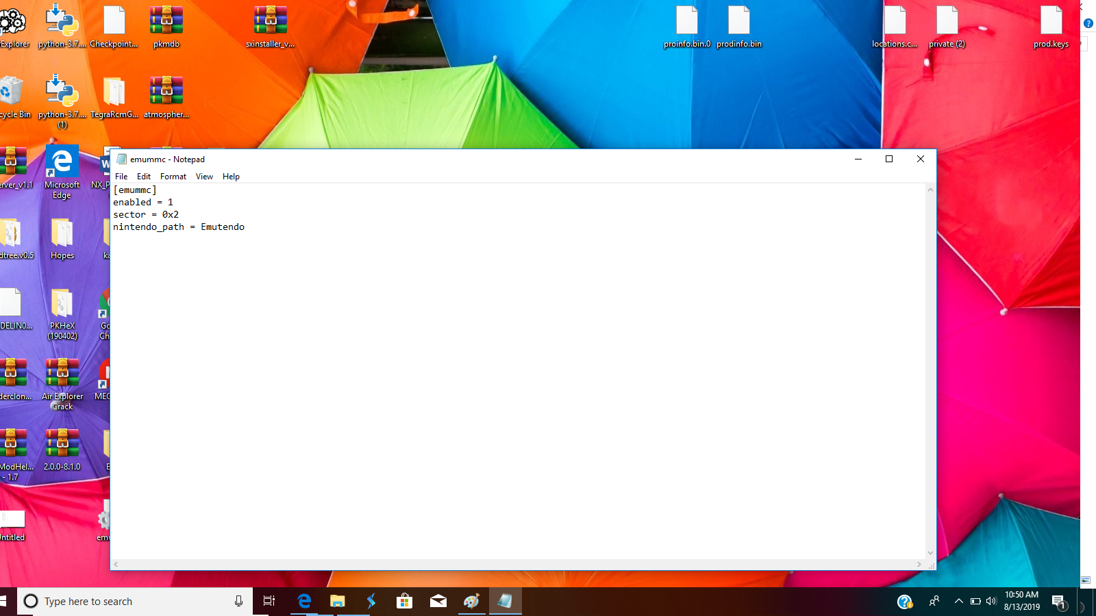

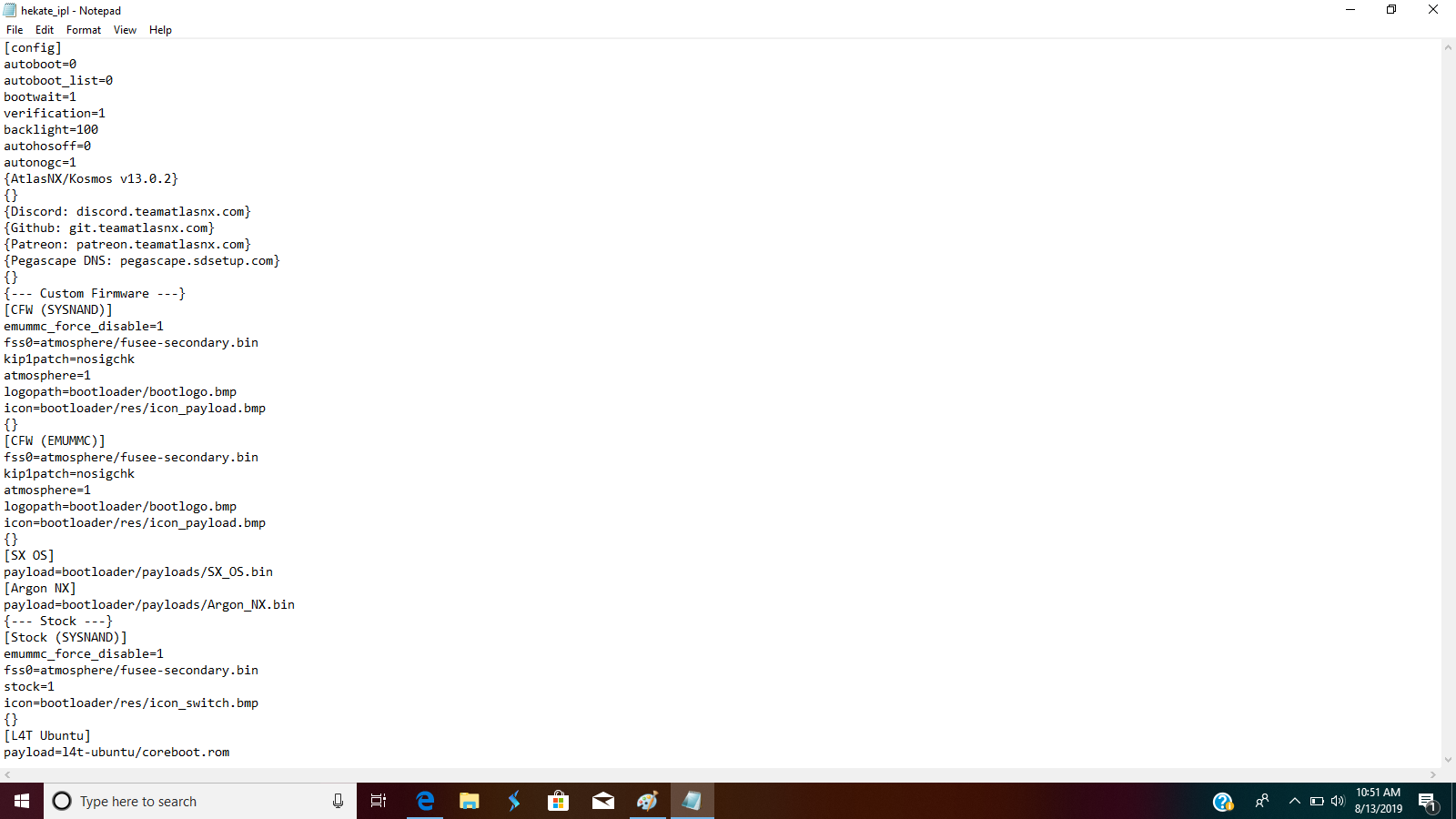

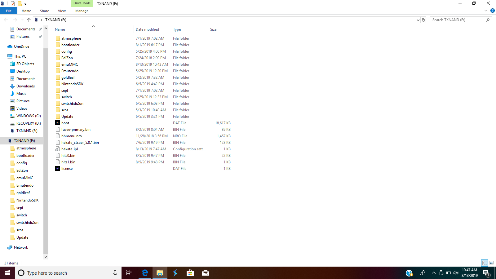

Ok Ill try that and correct I can boot into emmunand with sx fine but when I try to boot into emmuNAND with Atmos it just boots into regular Atmos without the E at the end
this is what I have and its still not working
https://i.imgur.com/HzEQ4cA_d.jpg?maxwidth=640&shape=thumb&fidelity=medium
Umm, are you sure that it's not the emuNAND? Never looked for that "E" at the end tbh.
Try changing the menu theme from black to white in SX emuNAND, then boot into Atmos emuNAND and see if it's white or black to be complete sure.
If you put the card in your PC, hit WINDOWS+R and enter diskmgmt.msc, what does it show you?
Should be 29.1 GB unallocated space and a FAT32 partition afterwards, correct?

Yes it does say 29.1 unallocated and when I changed the theme from black to white on sx emunand atmosphere also changed from black to white. I thought I read somewhere that you should see an E at the end for the emuMMC with atmos maybe its only when your using atmosphere emuMMC by itself
