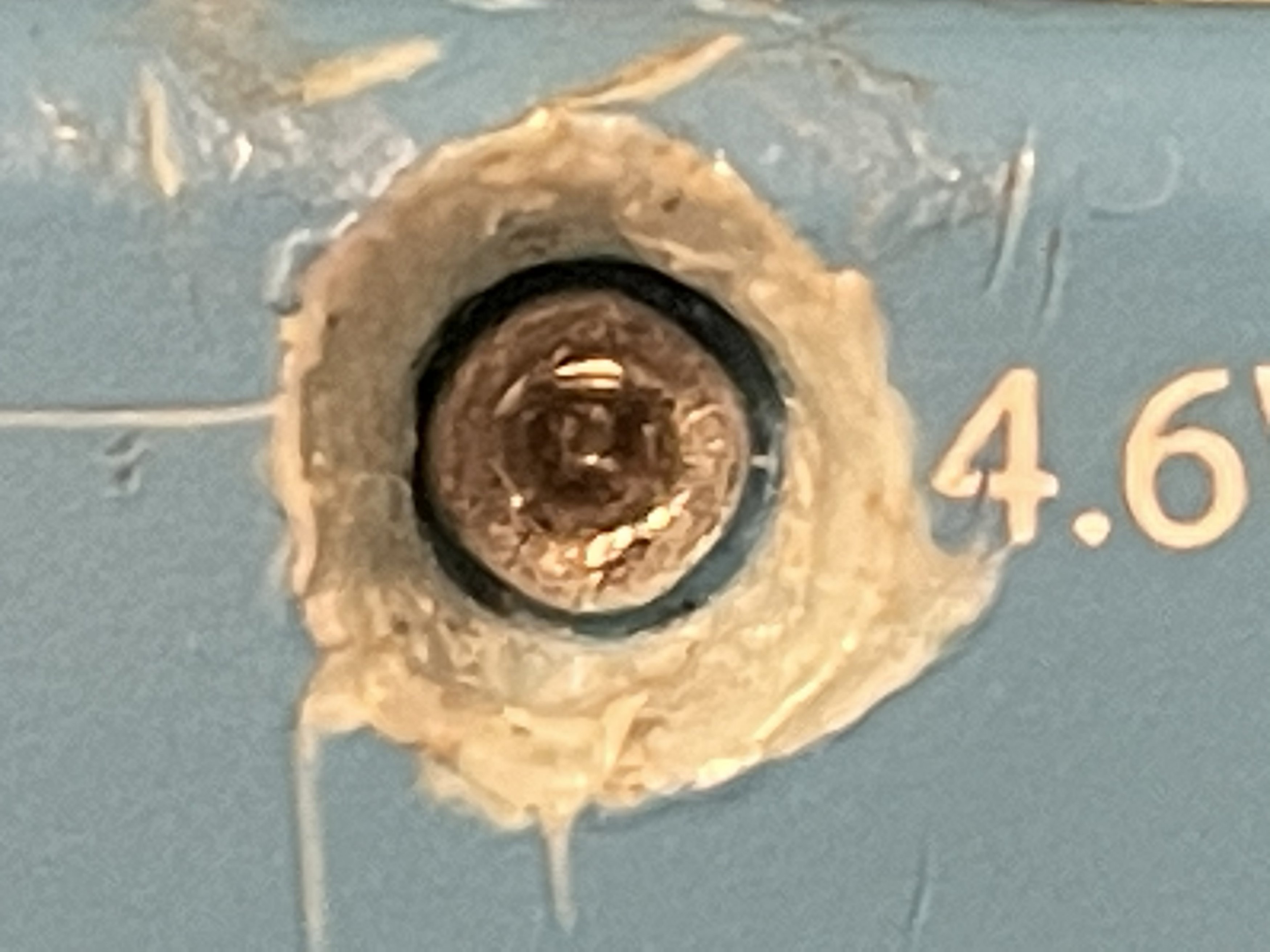

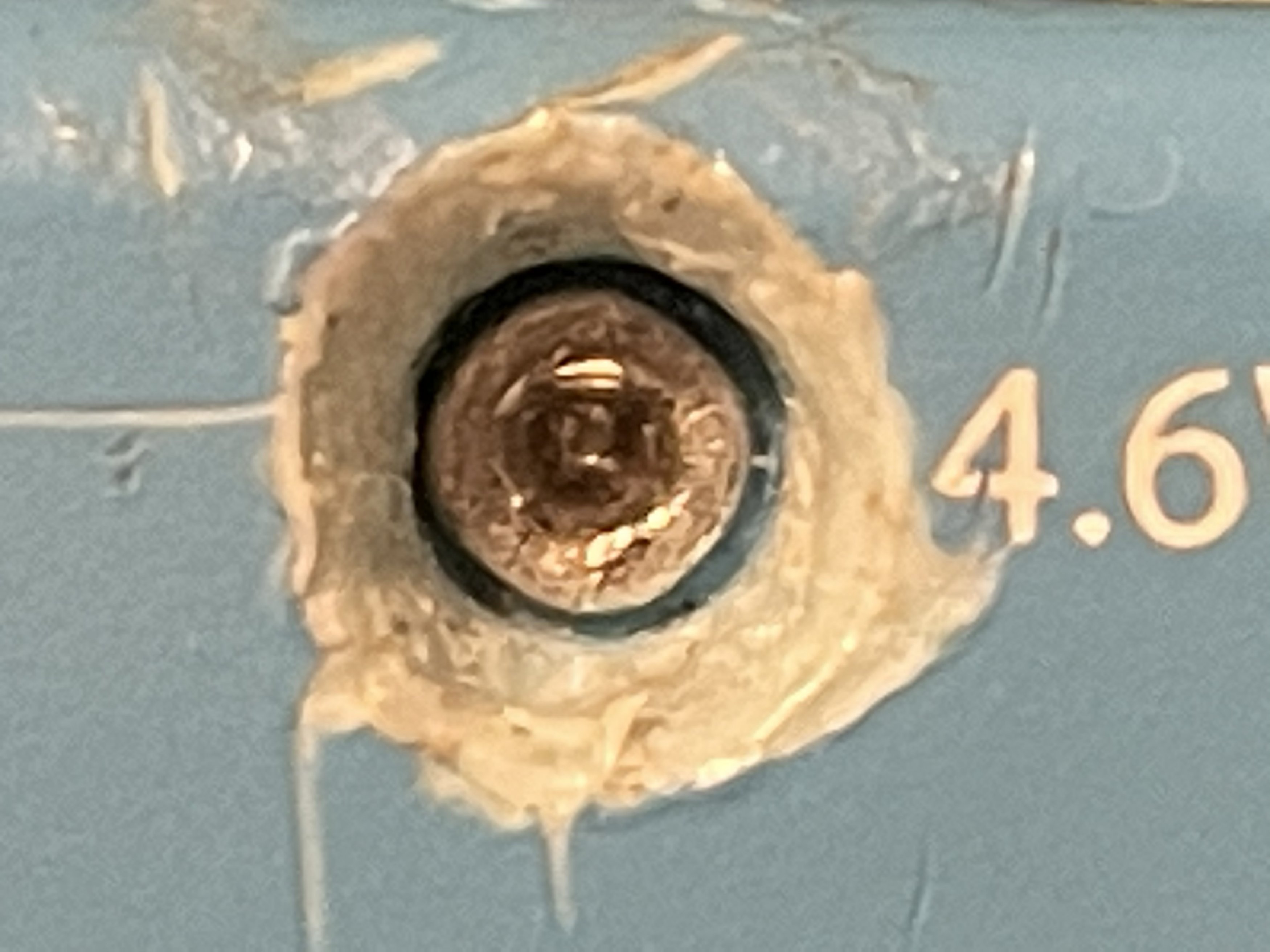

I just stripped a triwing screw in my brand new GBA shell (using the cheap triwing driver that came with it)
There's only a smooth round hole left, so rubber band, glue ext won't grib anything
How do you extract it after you drill?

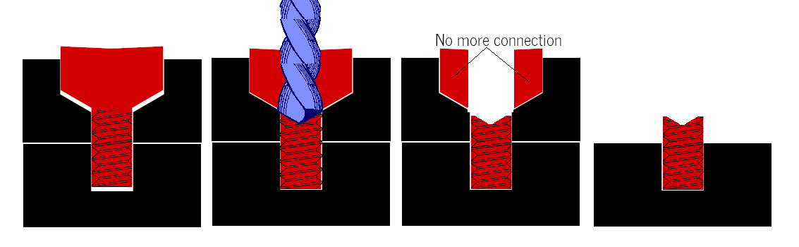

Depending upon the setup it will just slide off and leave a threaded rod at this point sticking out you can grip onto with pliers, or maybe something a bit more locking (see vice/vise grips, though don't buy any specially) and twist out.
The general idea of drilling for most things like this is so the screw now has a nice hollow cone for a head and you can't or won't mill a new slot or have anything gain any purchase in what is there and thus the drilling.
Most drills will have an angled trip and thus by drilling down just a bit of a way you will detach the remains of the head which is the only thing providing any force to clamp the shell in most plastic and metal screw inserts things* I have ever pulled apart.
*two thick metal plates might be both tapped holes but this is not that.
Diagram, forgive the crudeness but hopefully it illustrates
The bit where it says not attached is indeed not attached if you did it right and should just fall out if you turn it upside down or hook it with a pick. Most will drill just a tiny bit into the remaining plastic to be sure or because they can't do better but you might find it breaks sooner than that or can be broken (if you can get a shim between the halves of the case then you can force upwards) when it gets really thin.

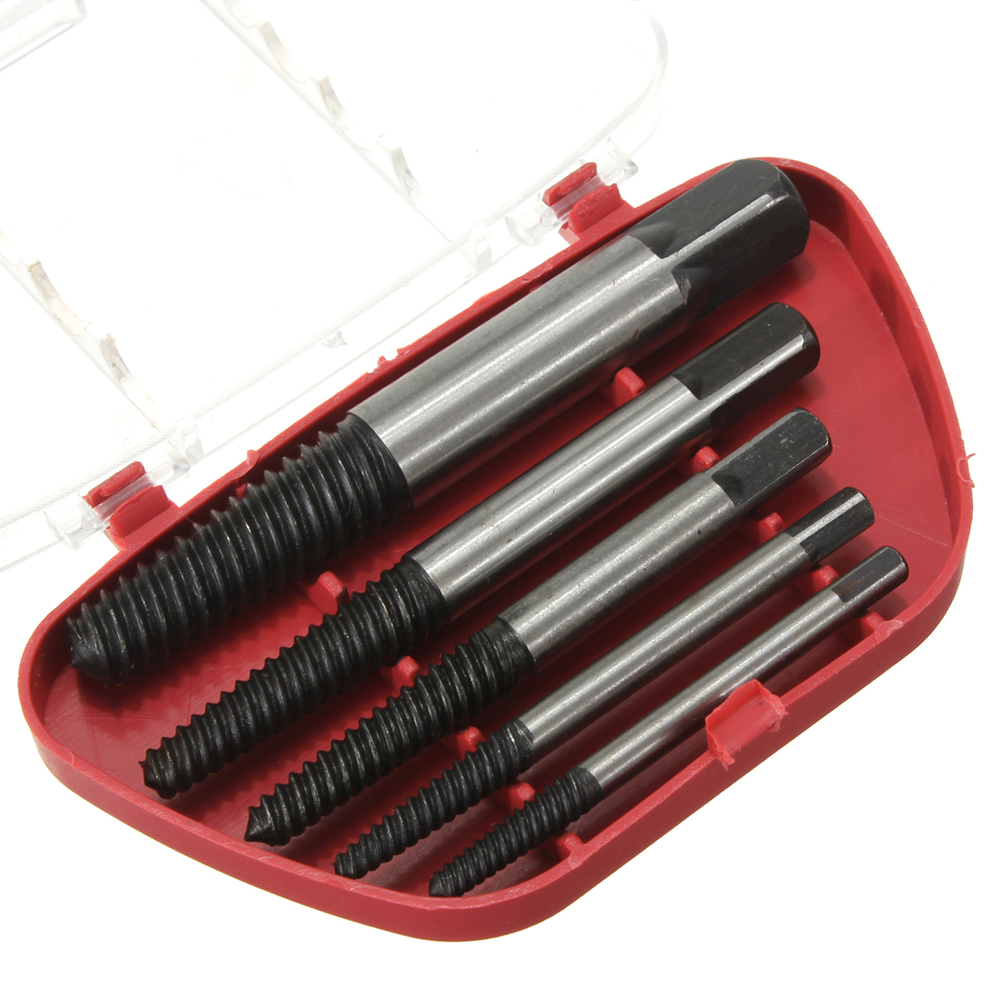

I just ordered a set of extraction bits which seem to be bits with a "reversed thread cutter" so it will cut into the hole in the head and make its own thread.
If this doesn't work then I'll try the drill press.

Extractor bit worked :)
Was a bit tricky to find the right size, and had to turn up torque on my screwdriver, but then it worked.
