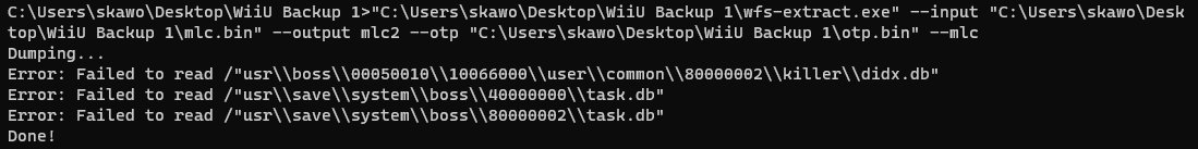

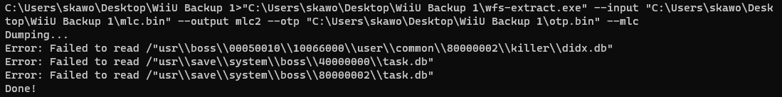

Hm, well. Dumped my (Hynix) NAND to SD.
5 retries, which, sad.
Extracting it, I get this
Which doesn't seem too bad?
Dumped again just to make sure with a similar result.
Can transfer these just fine with FTP.
5 retries sounds bad and it would worry me, but luckily it doesn't seem like files became corrupted. These files there are all db, so I assume they were just recently written and are still in the SLC cache. You can try to dump them through FTP to be totally sure, but I don't see a problem with the file system.
So maybe your eMMC has the problem and you are right on the Edge. Doing the NAND dump was probably a good thing, as it should have triggered the internal error correction of the eMMC and correct still correctable errors transparently.
But I would recommend you doing a second backup. If you have 5 retries, the dump might be more corrupt than it needs to be because of suboptimal error handling in the dumper (I am looking into fixing that). Also it would be interesting if you still get retrys.

I did do a second dump. The second dump also had 5 retries, but in a different spot. The same files were reported during extract. I can indeed extract those files fine with FTP.
