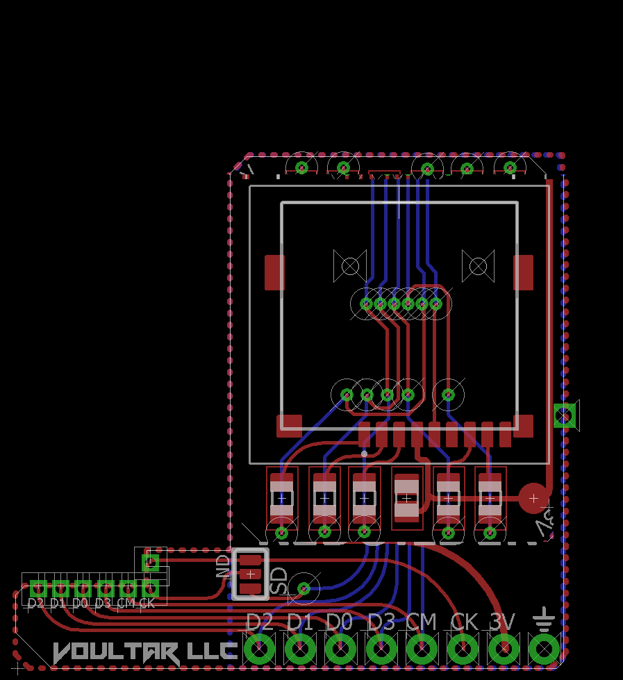

It's standard practice. You also want to debounce the SD-Card by putting a .1uF decoupling capacitor on the power rail, close as possible.
Aside from small tweaks. I'm done laying/routing this out. I've stuffed the current limiting resistors above the micro-sd port as well as the decoupling capacitor. There's a header at the very bottom that breaks out all of the signals so that you can easily read/write to the eNAND by either soldering to them or by using dupont connectors.
There's a jumper that you can short to choose between the onboard eMMC or "SD". This is useful if you want to put the stock eMMC eNAND back onto the bus.

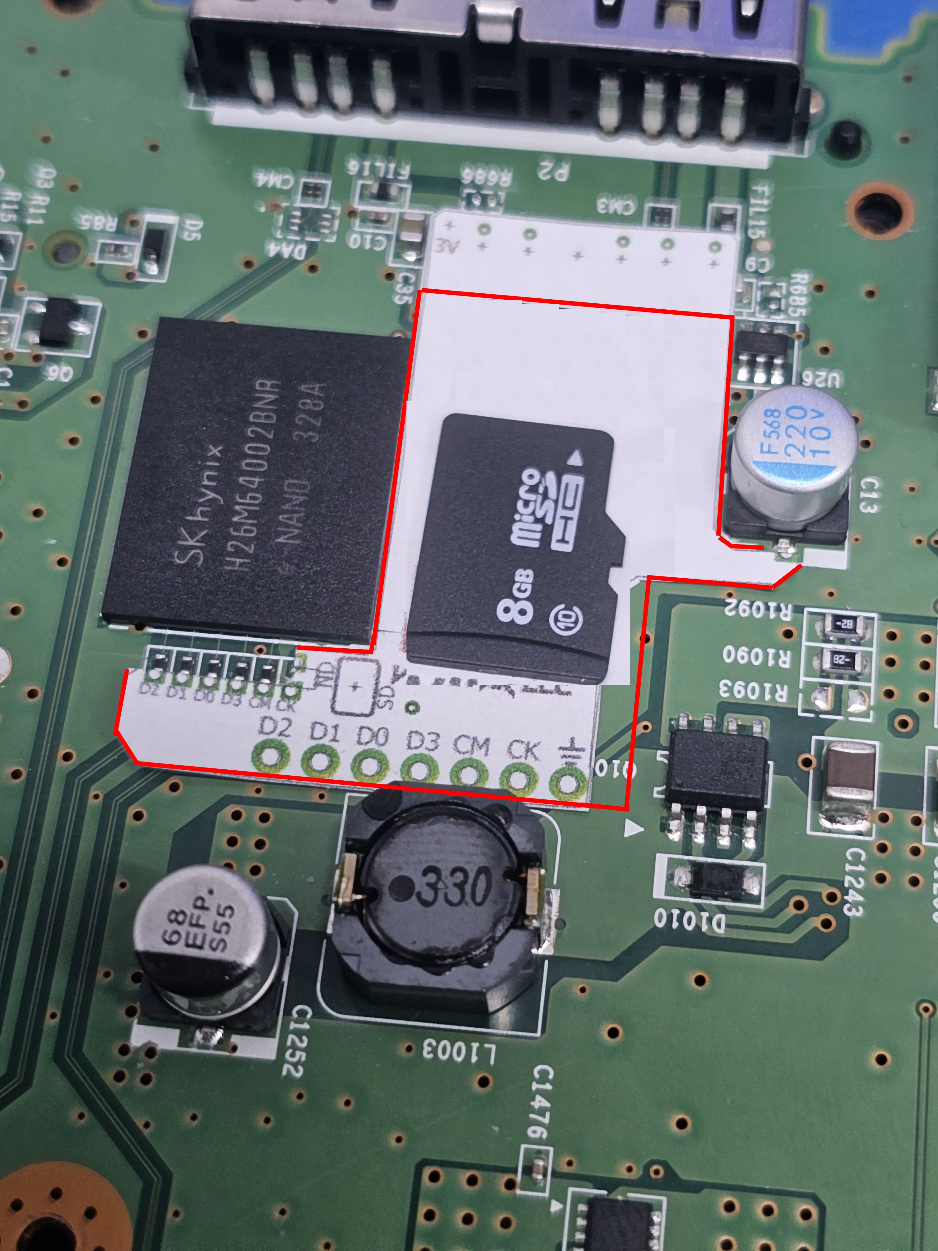

Here's a better preview to give everyone an idea of where it's going to live. I'll send off for a few copies and see how fitments works before releasing this into the wild for everyone to use.
Looks great. My only concern is that the jumper gives people the idea that they can just switch between SD and eMMC how they feel and mess up the SLC cache. Maybe it would make sense to put at least a warning on it.
Where will GND and 3V3 connect to?
What microSD slot will it use?
I think I will move my Wii U over to that as soon as it is available. Alone for adding the resistors it will be worth it. And obvoisly it's much cleaner.
I didn't have problems without the resistors yet, but I am attached to this specific console (also it's just borrowed) so I better not risk damaging the SoC I/Os.

Sorry to be the bearer of bad news, but I believe that capacitor is populated on some early Wii U consoles, although its actual designation is C655 (C617 is the designation for the much smaller capacitor next to it)
Would it be worth considering making it a flex PCB? so that the microSD card slot could sit directly over the original eMMC chip?
Or how feasible would it be to solder to the vias on the back of the motherboard, instead of directly to the resistors? (I dont know if they are tented vias?)
I would rather not have to remove a component, even if its not absolutely required.
My early Wii U (bought 2 days after launch also doesn't have C655) so I think Voultar is right there. Sadly this cap is on a 5V rail or else you would probably have gotten the 3V3 from there I assume.
In the worst case one could just remove the cap if someone has it.

OK, I'm trying to accommodate for every Wii-U revision that I don't know about, while making sure that the top RF shield can fit snuggly down and be put back together.
I've rerouted and reshaped this a little more. The castellated edges on the left grab the 4-bit data IO, clock, and command.
3V3 is the only wire, and it solders to Q6 (top left). The leg on the right with the castellated edge grabs a rigid ground from the electrolytic cap C13.
The breakout at the bottom is still there so one could easily I stall a header to read/dump the MLC, which I see as being critical to this design. The solder jumper must be handled with care. But I chose to make this a solder strap and NOT a switch because as SDSIO said, this shouldn't be messed with.
Would it not be possible to make the PCB a little shorter to clear U29 entirely? For example (And please forgive my terrible photo editing skills)
<EDIT> If the issue is clearance for inserting/removing the microSD card, would it fit better if the slot was rotated 180degrees? Something closer to the attached mockup, although obviously the traces would need rerouting,
Or alternatively there are 'flip top' micro SD slots which wouldn't require the extra space for insertion/removal.
